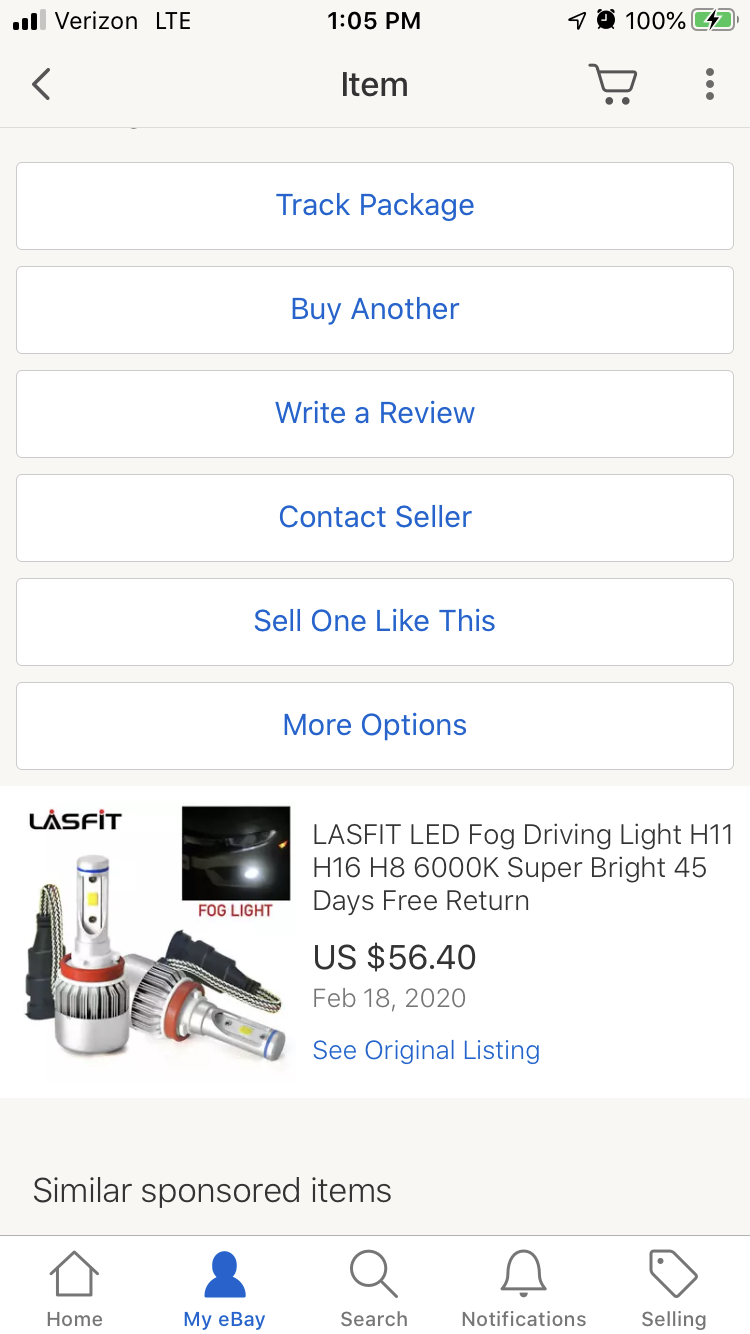

I have found success with a brand of aftermarket LED bulb from EBay
The pic is after the LED install. The Lasfit LED’s have thicker notches that hold the bulbs into the housing. Some of the aftermarket bulbs have the thin metal notches which I can see would make the seal less than tight and allow water to get into the lens housing. I have had these bulbs installed for about three weeks. Rain and carwashes later and No condensation. All you have to do is make sure the bulb is seated in the housing. If the bulb isn’t pointed straight then It is NOT seated properly and you MUST correct that problem to get a tight seal.

Fog light condensation
Whelp, I spoke too soon. About a year later, after a car wash, I now have condensation in BOTH fog light housings. I will put the factory bulbs back in with hopes of the moisture drying out. I hadn’t touched the bulbs and don’t understand why all of a sudden did I get condensation in them.
