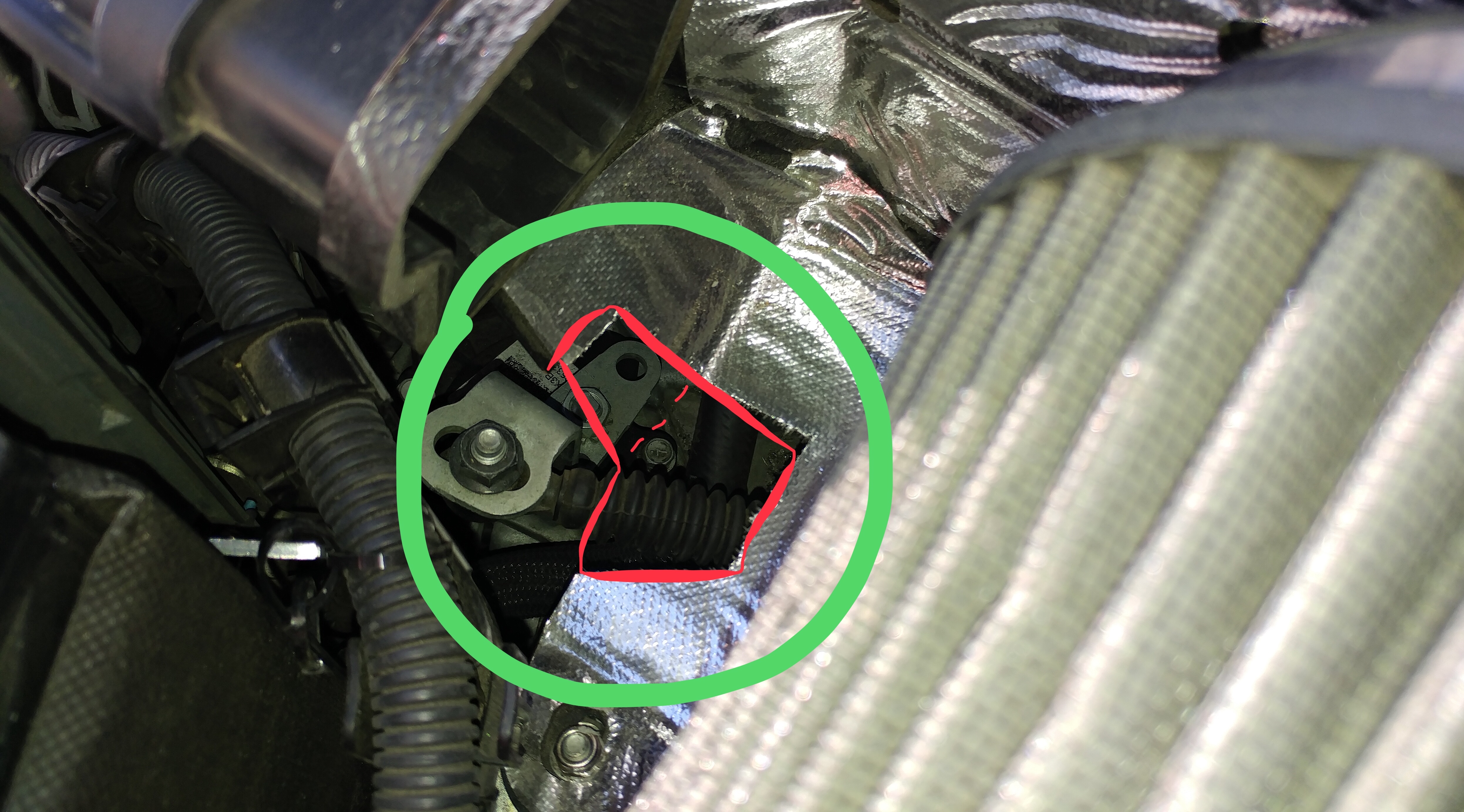

i did not go for the typhoon.
i went for a non-branded, ebay, “typhoon” look-a-like.
their “heat shield” does interfere with the shifter linkage.
so i cut out the corner of it.
SRI sucks in traffic.
intake temp reaches 140 and above, while it is 68F outside.
maybe because it is made of metal...

When you say "their" do you mean K&N or yours? Can you take a pic?

just saw this...
i meant “their” as the copy of typhoon.
before the cutting, it cannot go to drive.
hard lesson to larn after i backed out of my driveway...
haven’t got to take the pick since it has been raining here when i have the time to. hopefully, i can show it soon.
update:
the cut i had to make to make it work
