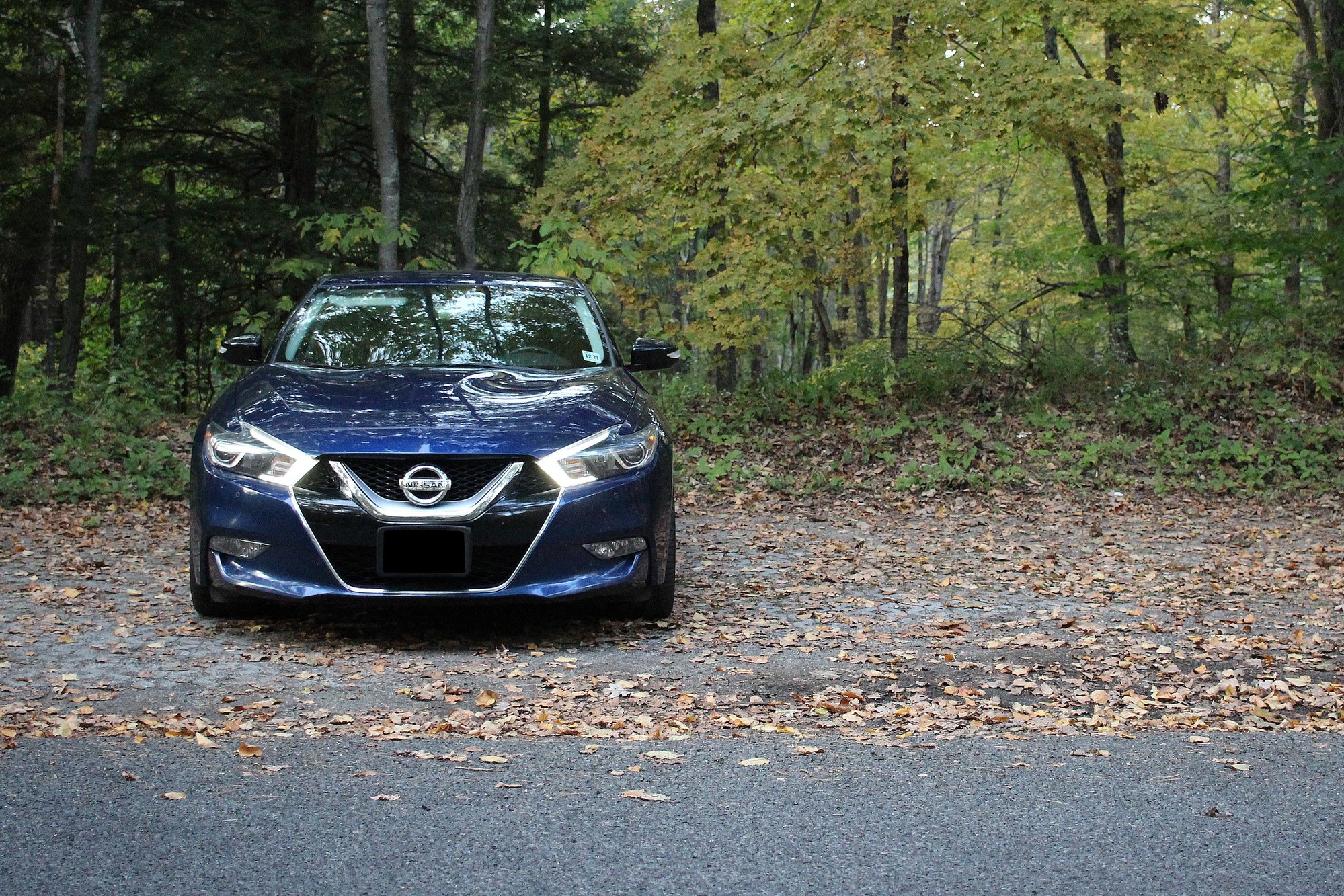

So I installed the 15mm Garage Line Wheel Spacers. They feel and look great! As you can see below, the rims are aligned with the fender while the tread is within the wheel-well.
They do not usually rub the inner wheel-well BUT if the wheel is turned completely AND one of the front wheels are up on a bump, it may rub a little. That said, I have not had that issue at high speeds.
