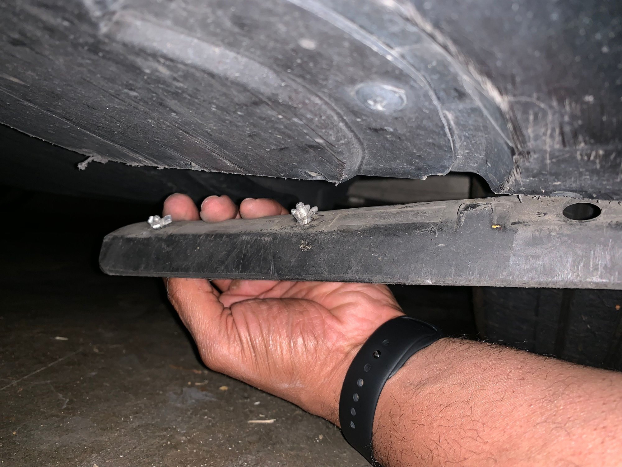

Any one know what this piece is called....doggone curb...just wasn’t paying attention and got to close...when I pulled back this piece was hanging!🤬🤬

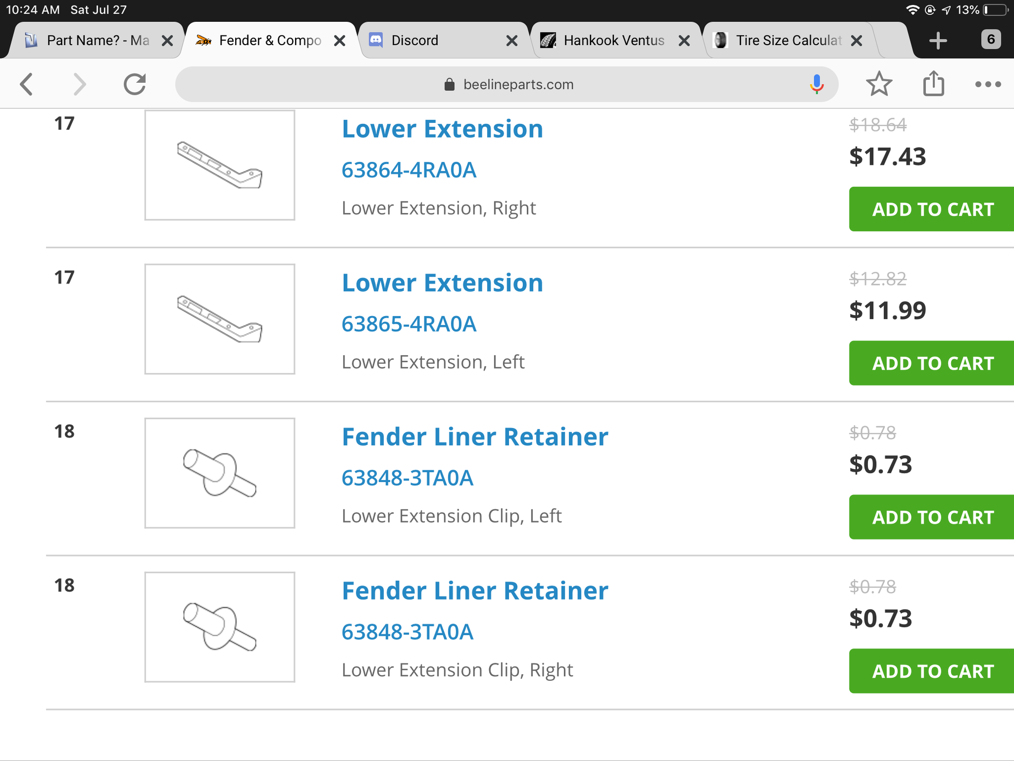

Just cut the rivets and put new ones in there and washers on the other side. There’s 2 or 3 rivets and 2 clip that hold it there.

Thanks for the reply!!!
