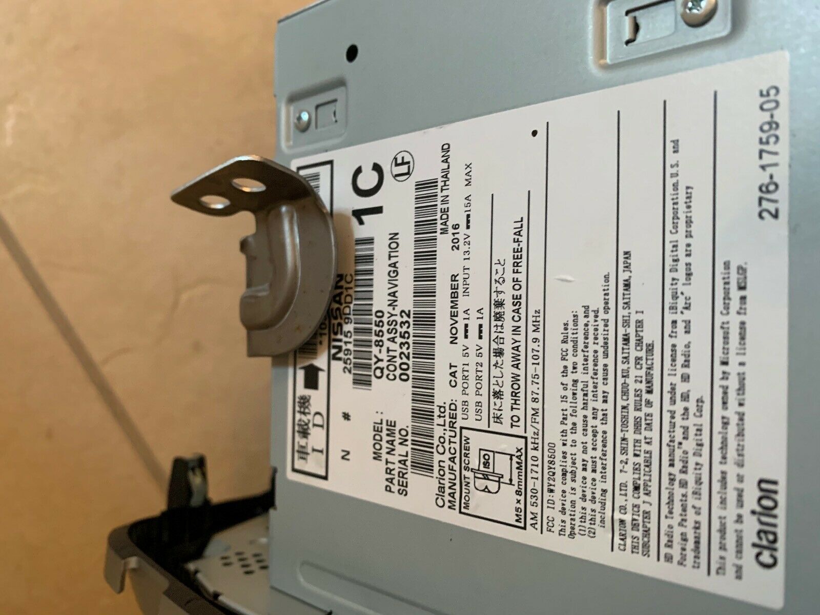

I have a 2016 maxima SR and im going to buy a radio part # 25915-9DD1B which comes with a 2017 models and up, not mine, the guy is telling me he bought a new sd card for the radio and was programmed for his his radio with his vin#,

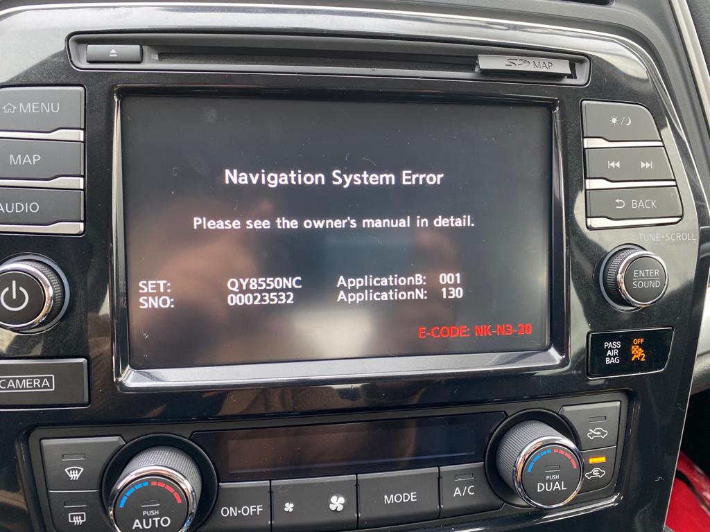

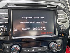

I bought a 2017 radio and it came with an sd card but when I installed, it gave me a black screen, see attached
That screen means that the sd card is not compatible with your radio. I got the same black screen when I put my old sd card in the new radio.
