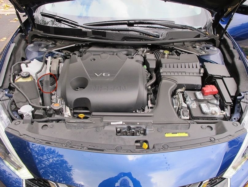

Yea, I’ve had that smell on my 17. You need to fill exactly to the line on the reservoir. Otherwise it will escape from the top. I believe there’s some sort of auxiliary whole on top of the tank. It will leak on this tubular thing(see pic) with rubber top( I’m not sure what it is but it’s a part of the engine and it gets hot) . Once coolant gets there it will evaporate making your interior smell unpleasant. And also the interior intake for your AC is on right side so it some how gets through the hook insulation( Insulation is pretty bad you can check for rust spots along engine bay on the body)
