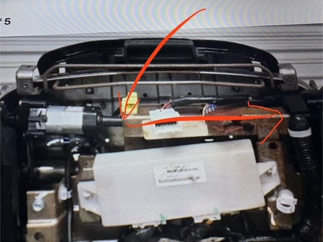

I had the same issue on my 2016 Maxima. I took the seat and tracks apart. Nothing was stuck. I put the seat back in. Forward and back did not work still. You can hear the motor clicking but nothing. There is a cable like a bike cable that runs from the motor to the other side of the seat. That cable seems oversize. I grabbed that cable and jiggled it while hitting the button and it started working. In the cable is a short square shaped shaft on both ends. The shaft sometimes disengages the mechanism that drives the track. Once you jiggle it the shaft pops back in and begins working. Try that before taking the seat apart. It worked for me. Good luck all.
We are having the same issue. It's not heat related...and this case the seat is stuck as far away from the steering wheel. Will try your 'jiggle' suggestion. Curious...how long ago did you fix your issue with this method and is it still working properly? Or something we might have to do periodically?

Just fixed it yesterday. Find the motor (front right corner next to the center console). There is a cable attached that goes to the opposite end to power the other track. You will have to feel for it but easy to do so. Jiggle on it close to the other side as you are pressing on the button. The shaft will then engage the mechanism and start working. Let us know if this works for you. The problem is in that cable. It is almost impossible for a coin to get stuck in those tracks. The cable runs behind the metal shaft.
