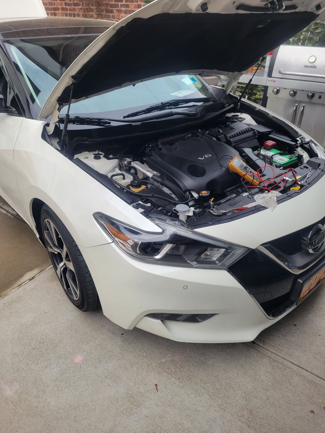

Hey guys so today i was driving and noticed my battery light was lit on the dashboard. Nothing else was on and no performance or anything was lost. Can it be an alternator problem? Car is a 2016 Nissan maxima platinum with 23k miles. Still kinda new for the alternator crapping out. I didnt get a chance to troubleshoot yet, just wanted some info on the potential faults it can be. Thank you in advance...

Thank you guys again for the help. It ended up being a bad alternator. What a nightmare it was to change it but it got done. Had to drain the coolant. Then drained the freon because the low pressure hose was in the way.
