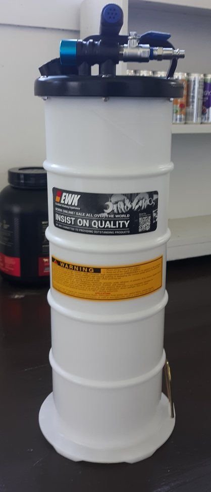

Try one of these! Leave that drain plug alone!
