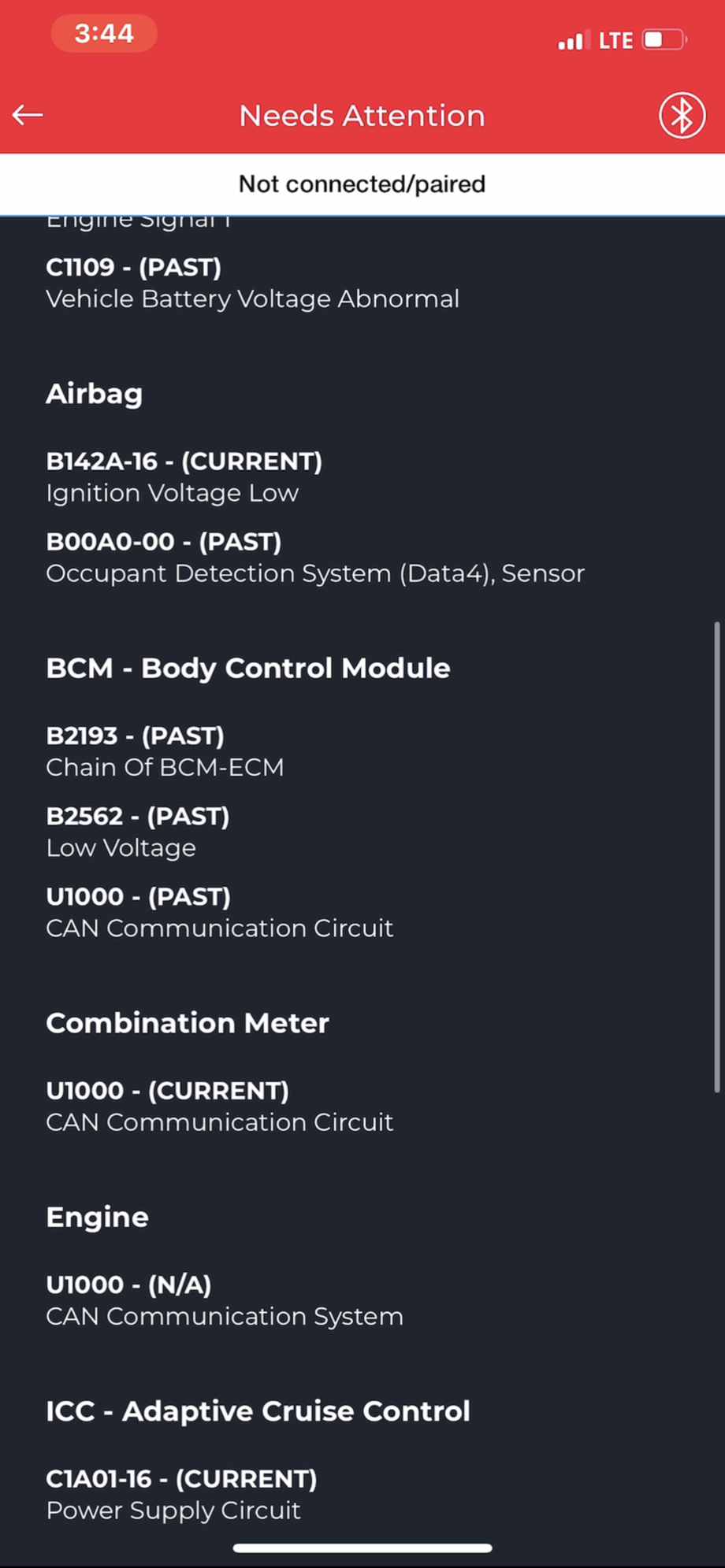

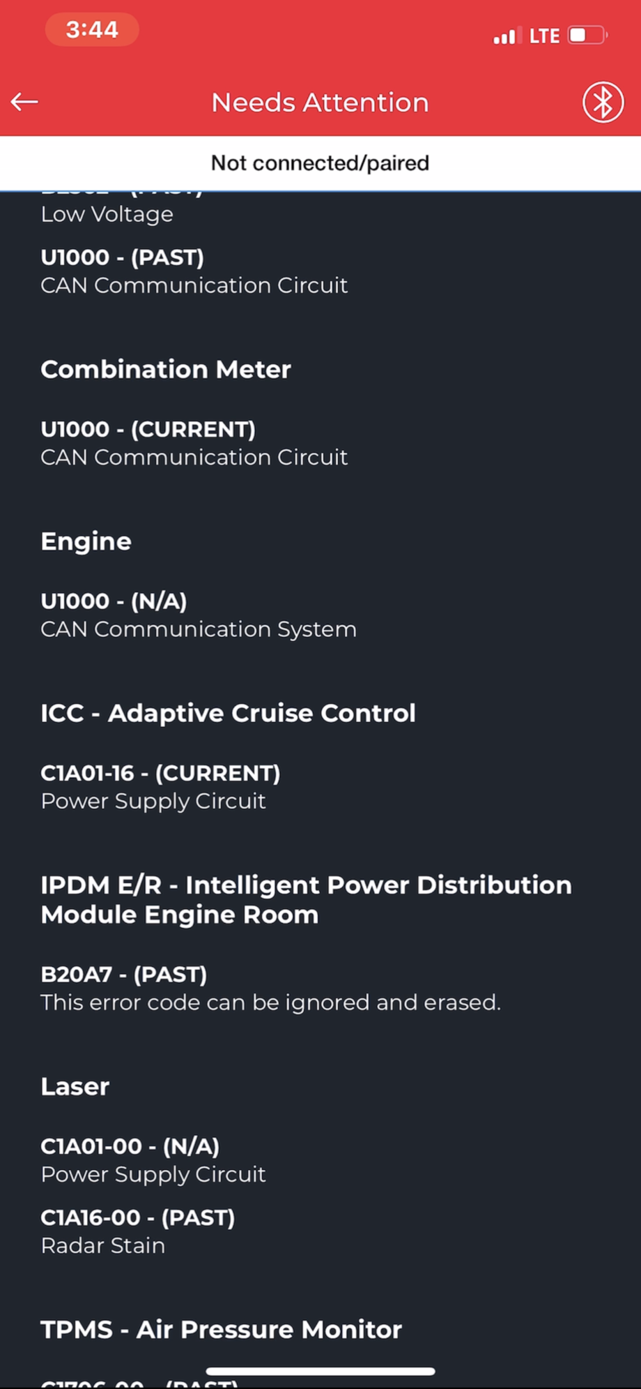

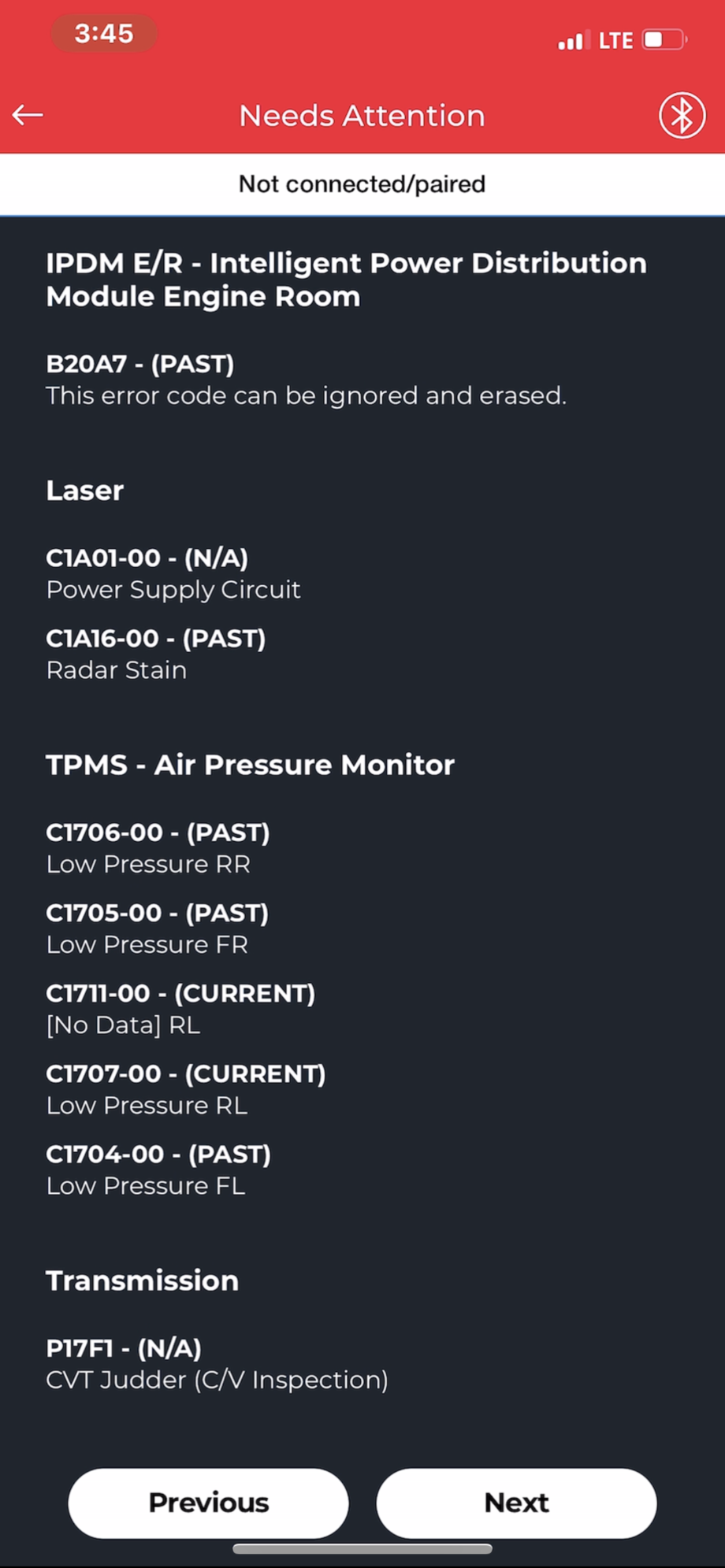

vehicle is a 2016 Nissan Maxima 3.5 SR with exactly 98500 miles
So this is going to be kinda long but you don’t have to read it all so I’m having a wide range of issues that have ended with my car being dead and not recharging properly so I’m thinking alternator or if you want to read all my troubles and issues I’ve been having and you think something else any and all help/info/how to is greatly appreciated thanks guys
so I had just gotten off work and had a 45 minute drive back home I get about a mile from home when I take a left hand turn and suddenly have no acceleration gas pedal did absolutely nothing my car is moving off of pure idle so I limp it into the parking lot grab my code reader and it’s throwing all kinds of codes from electrical codes to tpms codes to can communication codes so I decided to shut it off unhook cables and let it reset its self and see what pops back up so I unhook the battery let it sit for 5 10 minutes jump it and it fires up doesn’t throw any codes it’s running good no issues drives just fine so I’m like well that was weird but whatever it’s running fine so let’s get it home and we’ll go from there I got it home scanned it again and got a maf code so I pulled the maf sensor cleaned it with the electrical safe cleaner stuff let it dry and put it back in everything was fine didn’t throw the code again and everything was fine and dandy for just over a week and then this happens so I take a 30 45 minute drive to run some errands car gets shut of and restarted 4 or 5 times with 5 10 15 minutes in between then I get back home and I’m sitting in my car with it running as I finish my cigarette it dings with front end collision sensor faulty whatever then goes away almost instantly and I was like ok then it did it again and again then stayed on then battery light came on and the rpm’s started dipping so I grab my scanner and scan it and get all the codes from the screen recording below and ove a 10 minute period it kept dipping lower and lower untill I lost everything on my dash except my climate control then it dipped a few more times and died no I have zero power battery is dead I’m going to jump it and see what happens but any thoughts as to it’s current position are appreciated before I start pulling radiator hoses or ac lines to replace the alternator thanks everyone
So I had a 40 second recording but it wouldn’t let me upload it so these are screenshots of that video
