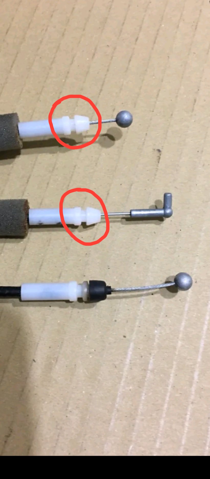

The Maxima uses cables these doors for the inside handle to lock unlock. What I typically find is that the Plastic breaks right at the handle clasps it's attached to. There really isn't a fix that will last other than replacing the door lock actuator they come attached to. The lock actuator it self typically is the failure and won't lock or unlock the door. I prefer to remove the inside handle and actuator together these days. Once the cables are snapped in. They don't come out without being broken. You would need to remove the door panel to check This.
