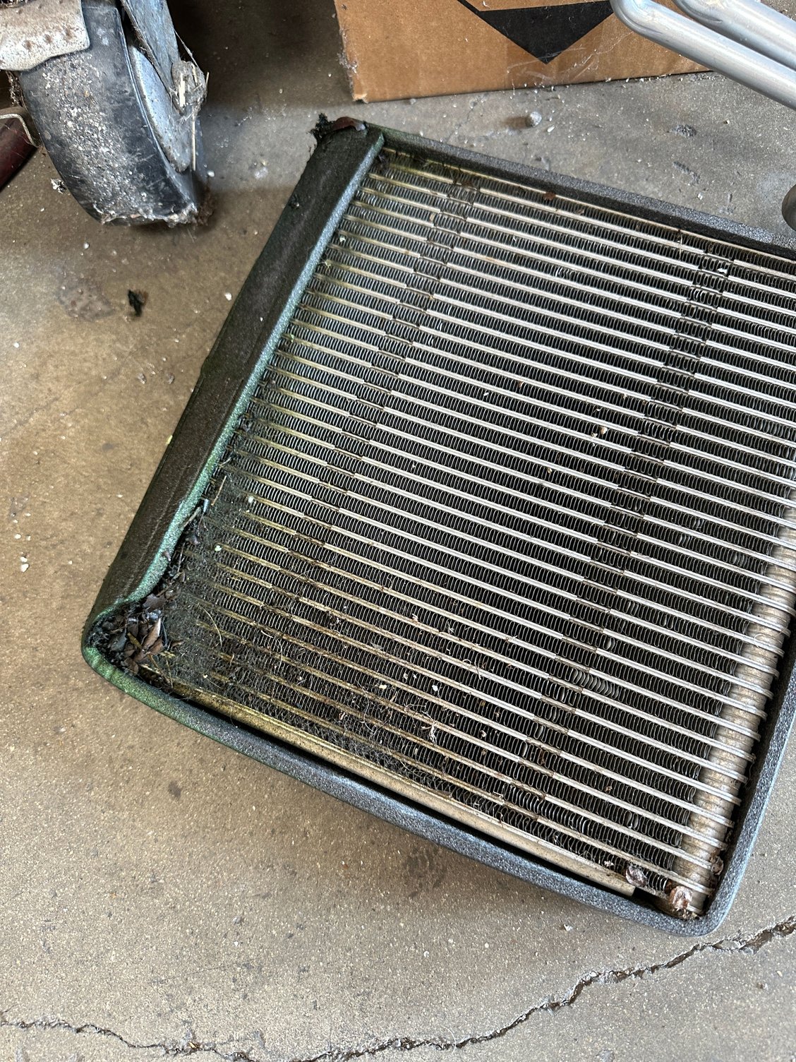

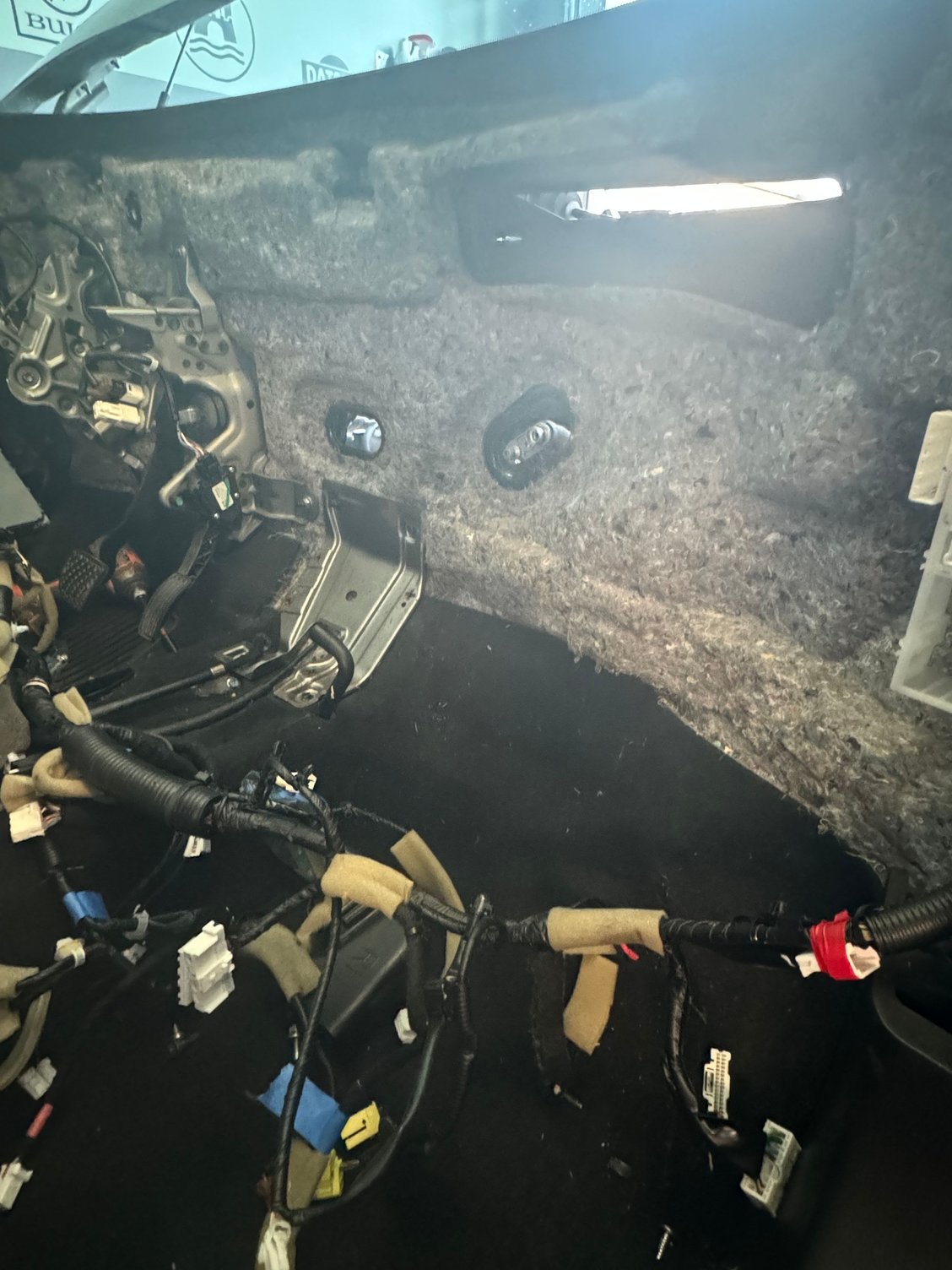

Scary to see this but it’s the only way to repair it it smh thanks Nissan….. I feel these manufacturers design these vehicles on purpose in a way to make it more expensive on the customers for repairs this is how it looked yesterday morning I hope should get it back this week but🤞🏼

Got her back
Well just got her back and she’s blowing ice cold now 😀 she’s super dirty goin to do a full detail tomorrow morning. No vibrating noises or rattling noises seems tight and well done thanks to my mechanic I’m happy to have it back. Time to start saving money on gas again 🥹 driving this vs my f150. Glad I didn’t take it to Nissan. They wanted to charge me almost 3000$. To do the job. Total price I paid was $600. For everything the coil was 80 bucks plus the Freon and labor was 425$
i have known my mechanic for 20 years. Really reliable. Here’s a pic of the coil lots of dye on the left bottom corner. Hope all of yal are doing well Nissan peeps. Just updating the situation.
