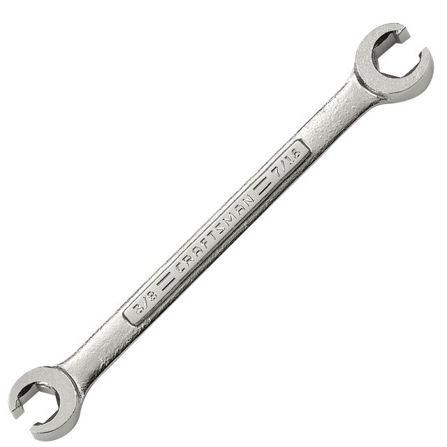

Originally Posted by Dubbya
Use box wrenches and pb blaster.
Originally Posted by upstatemax
yes, yes, yes!
NO, NO, NO!!!!
First of all:
1. a box-end wrench has an enclosed ring...you cannot use it on brake lines since there's no way to put it on over the line
2. you MEANT to say open-ended wrench
3. most people have combination wrenches (one end open, one end boxed) like so:
DO NOT USE BOX-END OR OPEN-END WRENCHES!!!!!!!!!!!!!!!! (unless, of course, you want to strip the fittings and be totally screwed).
Go to your nearest car parts store or Sears and buy a set of flare-nut wrenches, which will not strip brake line fittings, which are made of softer metal. Box-ends (well, open-ends) might work, but you're taking the chance of stripping.
As you can see, flare-nut wrenches have more surface contact points (6) than box-end wrenches (2), and are much more effective. Nobody who works on cars should be without a set of these....

Originally Posted by irish44j
NO, NO, NO!!!!
DO NOT USE BOX-END WRENCHES!!!!!!!!!!!!!!!! (unless, of course, you want to strip the fittings and be totally screwed).
Go to your nearest car parts store or Sears and buy a set of flare-nut wrenches, which will not strip brake line fittings, which are made of softer metal. Box-ends might work, but you're taking the chance of stripping.
Thats what I meant... I got confused. Now I feel like an azz.
Thanks for the correction.
