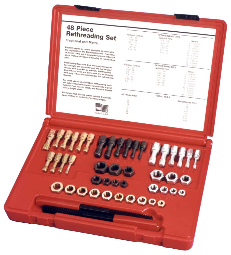

Also all those big suspension bolts on my car are either new or I used my tap and die set to re-new all those threads. IMO it's critical to have a good set of threads for a bolt to work properly and to get correct torque readings. This is especially the case for us auto-x & roadcourse guys.
We'll mine are finally in. What a pain. Turns out nearly all my threads were partially stripped on those 6 bolts holding the rear control arms. Had the Firestone that does my alignments help. Gave them some new $6 Nissan bolts but they didn't have a M14x1.5 tap. Neither did Ace, Carquest, Napa, HomeDepot, Lowes, Sears, TrueValue, etc. Turns out Harbor Freight would've been a good choice but I forgot about them at the time. We made do with what we had, replaced a tie rod while there, and aligned.
Turns out I only get an additonal +.3deg caster avg. +3.8L, +3.6R which is still higher than stock specs allow but I'm dissapointed. Nothing near a whole degree in my case. I think the offset hole left & right isn't such a major change as the way it pushes the arm forward somewhat. The back has a small lip that pushes the bushing forward a tick, and it's not drilled all the way through but rests on poly in the rear. Seems the arm get's moved forward nearly 10mm.

I've never used tap & dies before but I'm gonna start now as who knows what's gonna go bad next.
