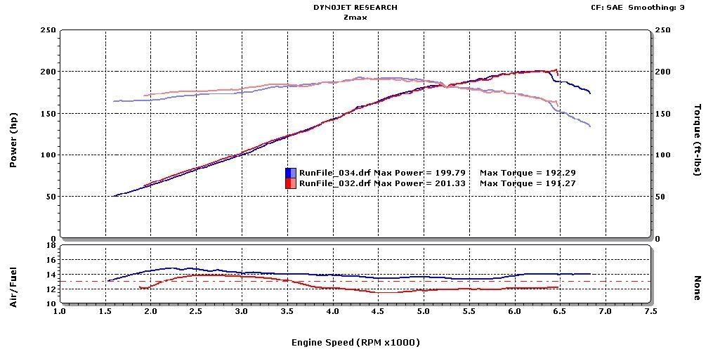

Just got back from the dyno. My best run was 201whp/191.27wtq and this was with my stock ECU.
I will upload graph shortly. Basically I started off dynoing with JWT ECU. Kept getting inconsistant #'s so decided toswitch back to stock ECU and this was the result.

Run 32 is stock ECU/MEVI/I/Y/E
Run 34 is JWT ECU/MEVI/I/Y/E
two things to notice look at the JWT ECU dyno how LEAN it is and look at how the power dips once i rev past 6500 with JWT ECU

Sent Kevlo notice how LEAN the A/F is with JWT ECU
Awesome #s for a stock ECU. My tired old VQ makes that HP with +8 timing and a 13.5 A/F, without the SMT it's around 185~190 WHP. However you left your precats in, so that may explain why your A/F appears so lean on the charts. Speaking from my experience when I dynoed with the cataytic converter installed my A/Fs were much leaner. When I went with a test pipe the A/F was in the 12s at some points.
Oh and there are ways we can fix the inconsistant JWT ECU.

MEVI Power ... hopefully the ECU gives some torque back ..
Can you send them to me as well. bizzy1999@hotmail.com
I think you're VI actualtor is closing after 6.5k

I lost no torque with MEVI....The next file KEVLO is going to upload will show my last run from when i dynoed back in december which is RUN 16 compared to my best run from today RUN 32 which was with stock ECU/MEVI.
Esentially all i got from JWT ECU was extended rev limit. there was no power increase at all. Look at run 32 and run 34 which are the two best runs.
run 32 Stock ECU
run 34 JWT ECU

So what does this mean? That a stock 99 ecu is just as good as a jwt ecu for other model yrs? Without the raised rev of course. From the dyno, I see no low end loss that was reported from others with the mevi installed. ANd it seems like the raised rev limit did not help you out at all.
How was the ride in that SRT-4 by the way? That thing kills vipers.
http://www.srtgurl.com/
No it does not it means 1999's are diffrent and JWT needs to work out the bugs on the Program. I am getting codes with the JWT which i think are hurting performance.

Wow. This is really great to look at. Just like jsutter said the only loss was a few couple of insignificant dips... Hardly anything at all.
And looking at this, the only thing that the JWT ecu gives you is an extended redline. Is it really worth the extra money?? Especially when the power declines dramatically after 6500.
Looking at the mevi w/ stock ecu vs. no mevi dyno, with gains past 4800 and really significant gains past 5700 with the stock ecu, I would think that the best route would be to save your money and just run the stock ecu with the mevi.

that jwt ecu looks like all the did was raise the rev limiter.. other than that there is no gain from it.glad i havent sent mine in yet. i think im going to hold off awhile now
no they also did something with the AF look how lean it gets with the JWT ECU compared to the Stock ECU and even when its is leaned out it still doesn't make more power than my stock ECU.
I am Sending BEN my dynos he said they will come up with a new eprom for me

Was the MEVI still open after 6.5k, bucause it looks like the valve may have closed. I've seen many dynos like this that show a drop like that when the valve closes accidentally/undesired (96sleeper).
What exaclty is Ben going to do with the new eprom?
I'm thinking the same thing. I know somebody else whose MEVI closes at 6300 rpm. I wonder if it is a Summit rpm switch quirk.
I Know on some dynos it looked like it didn't open and on the 2 highest dynos i know it did open. I am not sure if it was closing at a certain RPM. I really wasn't paying attention so i don't know if it was closing.
I think because of the AF on the JWT ECU the car was pulling timing in the high RPM because it WAS VERY LEAN. if you look at the dyno graph of the 199whp with the JWT ecu you will see this. The dyno operator explained to me if it gets too lean the car will pull timing to prevent detonation.
