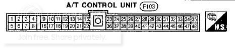

I think I have it figured out. Keyword: think.
Sorry for the blurry pic, but:
Realizing that it's a tiny bit sideways, I assume that the wires go..
1 3 5 7...
2 4 6 8...
Like that, rather than straight across numerically. Am I right? If so, the wires match up. I can't seem to locate a green/black wire for the torque converter though in the location it says it should be
Old Apr 30, 2007 | 03:02 PM
nismology's Avatar
Joined: Apr 2003
Posts: 9,099
From: Miami, FL
Old Apr 30, 2007 | 03:11 PM

Posts: 7,662
From: State College, PA
Originally Posted by nismology
Thanks. That clears it up for sure!

Oh snapes...didn't realize the POS you posted before had the pinout.
Old Apr 30, 2007 | 03:30 PM
Tatanko's Avatar
Bacon Lover
Posts: 7,662
I didn't catch that either. The one in the 1995 FSM doesn't have the pinout in the middle of the picture like that one does, and it was what I had printed out looking at.
