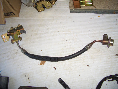

Originally Posted by Remminator
The return line has an ebay afpr in line between the t fitting and the return to tank. The 51psi was verified prior to the stock fpr at the fuel rail. My setup is included below: What should the afpr read with the 4th gen fpr?
IF your picture is an exact representation of your setup, then you've made a HUGE, EPIC blunder.
That 4th gen FPR absolutely must NOT be where it is. Remove it at once!!!! If you don't have *another* return line coming from that 4th gen APR, then you have the 4th gen APR connected backwards which won't allow any fuel to reach the rails.
A FPR is not supposed to act as a restriction in the line. It's designed to bleed off the excess pressure.
Yes, an engine can run briefly without spark with starter fluid. It can use compression/heat alone to ignite the mixture. The autoignition temperature of ether is only 170 °C (338°F). That's easily achievable with compression alone.

So your saying that the 4t gen fpr does not go on the supply side? Does that mean that the fpr regulates fuel returning to the tank? I thought it regulated fuel pressure entering the rail. The fsm doesn't really explain.
Seriously, I don't know how much more clear I can be on this. This is the third time it's been explained to you.
The FPR DOES NOT ACT AS A FLOW RESTRICTER!! This is how you have it setup. The FPR is supposed to bleed off excess pressure and return that excess fuel to the tank.
Your ebay FPR is setup correctly. Your 4th gen one is not. There's no reason in the world to have two FPRs. Putting a FPR inline with the fuel inlet to the rail will never ever in a million billion years work correctly.
On the 4th gen setup, there's a FPR on the fuel rail OUTLET. When the pressure in the rail rises above spec, the FPR opens up and bleeds off that excess fuel pressure to the fuel tank. It does not act as a restricter to the fuel rail inlet.

The stock 3.5 damper is not your problem, your problem is having the 4th gen fpr in there. You only need one FPR, if you want to run stock fuel pressure, put the 4th gen fpr where you have the ebay one. You dont really need 50+psi like we used to think. so you can have the stock fpr and its fine. your plumbing is fine, just only have one fpr at the T not on the rail

This is how you should have it, this picture is by 96sleeper. You want to have it like the "Old Setup(top diagram)"
Either setup shown in this picture will work just fine. In fact, the "old" setup shown in the top will work slightly better because you're not returning warmed up fuel to the tank.
