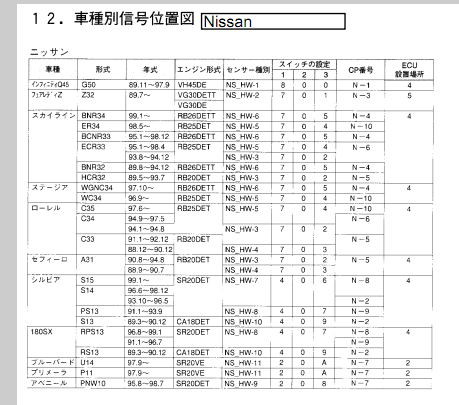

We got the emanage connected, it was a driver issue with the usb > serial adapter.
Now the Support tool gives a communication error when trying to import data from the unit. I suspect that is because the support tool is running v1.11 and the emanage is running v1.49, yet when I try to update the support tool to v1.49 it tells me "Access denied (5)"
Does anyone have the support tool with v1.49 already integrated to it? Everything I have come across online brings me to a dead end.
Edit: I was able to update the support tool to v1.20 and it communicates with the emanage now.
Now I need to find the airflow dial settings to adjust for a LRMAF.
Edit 2: Ok I found the airflow dial settings for a Q45, which I believe I am supposed to use for the LRMAF. Q45 in and A33(or equivalent) out.

For anyone that is still checking in on this thread for the airflow dial info we are using Q45 maf in and A33/Z33 maf out. http://forums.maxima.org/4921445-post38.html I believe that we used 7-0-0 as the dial settings.
