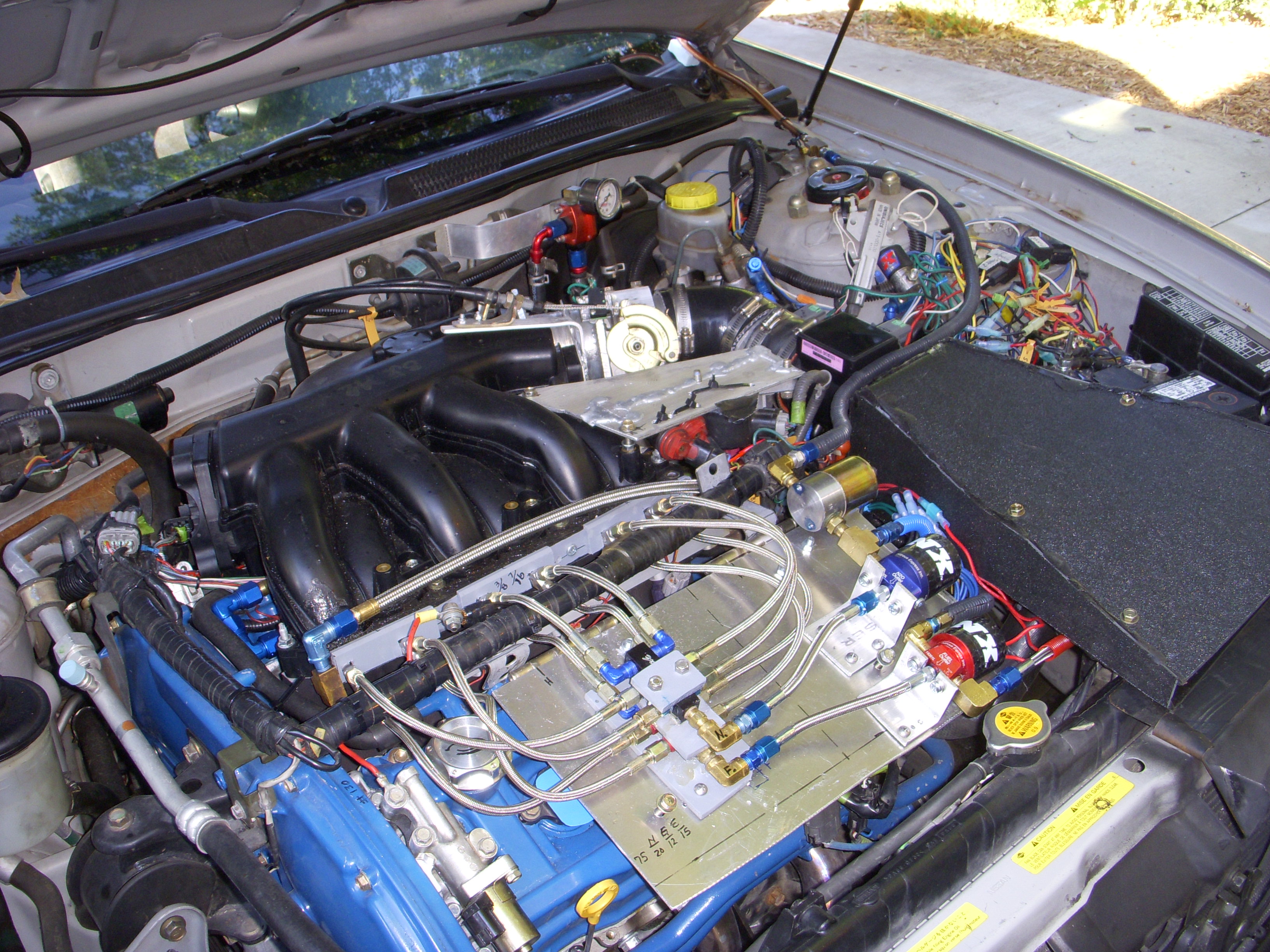

Originally Posted by taz394
still debating on what manifold too ... probably gonna end up making a custom one
How about a plastic intake manifold? With nitrous?
I've never heard of the TX 2K anywhere ?? - Googled it and it looks like a big deal !!!

hmmm ... have you dyno'ed your car all motor
im still debating you think this is a better alternative then a custom manifold or even a kinetix ... (Well the ports don't match on a kinetix though so idk if i'll go with that )
No dyno yet. A) I don't care about N/A power, 'cause timing is fuxored for REAL nitrous power, and I'm not racing N/A. B) I'm not done with the development yet. E85 = bigger fuel pump, bigger fuel lines, bigger injectors, gold-plated spark plugs. Already have the huge filter...
Ask SurraTT about his plastic project - see if he has an opinion on the mod. I think it's great. Kinetix is likely a waste of time. I'd like to know more about sparks03's design and why it's supposed to work so well. There might be something good there for us mere mortals.
