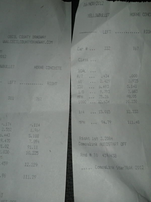

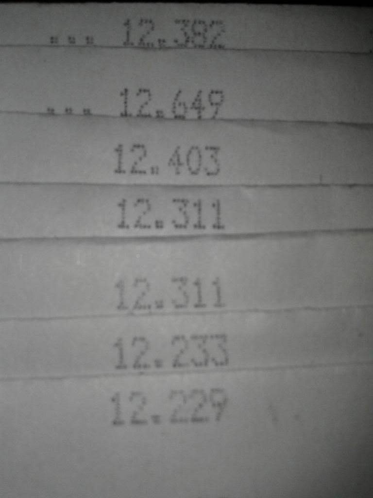

Update: i hit the track this just pass friday and ran 12.2@111
Heres a photo of most of my runs.

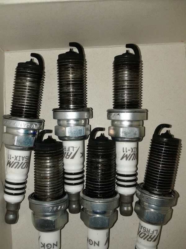

I went out and pulled the plugs on my car and came back with these. smh
Im going 1 step colder and taking the car back to the track fiday to try for an 11.7- 11.6

Originally Posted by blackmaxftw
stock convertor and im spraying 100shot .....i have a 03 trans wired in for the 4thgen
Nice man gives me some good motivation for my drag car im building soon.
Damn those plugs are rich. Did you pull those right after a WOT pass, or did you idle and drive around on them for awhile before you pulled them?
You could lean out the nitrous fuel jet quite a bit if that is after a WOT pull.
Or my personal favorite, more nitrous with the same amount of fuel.
