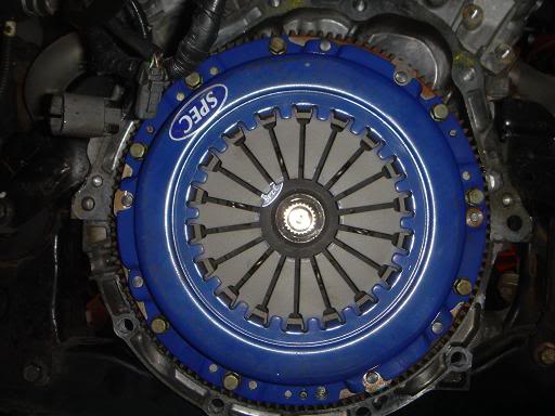

you can go without 1 bolt. as long as the other 8/9 bolts are holding it in.
I had that issue for 3-4 years without any problems, until the clutch wore out..
make sure you align the clutch exactly in the center, and use a torque wrench when you tighten those clutch bolts
^^^can you find the missing bolt?
the proper way to remove the stripped/broken bolt would be to drill it out a little bit and use a reverse thread bolt extractor to try to get the rest of the bolt out the threads.
Otherwise it's drill it out completely and retap the threads.
they're M8x1.25 thread pitch, I believe
