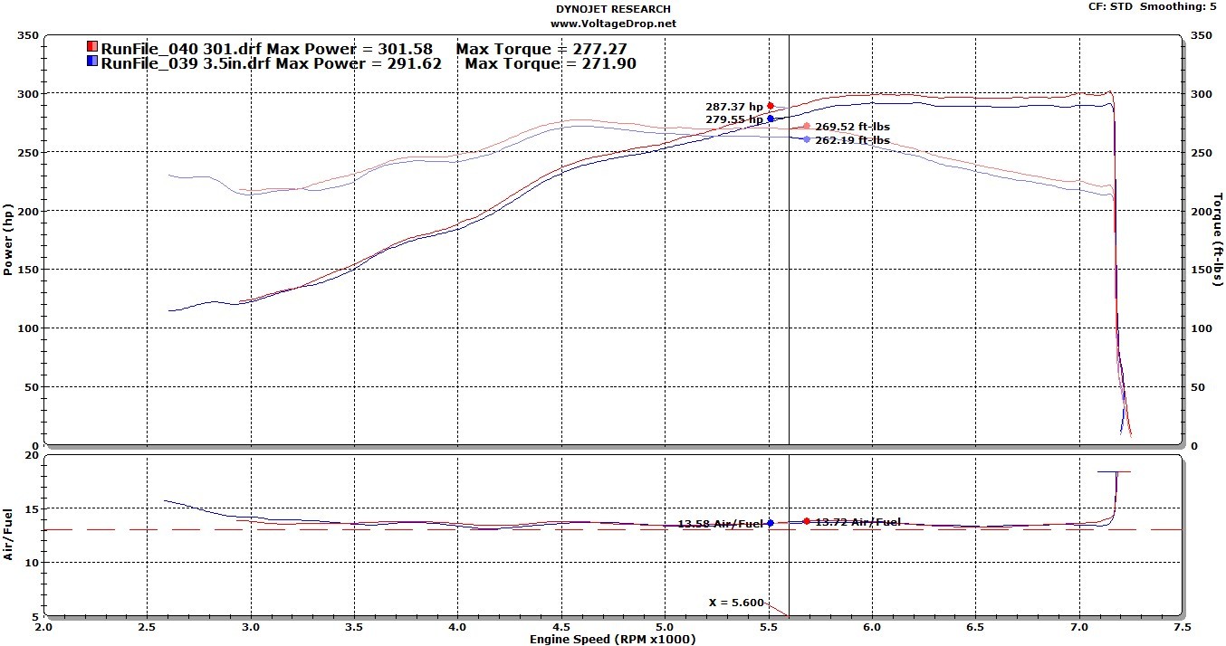

I'm a little confused right now. My car was making 253whp/250tq at my last dyno. Since then i removed the vias. Recently I installed 400cc injectors and a custom adapter plate and the 09 tb. I was runing a little rich after a rough street une. Today I went to the dyno and installed the 80mm BBMAF. I have been under the impression that these two mods would significantly increase horsepower, yet it did not. In fact, as you can see by the dyno's i lost about 40 tq and 25 horse below 4k rpm. After 4k rpm everything is about the same.
so what the hell happened? I'm thinking i need to put the VIAS back in there because the power loss is insane. it's the only thing I can think of. Either that or gutting the Upper intake manifold.
I 've been reading how a 4" MAF makes huge power increases (mine is 3-3/8), but it seems to me that the larger bore MAF caused a huge decrease in air velocity which is definitely showing up here.
Run 6 is the new run. Run 12 is the old run that made the better numbers. We didn't tweak the AFR to perfect. My tuner said it would be a waste of money to tweak it to perfection when there was something definitely not quite right.
Actually i'm not sure how to get the AFR to pop up on here, but suffice it to say it is between 12-13 for the run.
So the question is how do I get my torque back?

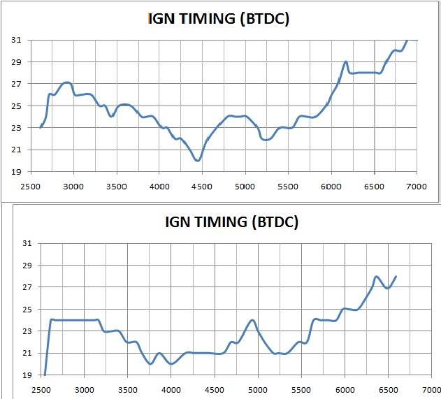

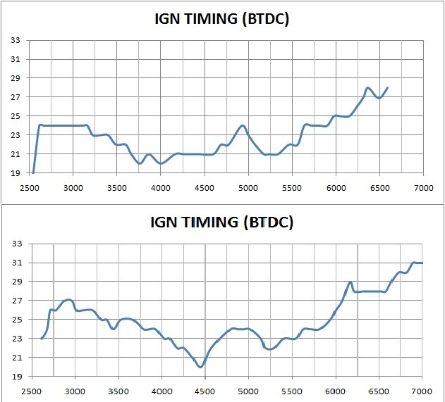

This curve is slightly aggressive.
These are with various stated of MAF voltage conditioning.

That's great! Thanks Manny, I will do a pull or two on the way to work tomorrow when I get onto the highway.

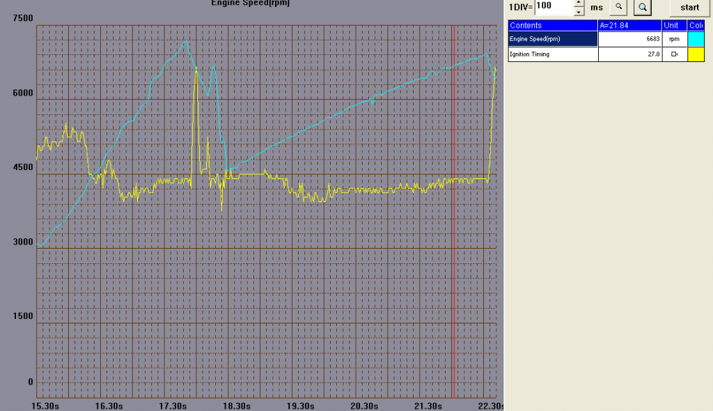

I'm on my way to work, grabbing the laptop and I will use the emanage to datalog a 3rd gear pull onto the highway.
So If I see the timing is out , can I just add/subtract timing when i get home, or does that completely mess with the tune ? I know in the past when I had my first tune, dandymax took a look at how much timing was added and just took a big block in the emange blue and added a ton of timing. Shaved about 1 second of my 1/4 mile time and added a few mph as well. But I didn't have a wideband at the time so I have no idea what else changed.
At least now if I change something I can see if the AFR is bad.

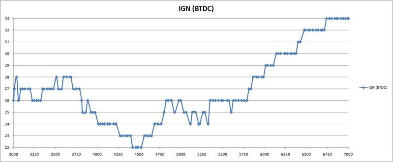

this is my curve from a wot run when i had the 3.5 intake and n62 maf or whatever bmw v8 maf it was.
