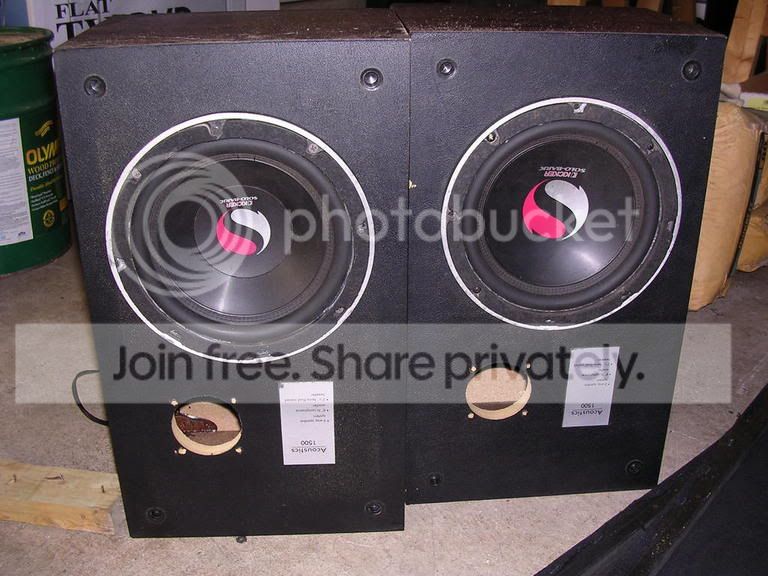

I just bought a '94 Camaro project car (see Other Cars) and these 8" Kickers were in the hatch. I'm wondering if powered by a so-so amp, would these be decent to install in my little sister's car (who turns 16 next month) in a new enclosure? Thanks guys.

Yep. The only problem with 8's is that they tend to blow because the people who own them were too cheap to buy bigger drivers and turn their gains all the way up expecting them to sound like 2 12's.
That said ... PLEASE put them in a new box :lmao:

I really wish Kicker would have kept making the older round SoloBaric drivers. Those will work great. Especially in a hatch. You can go as small as .44cf sealed and they will get down for a pair a 8's. If she doesn't know about volume control and distortion I recommend the smaller box.

I think given the situation, they would be perfect.

nice score imo- too bad their cones they are different year models,they are hard to find- i think they'd work great for your sisters needs
I have a perfectly working 12" SoloD version in my garage- the dustcapless ,full concave version-like the one in the right of the above picture-still gets down

those are perfect...i always liked the old school round solos from kicker. make a nice custom fiberglass box for your sis.

You know, I didn't even notice that they are different models Looked at them for about 30 seconds when I pulled the grilles off to snap the pic and haven't looked at them since.

port em! 0.75 ft^3 ~ 40hz haha

definetly port them

also as a side note, kicker does still make round subwoofers in the 8" version. They actually are called Kicker Comp's though. You are right that the solo baric's are now square, but the comp's are not bad speakers. If you want you can even go with CompVR's which are right below solo baric's in performance, or geared toward's a different sound quality I should say. I actually just got 2 CompVR 10" subs for a buddy and they knock like crazy. So if you are just looking to keep the round design for box flexibilty than look into Kicker's new line up. The new Solo's are ridiculous though if you haven't heard those yet. But all in all your speakers that you found should sound find considering that they are not blown.

From what I remember, the old Solobaric subs were intended for sealed enclosures. Am I mistaken?

x2. They were made for sealed enclosures. The round 12's only need .88 cu ft of space. I would imagine the 8's need a lot less. Those subs sound VERY different from the Solobarics of now. They are very clean and tight sounding. I think you'll be quite surprised.
