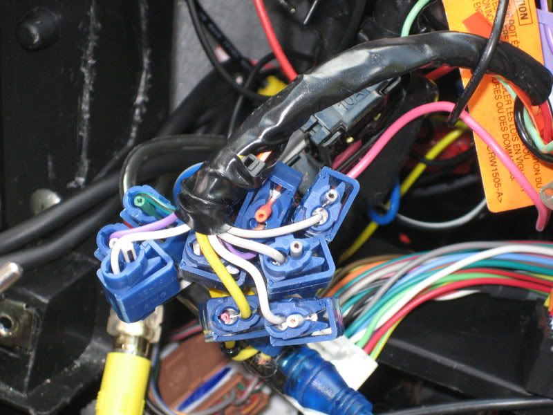

Just thought I'd share some of the misery I get occassionally. This was here today and I figured Id play a bit. Now one of the major issues the customer had was no FM stations..I told him it's simple - your installer never connected the power antenna lead. He questioned the self proclaimed 'installer' and was assured that it was. Little did I know opening this dash would lead me to a plate of spaghetti larger than whats served at a San Gennaro feast...
Just the start:
Do we not remove these things when done?
No wonder no FM, antenna lead is NOT connected. And hey why not leave this wire hanging around bare? Im sure it doesnt do anything..
So much crap it busted out the side..
Dont even ask, I guess when one is lazy enough to repair a mistake - Just cut the car apart to move wires..

Now mind you this is not a 16-17 year old kid that attempted his own work, but rather a mid 30's 'experienced' installer. The fact that he is in the process of attemtping to open his own shop ( he feels Very capable) just scares the crap out of me.
The above explosion took place in a '05 Maxima With Bose. Now not all want to use the simple method of a Metra 7551 or just splicing in their own RCA leads, but would rather feel more comfortable with an 'adaptor'. This experienced installer figured eh what the hell let's just wire it like any radio.. Oh how this little stuff just urks me. Now wonder why so many people are afraid of shops nowadays.
