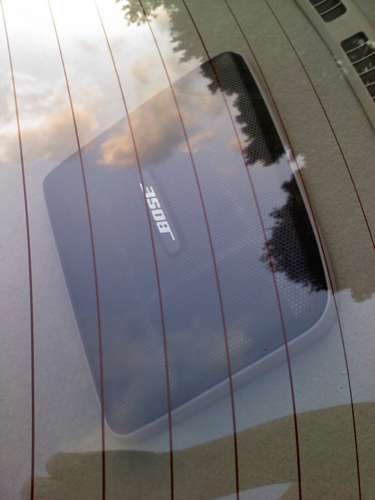

Is there a significant difference between the type-r and type-s? I'd be willing to shell out an extra $200 or so for them if there was. Also, do you know what these speakers are?-
They're behind the rear seat, and when I open the trunk I can see the bottom of the speakers, there's 2.

those are the maximas bose 6.5" rear speakers. you can replace them with a set of those 6.5" alpines. the difference between the type-s and say the more higher end from them the type-r is mainly the different materials in the surround and the cone. they are made with different materials that make the sound more rich compared to the type-s's. they can also handle more power if you want to amplify them with an aftermarket amp.
