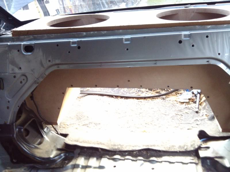

ok, new box is built using MDF, after accounting for .15 cubic foot for the size of the woofer, im at 1.28 cubic feet per subwoofer, thats after modifying the box.
heres the first test fit of the box into the "parts car"
as you can see i made the box too tall and couldnt get it to roll up into the decklid, needless to say i modified the bottom of the box, i cut 1.25" off one side of the side legs, and .50" off of the back side of it, i probably didnt need to, but i did anyway, the box isnt sealed up yet, its only screwed together.
here's the results of me modifying the box.
its not level, and its not complete yet, but it fits, i can already tell that im going to have to cut the final opening on the car to 38.5 inches wide, and 12.75" deep, the current opening is 38.125" wide and 12.50 inches deep and the box is super difficult to get into place.

very nice design you have there. Do you have any more photos? particularly of how the box will be supported. From the bottom pic it kinda looks like its floating. I hope you get the good sound your looking for.
right now i havent decided how i want it to mount, ill probably make some brackets out of 1/8th inch alloy i have at work, something thats strong enough to support it, ill probably make some L brackets to bolt from the existing deck to the side of the box also, this way its supported on the top as well, ill put dynamat between the brackets and the box to keep vibration down also. The "parts car" had about $100-150 worth of dynamat stuck to it, ive been trying to peel it all off, im hoping i can re-use it.
