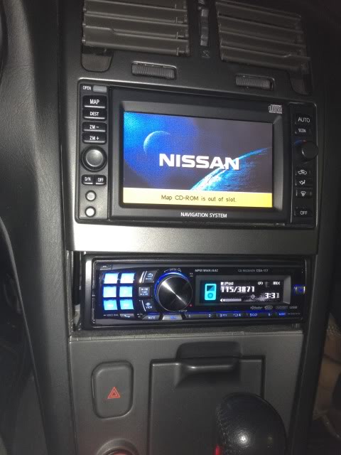

Hey, I just seen your message you sent me.
First since you want to keep the factory nav. You will need a single din head unit with whatever preference you need. The alpine CDA-117 which I have can do pretty much what you need. But I believe that head unit is discontinued.
You will have to fabricate a dash kit. Since they never made one. I never got a chance to do that yet but i'm pretty sure you could. If you do please inform me which kit you used please. thanks
I did the install with my uncle he has some knowledge on installing headunits & alarms. The climate control still works & Navigation. The Only problem I have is the spoken directions does not come thru the speakers. I'm not sure if you could get that to work maybe a well experience installer can make that work.
The steering wheel controls should work you will have to get the adapter. I never did it I was planning to right now I'm focusing on repairs . I got 115K issues keep popping up. :-(
Also if you want I believe i came across someone on the forum did a double din head unit & install the regular climate control buttons.
That's how my dash looks right now i hate that space.
