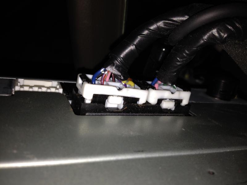

How Do I Disconnect this Plug?
There must be some trick that I am not getting about this plug. How do I release this plug? I've tried prying up the white part, but it feels like it's still latched in. How do I unlatch it? Something with the black metal tabs on the ends of the plug?

I should have mentioned that this is the factory wiring harness plugging in to factory headunit. Thanks!

Press the tabs and pull out. That style connector is one of the more annoying ones.

Thanks for the reply. It was easy, but I was missing the obvious. I was thinking that the tabs on the ends were what I needed to press in, but it was the white tab in the center of the long side that needed to be pushed in. It was a deeper "push" than I was expecting, so that's why it didn't release when I tried it first.
All good and proceeding with the install now! Thanks!
