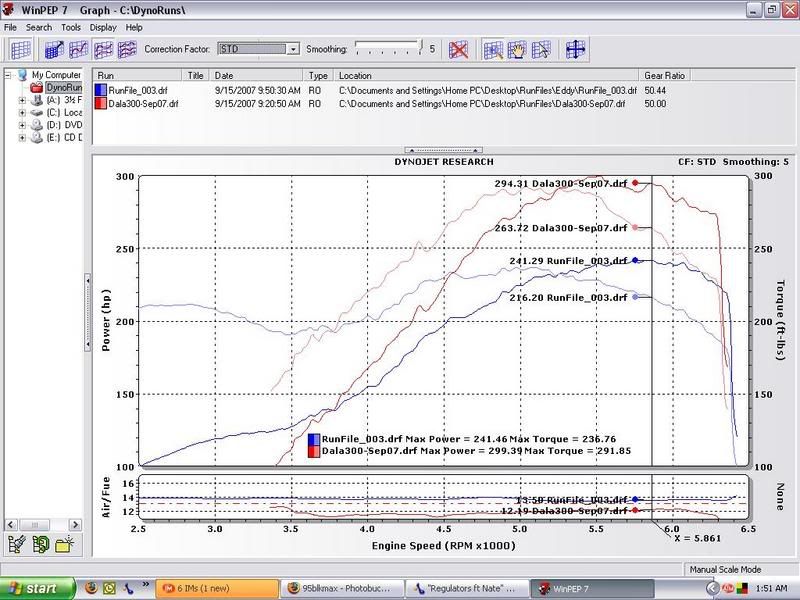

I over laid streetzlegendz and my dyno. Our best dyno runs from Sep 15th, 2007. Just did it for the hell of it. Any comments welcomed.
Both of us have done a few things since.
Streetz fixed his VI issue, upgraded to a mandrel bent feed pipe out the turbo (instead of that nasty accordion crush bent pipe he had that the whole world told him to get rid of but he never did... until now, LOL)
I added long-tube headers with a custom equal length ypipe, and an ubber short intake a-la NMexMax (buh bye midpipe).

I have seen this ubber short intake. Its very very short.
