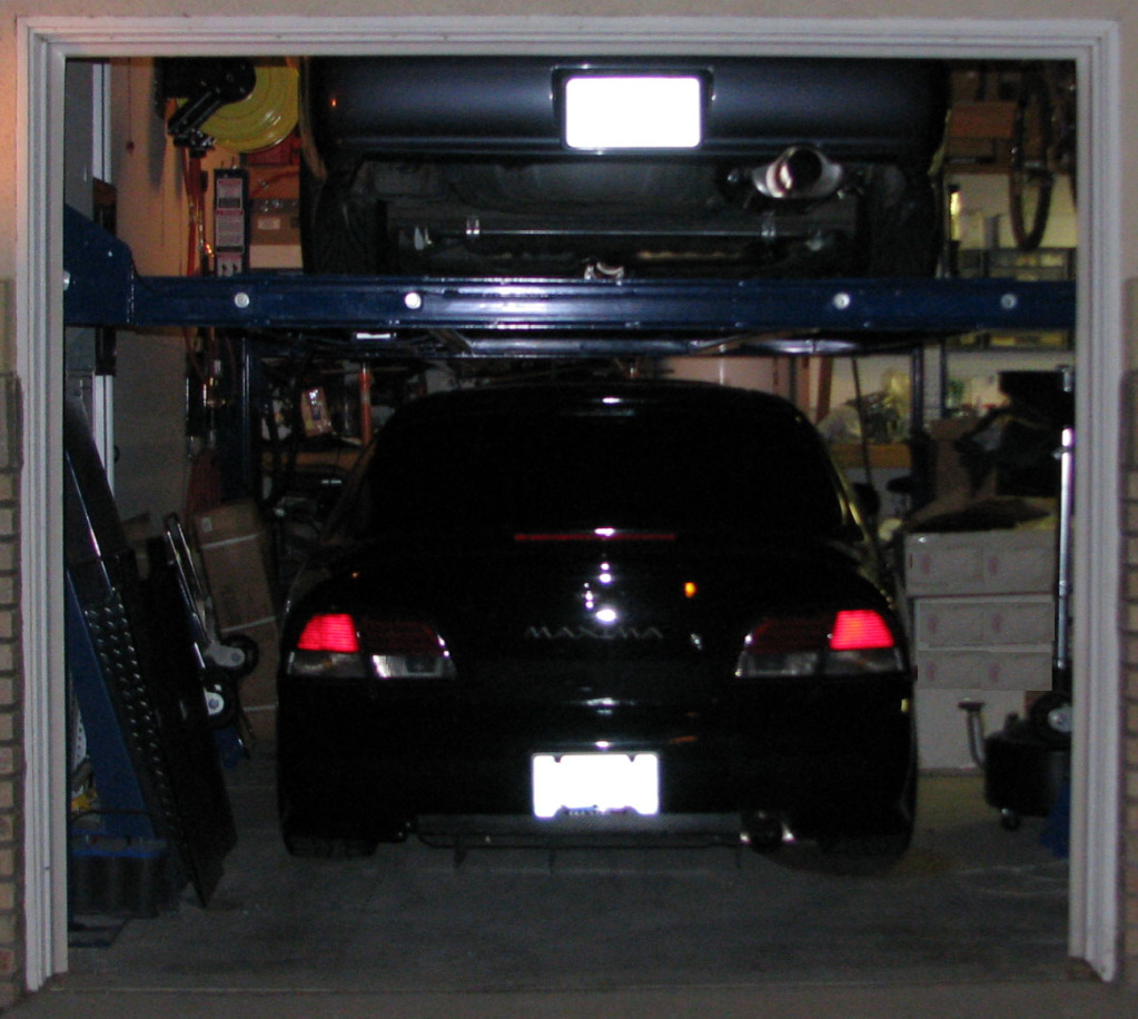

I have two Bendpak lifts, a 4 post and a scissor lift. Between them I can get pretty much anything done. If you plan on doing a ton of work, a two-post is the way to go. I don't do a ton of work, plus I wanted to store another car in the garage safely and not have the suspension hanging for long periods of time, so I chose a 4 post.
Bendpak's reputation and customer service is second to none.
If I decide to build a monster garage/workshop in the back of my property, it will have a Bendpak 2 post in it.
I built my 4 post with the help of Ptatohed. Everything was easy and doable except for the ramps. Freakin' heavy. I installed a new subpanel with 220v outlets for the lift and my welder myself. The scissor lift runs off of 120v (20amp) circuit.
Securing a 4 post to the floor is optional. I chose not to, as I feel in case of an earthquake, it will be better to allow the lift to "walk" rather than bend. I confirmed this with the multiple people at Bendpak.
As for installing a 2 post lift, check out www.garagejournal.com forum. TONS of great information about lifts, installing lifts, garage improvements etc. You'll be surprised how much great info is on that forum. Before you buy a lift, call the manufacturer and discuss with them what is recommended for installation, as every company has different requirements/suggestions.
Here's the 4 post

^^^wizard thats a nice 4 post setup you have

This gives a whole new meaning to the term two car garage.
