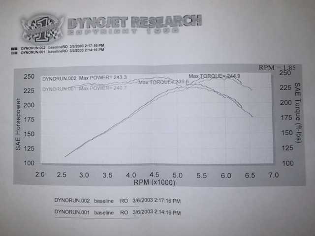

Looks EXACTLY like a....
Originally posted by MAX2000JP
Well here is my dyno sheet:
First Run: 181.8 HP and 195.6 Ft/lbs of torque
Second Run: 180.8 Hp and 194.5 Ft/lbs of torque
Is it?
Plus, your dyno shop needs to reformat that graph, so the X-axis isn't so streeeeeetched and the Y-axis doesn't go below zero.
Looks like that shop doesn't know what they are doing. I'd go to another shop and dyno in 3rd gear.
Re: Looks EXACTLY like a....
Originally posted by IceY2K1
NORMAL 4th gear dyno!
Is it?
Is it?
Re: Re: Looks EXACTLY like a....
4th gear is the gear to dyno in....It is the closest to 1:1. 0.954(4th) vs. 1.272 (3rd)
Most of the dyno's here are done in 3rd which seems to be more consistent, so if you are comparing yours in 4th gear to 3rd gear dynos, they aren't going to peak the same.
Again, try a different dyno IF there is one available, but that dyno is not really abnormal.

Re: Re: Re: Re: Re: Re: Looks EXACTLY like a....
BriGuyMax dynoed his Z right afterwards and got 244 RWHP. A couple of other members have dynoed at this same place and didnt have a problem, so I am pretty sure its not the dyno.
Re: Re: Re: Re: Re: Re: Re: Looks EXACTLY like a....
Originally posted by BigCmax
What gear did he dyno in? 5th is 1:1 on the 350z? Also you should post his graph. 244 means very little since it could be a blip the curves are what need to be posted as well as exact mods and gear.
I would have asked for all the data points on disk instead, because I could make a better graph in Excel than that POS graph. You can't even see the details of the curve, because it's all squished into a vertical height of like 2-inches.
Most manual transmission cars are dynoed in 4th. All my runs have been in 4th and my dyno shop insists on using 4th for most applications.
3rd gear dynos will typically show slightly less power than a 4th gear dyno. 5th will show more than 4th gear, etc. The Dynojet doesn't really care what gear you're in. All the Dynojet really does is measure how quickly your tires spin the 2000lb rollers over a span of time. Most Hondas are dynoed in 3rd because of their lack of torque. It simply takes a long time to accelerate 2000lbs rollers with a 1.6 motor with a relatively tall gear. Dynoing in 3rd just speeds up the process and keeps the engine from laboring on the dyno for too long.
You could use 1st or 2nd is you wanted, but the rollers would spin too fast too quickly that some of the data may become jumbled do to the quickness of the data coming in.
If you dyno your car in 3rd, then make sure to dyno it in 3rd everytime because if you don't the results will be skewed. The same goes for using the SAME MACHINE EVERY TIME!!!
Like I've said many time before, a Dynojet is a measuring tool. You CAN NOT compare your numbers to someone else's 8 states away. The Dynojet is there to measure YOUR CAR's gains and losses. It is not a comparison tool unless you're comparing Dynoplots from car's dynoed on the same machine and on the same day.
Dave
Dave
Re: Re: Re: Z dyno
3-cars with the same mods(2-Fed spec/1-cali spec), the LOW tq one is the Cali spec:
http://images.cardomain.com/member_i...2_125_full.jpg
Here is a STOCK dyno(I believe 4th gear) from a 2K1:
http://images.cardomain.com/member_i...2_126_full.jpg
Oh, it's mine (and a couple other guys)! The Cali had aftermarket wheels and that made the difference.
By the way - stock, done in 3rd. All 3 dyno'd around or a bit over 200 with intake and y pipe.
Re: Re: Re: Re: Z dyno
Originally posted by Max_Gator
Hmmmm.. . . that looks familiar . . ..
[edit]
Screw it, they don't show what he wanted anyways. Delete.
[/edit]

The car is clearly not making power up top....Take a look at my dyno. My VI is clearly working, thats the funny thing. I heard it switch over on the dyno and my friend watched it actuate.
