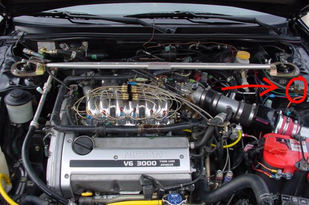

you'll have to do this more than once. there's two places to bleed the clutch. one is on the strut tower and you know about the slave already. keep bleeding until the pedal is firm.

thats just it, i bled it several times and i only saw a few bubbles come out then it was just straight fluid
where by the strut tower is the other bleeding point?

it's the hard line that bolted to the strut tower facing the front of the car.
