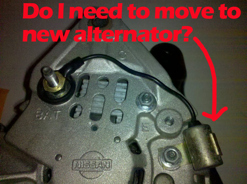

Hello,
I am replacing a refurb alternator with another refurb alternator both from the same manufacturer, it was a warranty replacement. Can anyone tell me what this little silver cylinder is in the pictures below and if I need to move it to my new alternator? It has a single lead that runs to the positive terminal on the alternator. Is it a capacitor for ripple smoothing? Not sure if I had to move it on the last one or if it just came with it and they changed the design...
Thank you,
Nick

This will be my 4th alternator (3rd in 3 years)... im worried that this cylinder thing whatever it used to be may be damaged and is shorting the alternator to ground and thats why I keep killing them..... I wish I knew what it was.

well its labeled .5 micro underneath so I'm pretty sure its a capacitor and for smoothing output ripple... Does anybody know if its critical to have? I just have this nagging feeling that its damaged and shorting the alternator and thats why my car has killed 3 of them.

I wouldn't transfer it. The diodes and voltage regulator inside the alty should produce a nice clean DC voltage.

http://www.sacskyranch.com/altnoise.htm
I may replace it anyways due to my own paranoia

In the electronic world it is called a capacitor and in the automotive industry its called a condenser. It sends the AC noise back to ground instead of it getting in your electronics. Some alternators have it built into the diode rectifier while others have it external.
