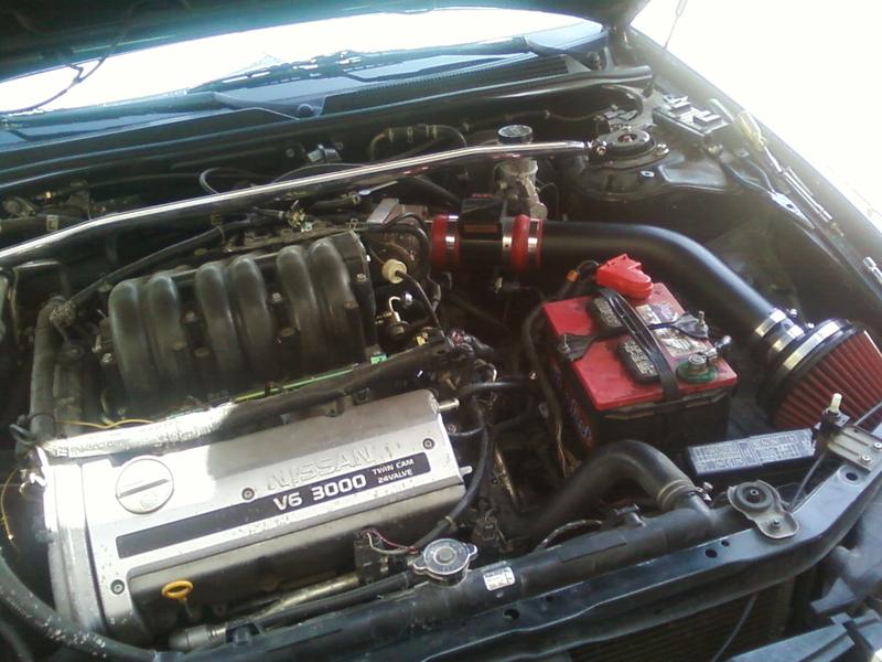

Yeah there's a handful of people running with a similar block off plate, myself included. Since I also have an extended rev limiter, I don't see myself reinstalling the power rod anytime soon.
Bad angle, but you can see the check valve where the vias assembly normally is as well as the corner of the plexiglass plate I used.
You have it mixed up. On the stock throttle body, you can use CC whether or not the VIAS is in place. On the Pathfinder throttle body (with stephenmax adapter plates IIRC), you can only use CC if the vias is removed.
k I kind of see it, but why the check valve?
I thought all those vacuum lines that go to the Vias can be eliminated if you remove it?

My car already had it before I installed the 00vi. It is connected to the pipe that runs halfway across the top of the intake manifold.
I did eliminate the vacuum lines the went to the vias. The vacuum lines that are still there are for the emissions solenoids and whatnot.
