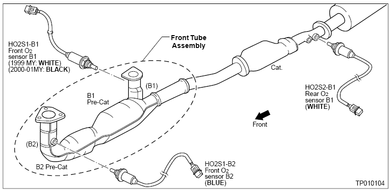

Also, avoid 1999 maximas. They had more complicated emissions equipment installed and the ECU is not particularly mod friendly.
4.0 gen = years 1995 through 1996 round grille without crossbar, more basic ecu, rear trunk has the whites over the reds, probably the best choice for performance as it may be slightly lighter and it has an ecu that is less likely to show check engine lights for cat removal, 3.5 swap etc
4.5 gen = years 97-98 (and 99) grille has crossbar, trunk has reds over the whites and the light shapes look better IMO, some exhaust system differences from the 4.0 gen are o2 sensor locations.
99 4.5 gen = more emissions junk to go wrong. I'd avoid that year

99
