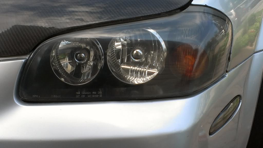

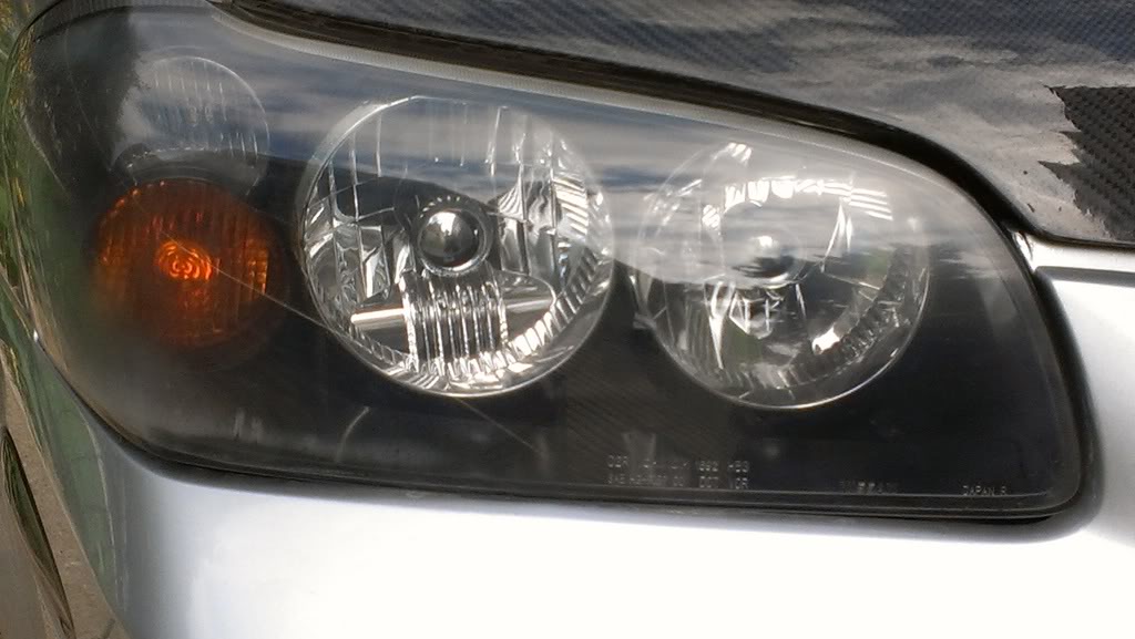

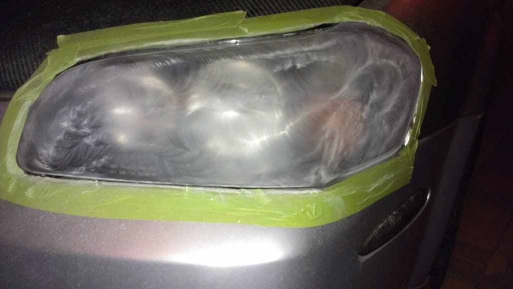

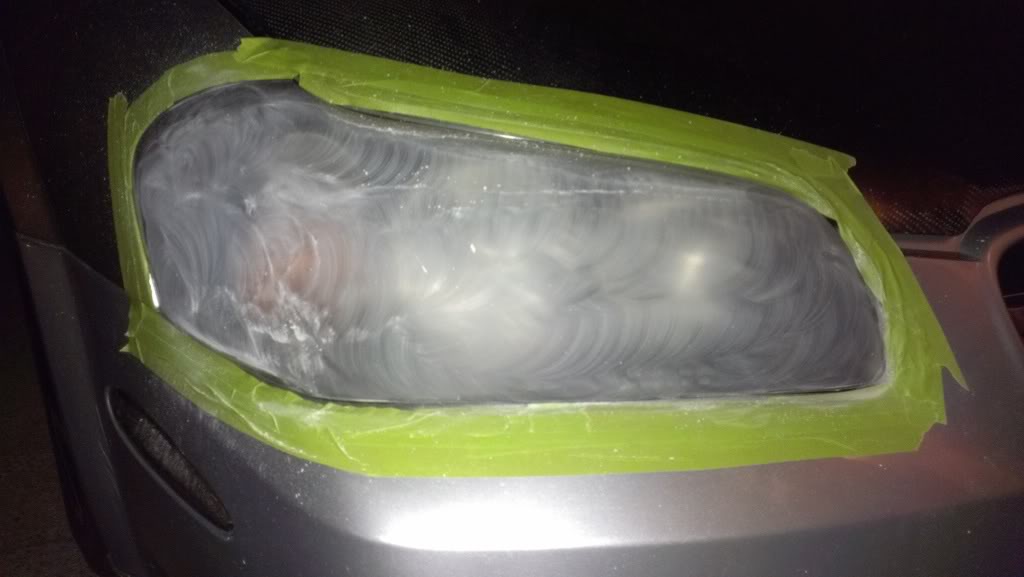

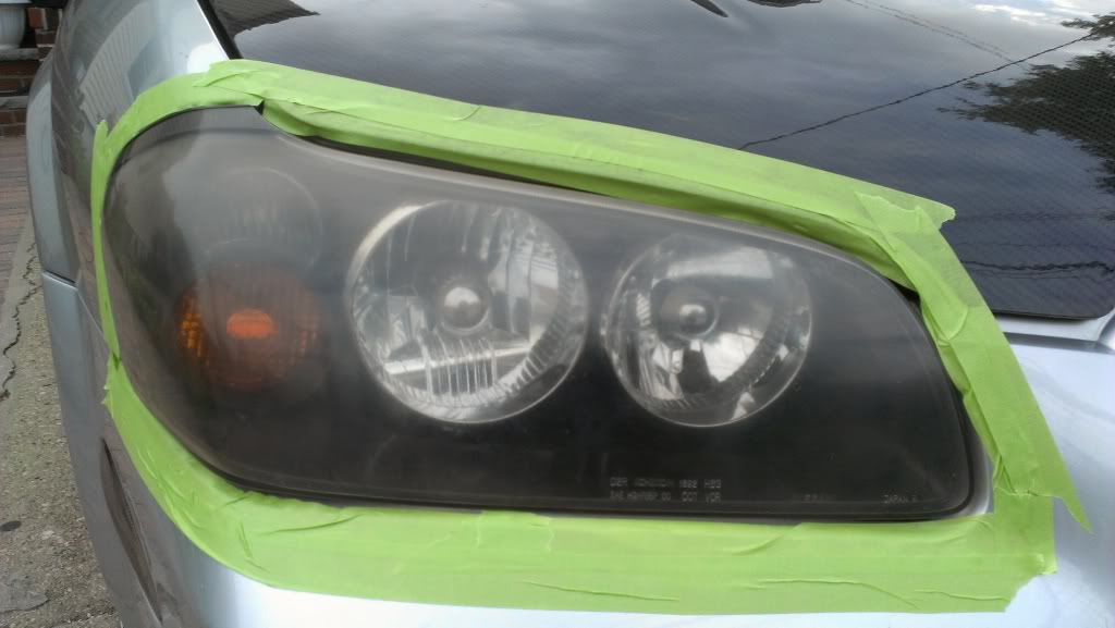

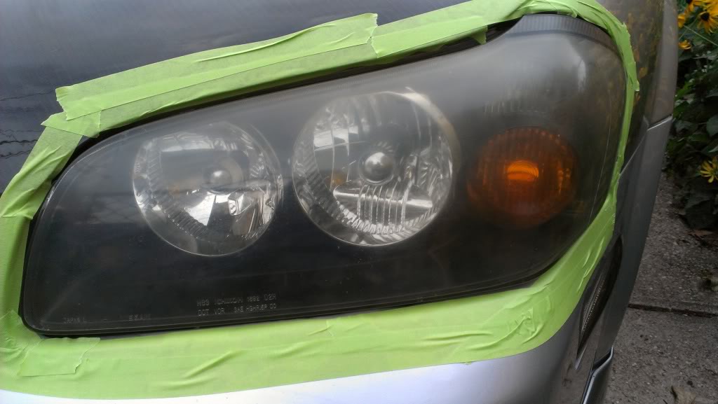

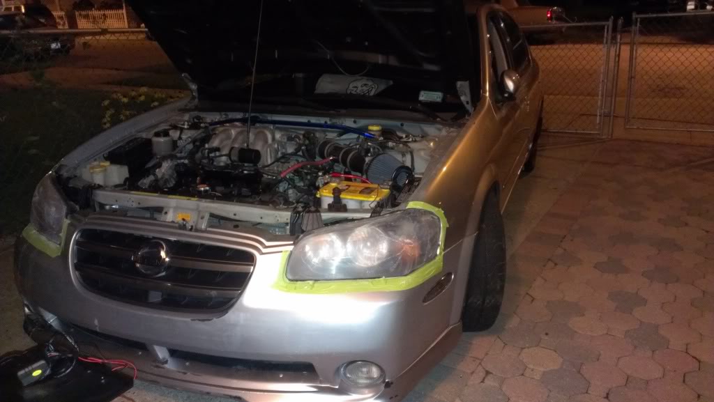

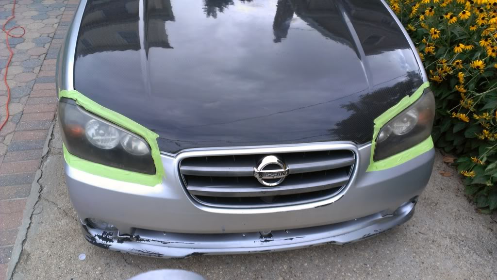

My headlights were cloudy and yellow hazing so i picked up one of those 3m restoration kits from pepboys and tried it out myself, i will let the pictures do the talking.

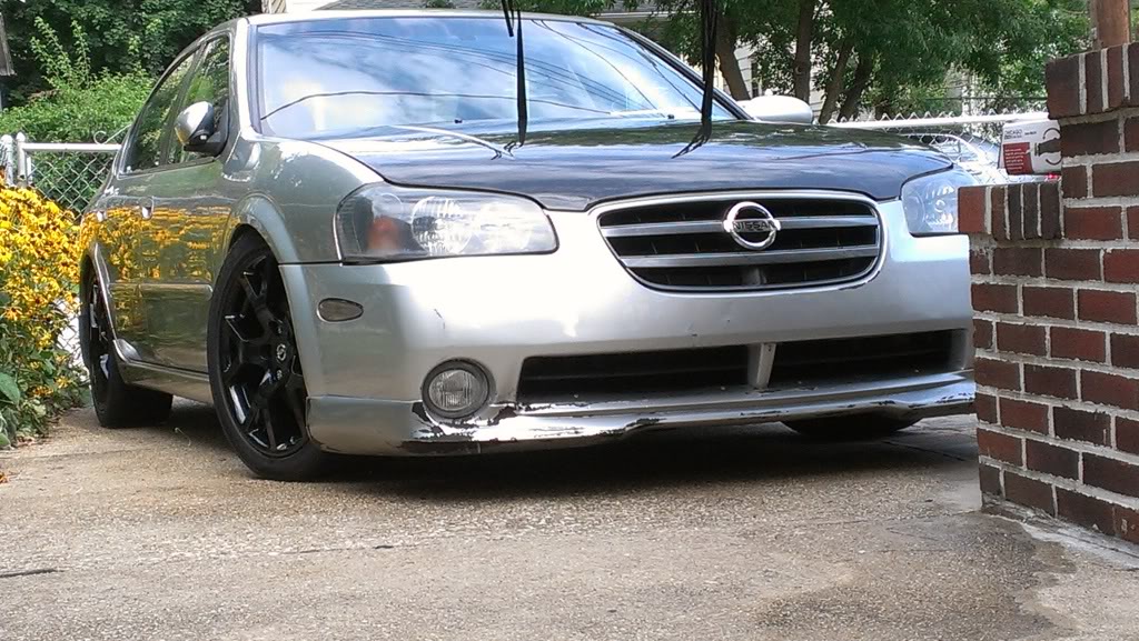

Headlights look great, the carbon fiber hood makes the max really look mean. But the front bumper needs some work. LOL I did the same thing with my headlights on 2005 maxima. Same result, like i said the headlights look brand new.

That 3M does wonders, been busy on the ride I see....

i was honestly skeptical til i read reviews, and even then i wasnt sure but i tried it and i am so happy, but yea bro been real busy did so much! since feb she has been off the road and driveway queen, hopefully next week that can change.

I tired the 3M kit and the results were great. You will need to maintain the headlights since there is no coating. I got lazy and they started getting hazy again. Pick up some Mother's or Meguire's plastic polish.
On my second attempt, I used this kit which has a clear sealant to protect the headlights. Its been a year of maintenance free work and they are still clear.

Headlights came out good btw.

Very nice but believe me it won't last... I mean 6 months before oxidation started to come in again on my headlights and roads in Philly aren't much better lol. Wetsanding is the only way for me now
I also used the Diamondite kit from autogeek

Its way cheaper if you buy the sanding things by themselves and they last longer too. I paid like 25$ for sand paper from 1000-3000 grit, a pretty big bottle of rubbing compound, carnuba wax , towels and i have enough to do the whole car and then some, did the tails, headlights, and took off some scratches.

Just get a kit that has a UV protectant and never worry about them again. I used that one kit, haven't touched them in a year, and they still look great.

The ultimate fix is Lightrite......

recently had great results with a kit from Sylvania, which included a clear coat with UV blockers that was applied as the last step. Cost less than $20.00

once you get the headlights restored the way you want, simply spray 3 or 4 coats of clearcoat and you're good

i wouldnt buff and then clearcoat. you dont wanna trap compound under your clear. and the clear wont bite very well into already polished surface. you need the sandscratches to ensure the clear is durable. the clearcoat itself is what restores them the way you want.

Ive always just sanded them down and sprayed on a quality clear coat 2 or 3 times. Worked well on my dads 5th gen, man those HL housings are terrible

The meguiars kit worked great on my old g35 and those headlights were BAD, it was the kit with the clearcoat sealant included, costs about 20-25 bux at walmart

I use this, spray on let sit for 5-7 minutes and buff off and wipe down with clean Microfiber cloth, **** does wonders I forgot I had it, just another option for people....

If you buff your headlights, you always, ALWAYS need to put some kind of protectant on them afterwards. More of a protectant than just wax, because wax isn't continually UV resistant like paint or another strong protectant is, and the headlights will yellow again in four or five months. On top of this, if you leave the headlights exposed to yellow for too long, not only will the UV protectant on the outside fail, but the protectant on the inside of the lens will as well. Which means...then you'll have to pull your headlights apart to get them clear again.
