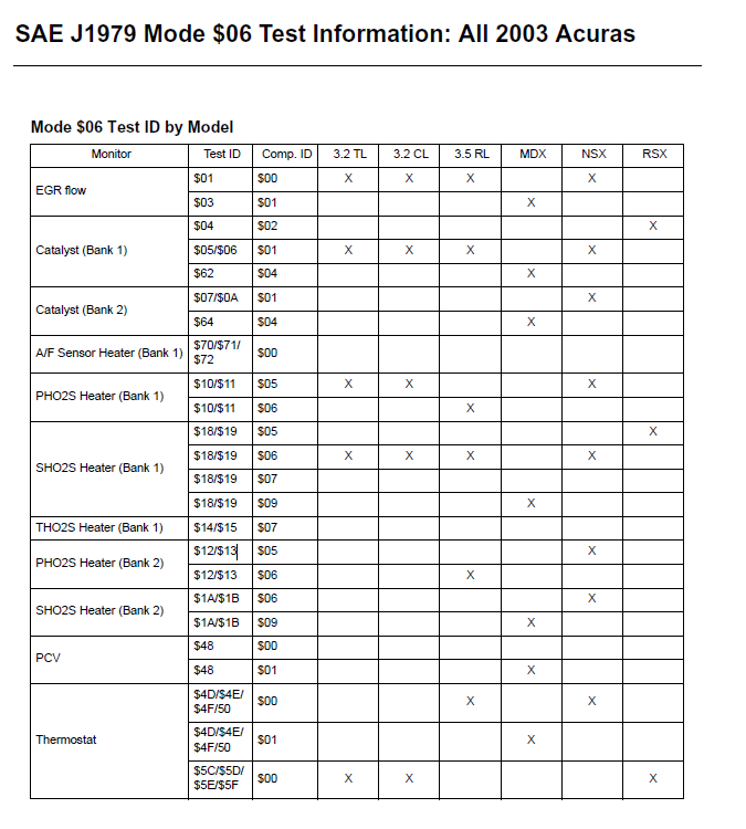

Any ideas where the Test ID / Component ID values can be looked up?
Attached examples for Honda:
And I get comp id $06 / test id $19 - which in Honda lingo is Bank 1 o2 sensor heater.. but I have heard manufacturers can vary the test id assignments
