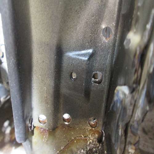

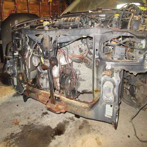

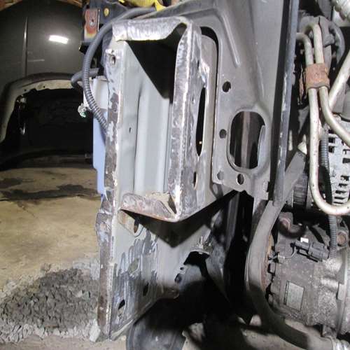

Get a Nissan support. My lock support was also bad i replaced it.And i seam welded the new radiator support completely.(doesn't need to be done)
Untouched picture first one
second, third and forth picture, showing area i drilled spot welds out. And ground with a grinder.
I drill in areas grinder can't get. some people may want to drill out all. I prefer the grinder.
Fourth picture you can see the spot welds they put on the sides.When you drill start with a small bit .and use cutting oil and go slow. After you do that with a small bit step up to a bigger one slightly bigger than the spot weld.

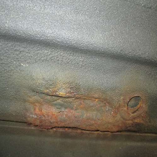

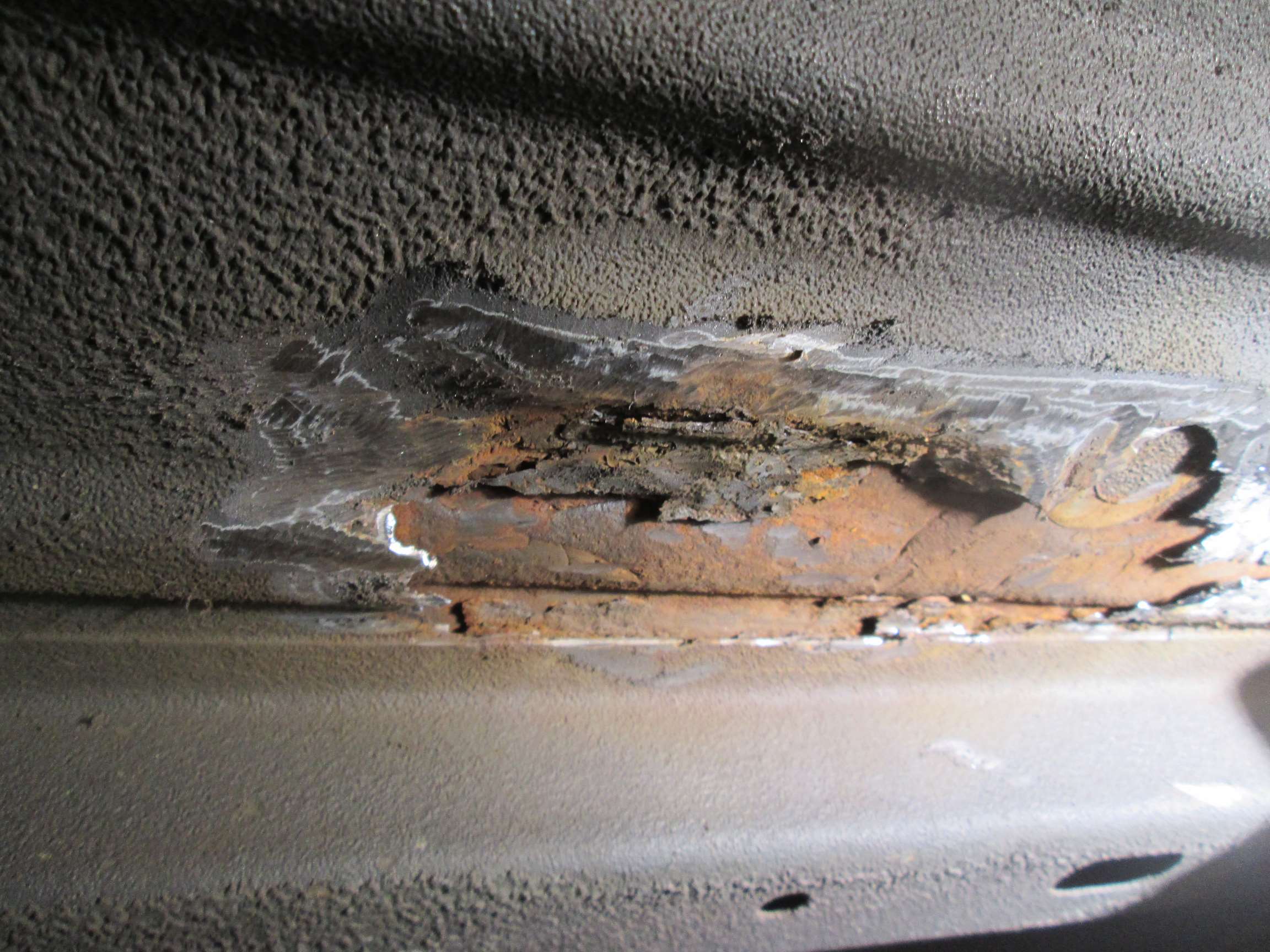

Under body spot (under passenger front seat)
First picture untouched
second picture :clean up with grinder.Metal is gone i believe that is the tar sound deadening .it is the only thing between the outside and the carpet.

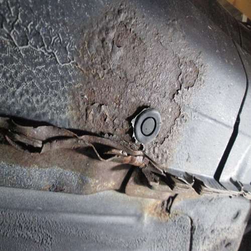

Passenger under front door rocker seam
second picture . I like to use a grinder, to get the loose thick stuff off.
Attached Thumbnails Rust repair thread-img_6087.jpg   Rust repair thread-img_6424.jpg
