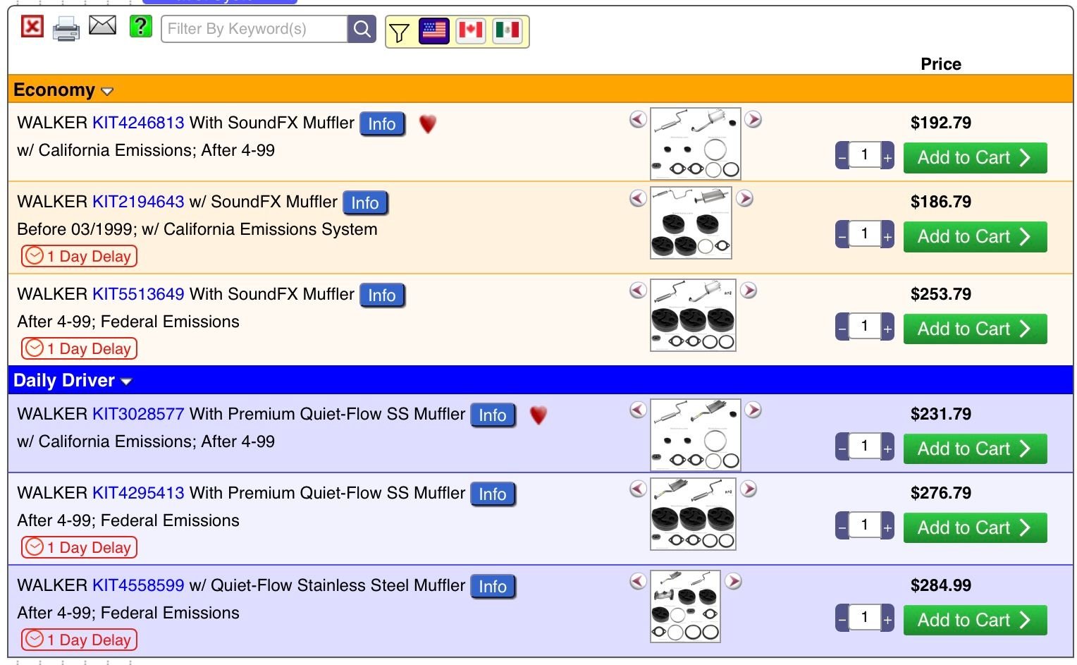

If you’re looking for a stock replacement system, Rock Auto also has system kits.
They don’t list the kit for the ‘98 but these are for the ‘99 which are interchangeable as I recall.
Old Apr 6, 2025 | 08:10 AM
RA030726's Avatar
I'm nutty for Nissans
Posts: 9,311
Judging by the pictures, none of those are a direct swap for a 98. The 2nd one down would need an O2 sensor bung installed.
95, 96, Cali 99, full length B pipe, no O2 bung.
97, 98, Fed 99, S pipe w O2 bung that mates to a shorter B pipe.
95-96, shorter muffler outlet
97-99, longer muffler outlet
