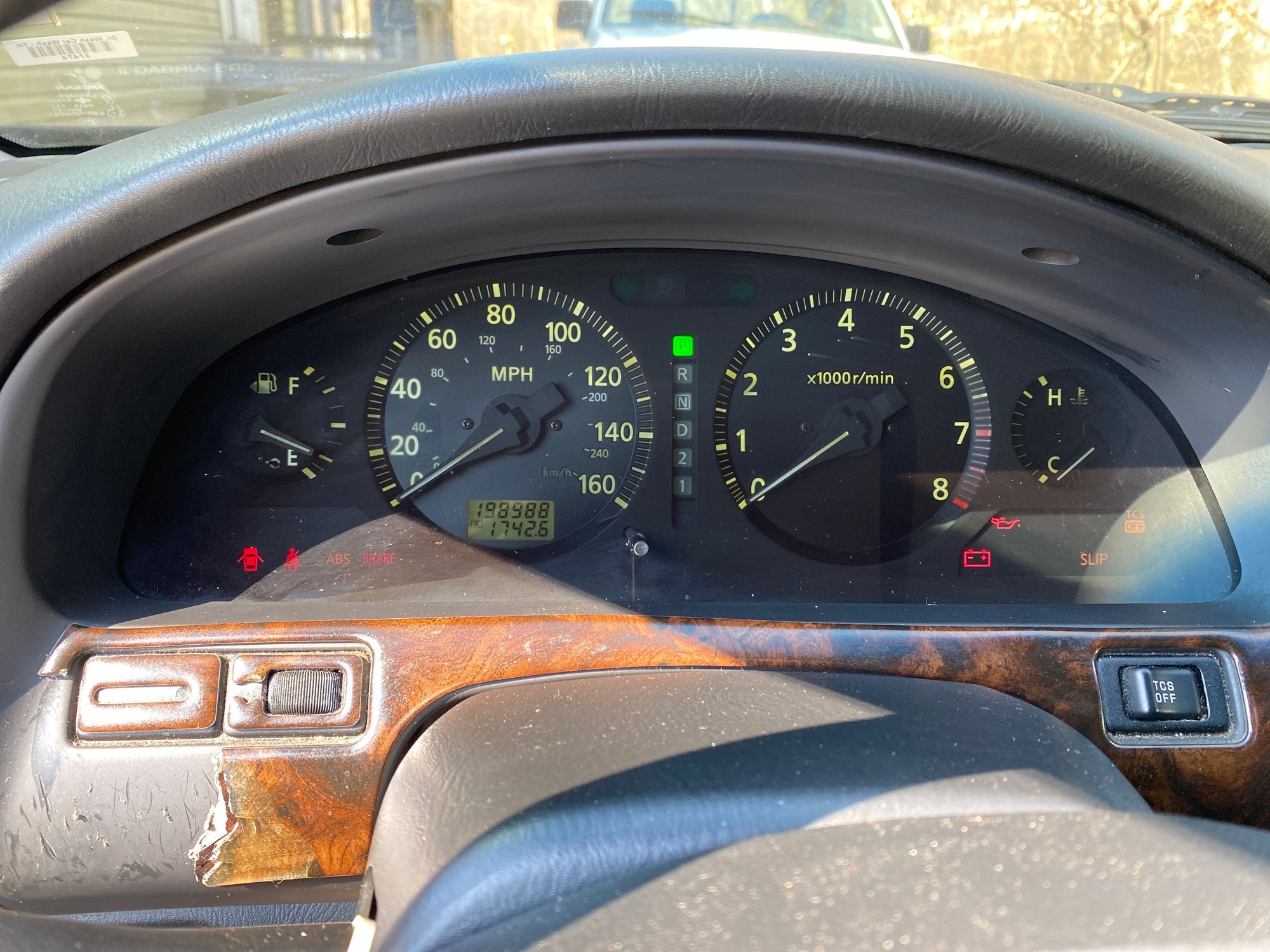

Just picked this up and I want to bring it back to life. Slip and Tcs lights are on, what can be the issue with that? Also needs a good tune up

The OD Flash can Mean a Few things. Scan the trans for Codes. I would also Check Charge Voltage. Make sure the alt and battery are in good health aswell.
I would buy cats and put them back on the car. The 3.5 will just shut down with a glogged cat. I have no recommendation other than to Not gut them. Its not a bad job to do. What is most important though is that the engine is in good running condition first.

the lights being on could be many different things, could be as simple as a bad speed sensor could be the ABS module fried, you need to diagnose it (use a haynes manual) or bring it to a good mechanic
the low power issue could also be different things, what comes to mind right away is a bad/weak fuel pump or clogged/dirty fuel filter or fuel lines, could be a dirty/clogged air filter, some really basic stuff you need to check
did you take apart the throttle body and clean it ?
