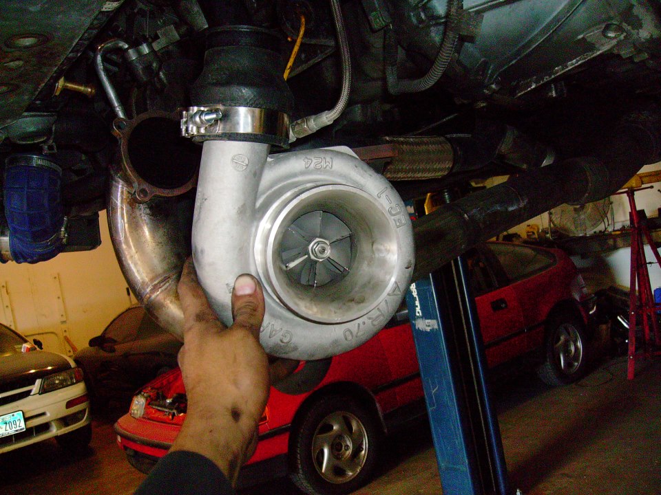

Where it currently sits at the shop. Getting exhaust leak fixed.
Turbo, downpipe and manifold had to come down.

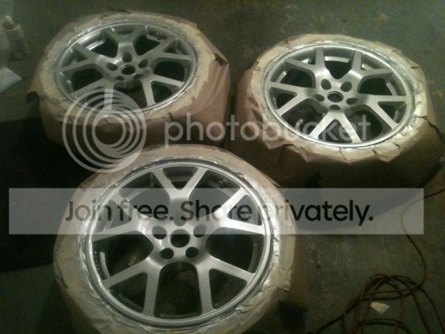

A little sneak peak of what's going on in the laboratory... Left them drying up overnight, throwing them on tomorrow.
These look great! What color did your buddy use for the wheels? I need to refinish my stock SE wheels bad.
It was one of the lighter silver wheel paint I found at autozone.

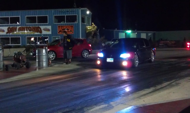

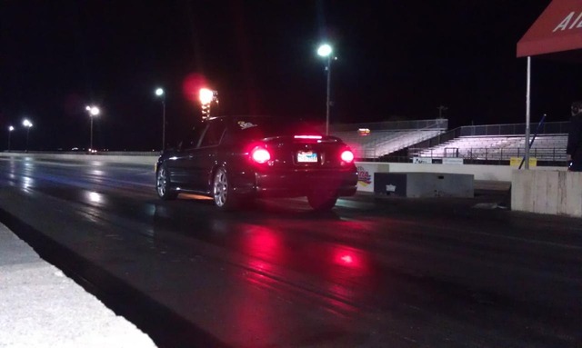

Decided to take the ride out to the track for some fun. The car is currently running off the wastegate at 2psi, untuned. Couldnt get a good launch to save my life. The best pass was 14.1 at 102mph, with a 60 ft of 2.40.

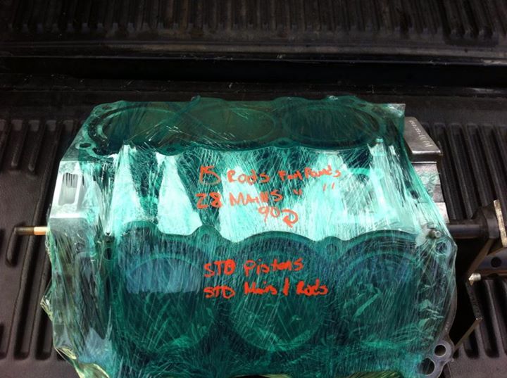

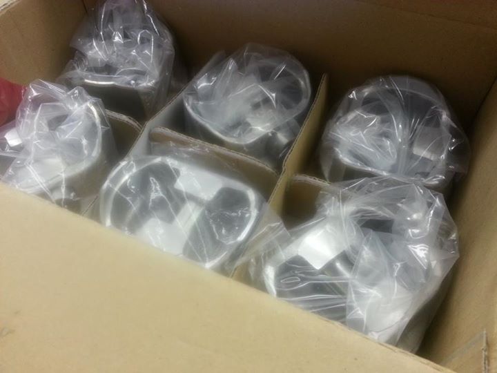

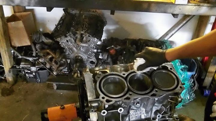

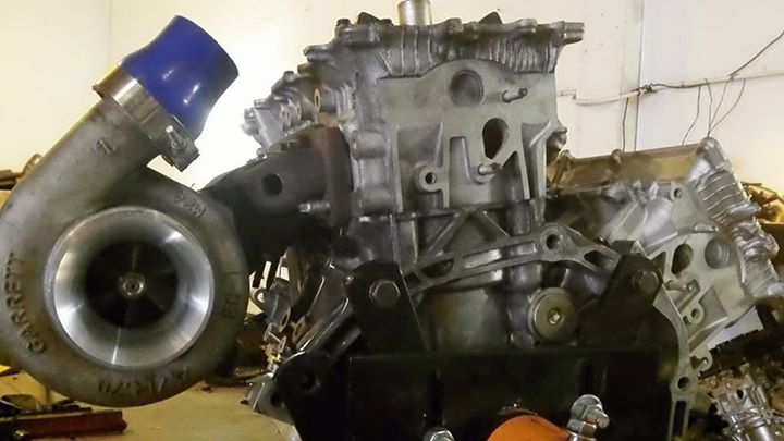

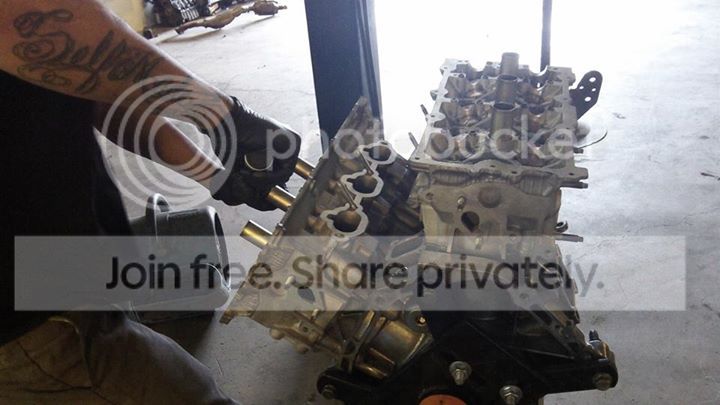

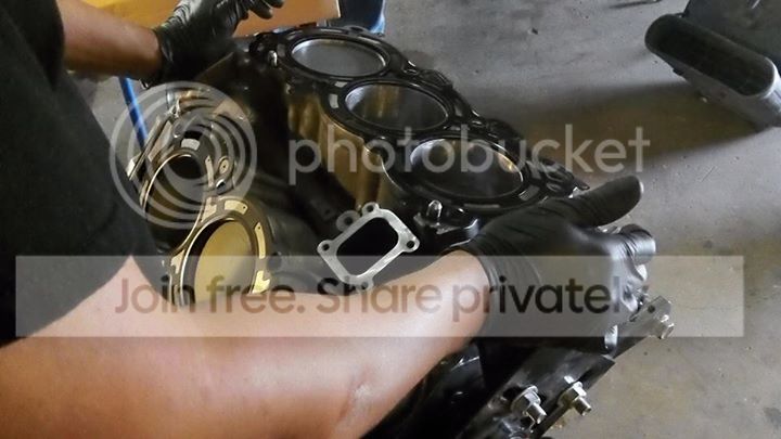

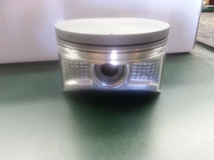

I have not updated this thread in forever. I was able to take the car to TX2K13. The car ran great. Unfortunately, a few weeks later the motor went kaboom while giving a C5 the business. Well it didn't really go kaboom, I had a small stress fracture to piston number 1. I had the block honed, purchased a set of standard size pistons, micro-polished, installed new race bearings, had the head resurfaced and installed new valves and valve seals.
Here is a few pics of the progress.

On the way back from the machine shop.

Assembling time.
Almost done.

Also replaced/installed:
- Timing chain
- Timing chain guides
- Water pump
- Installed AEM digital boost controller
- Installed AEM UEGO wideband
