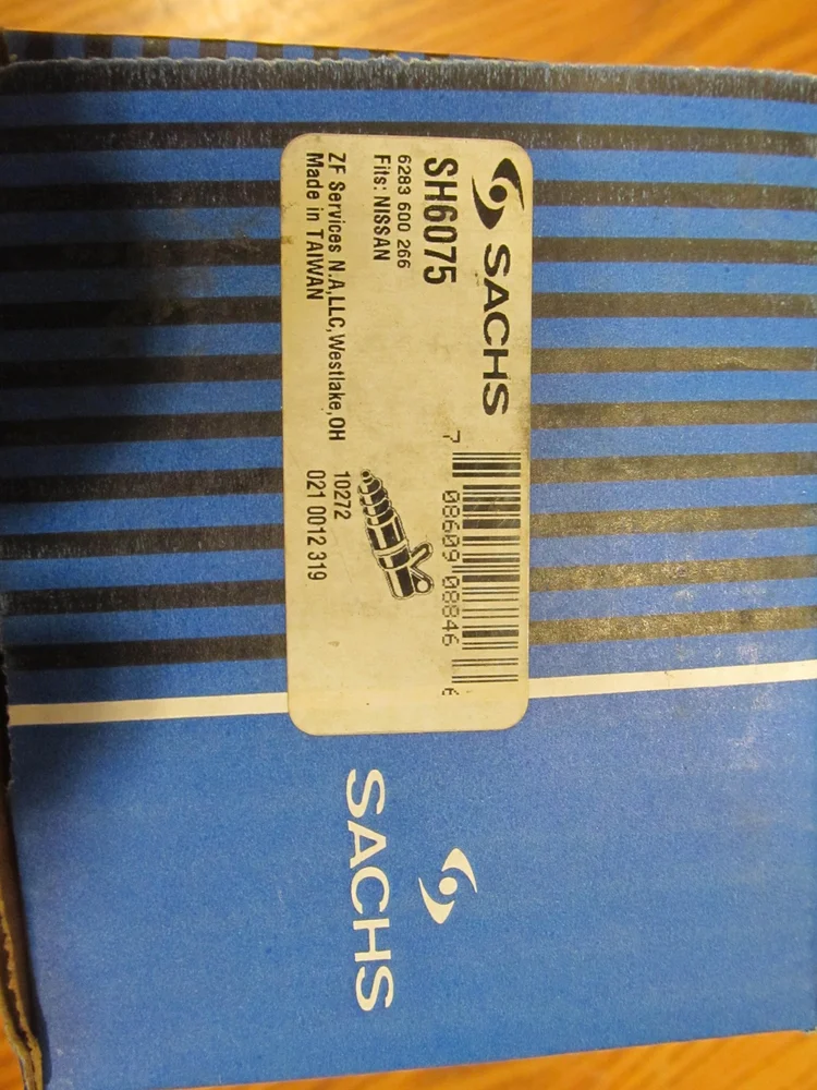

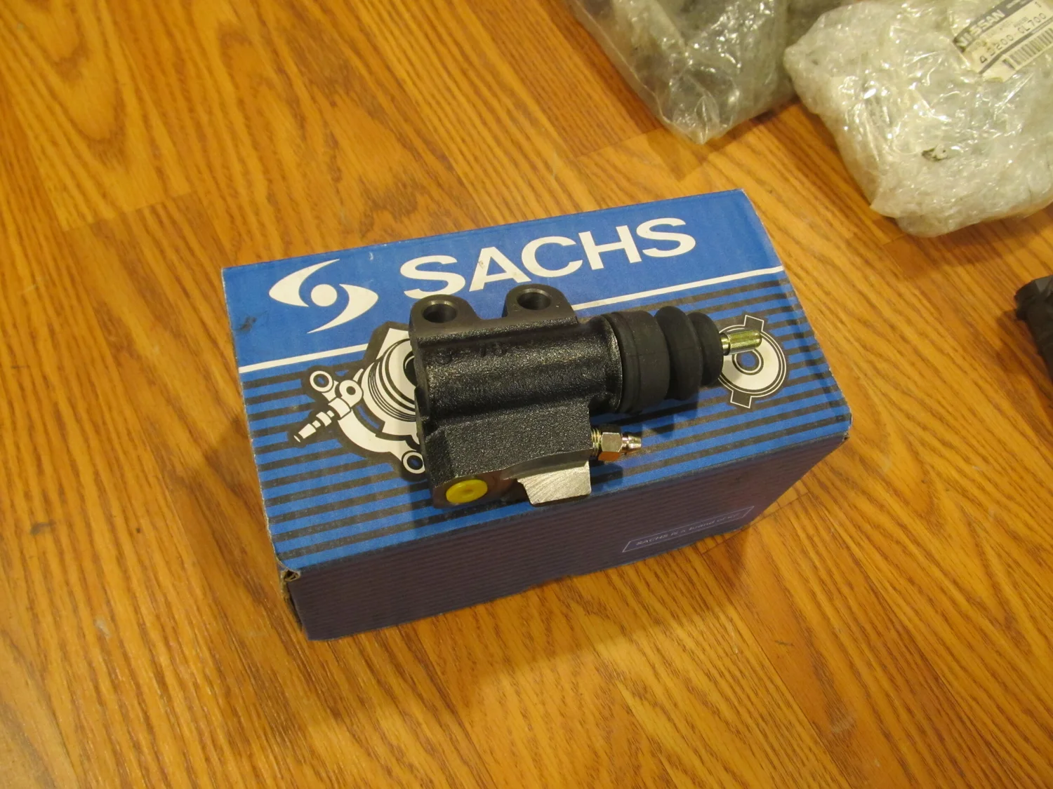

Brand new in box Sachs clutch slave cylinder:
Not sure why this pic got turned sideways

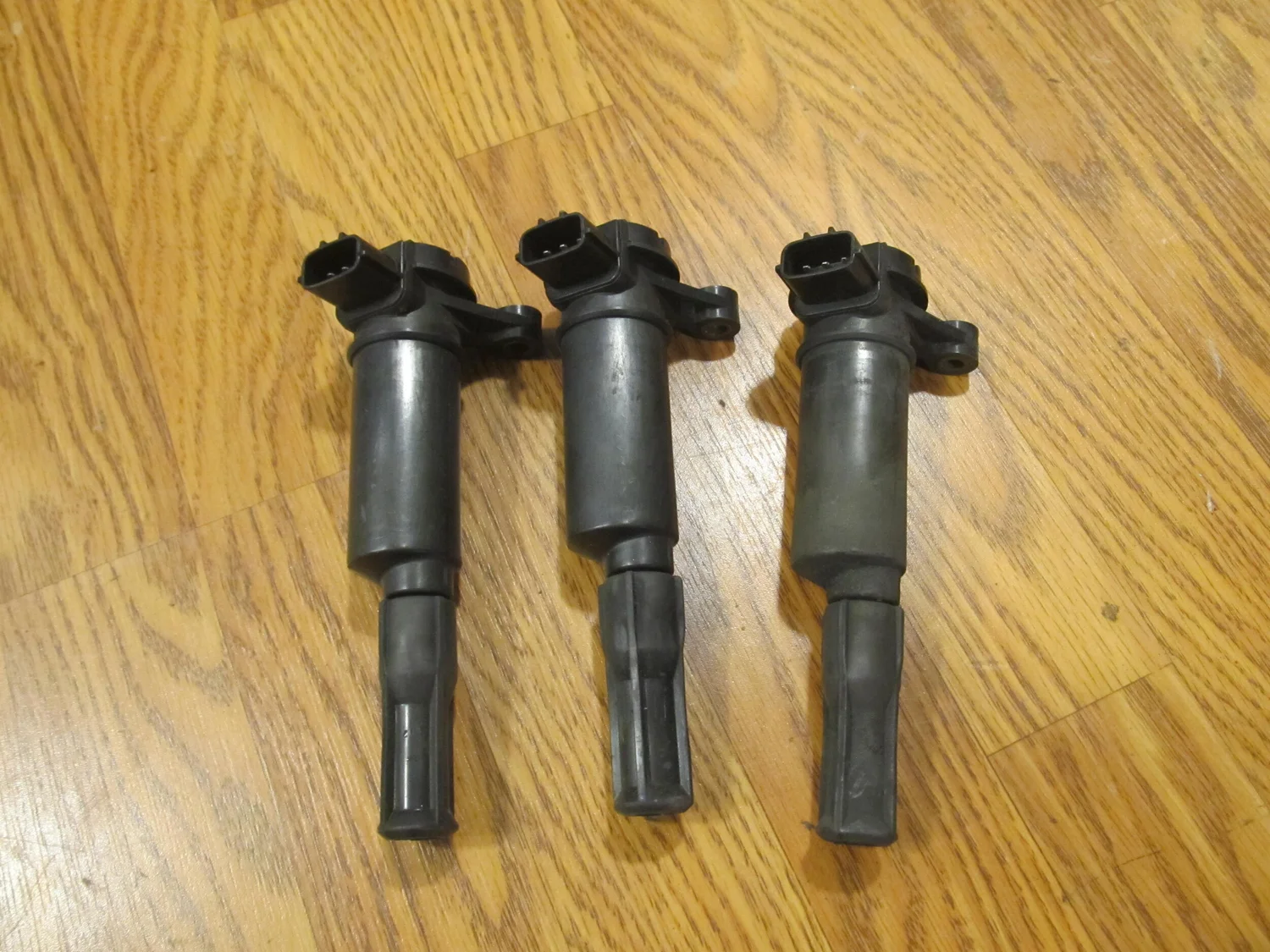

Used front coil packs

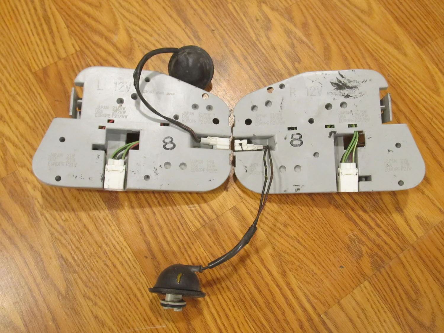

Used tail light boards

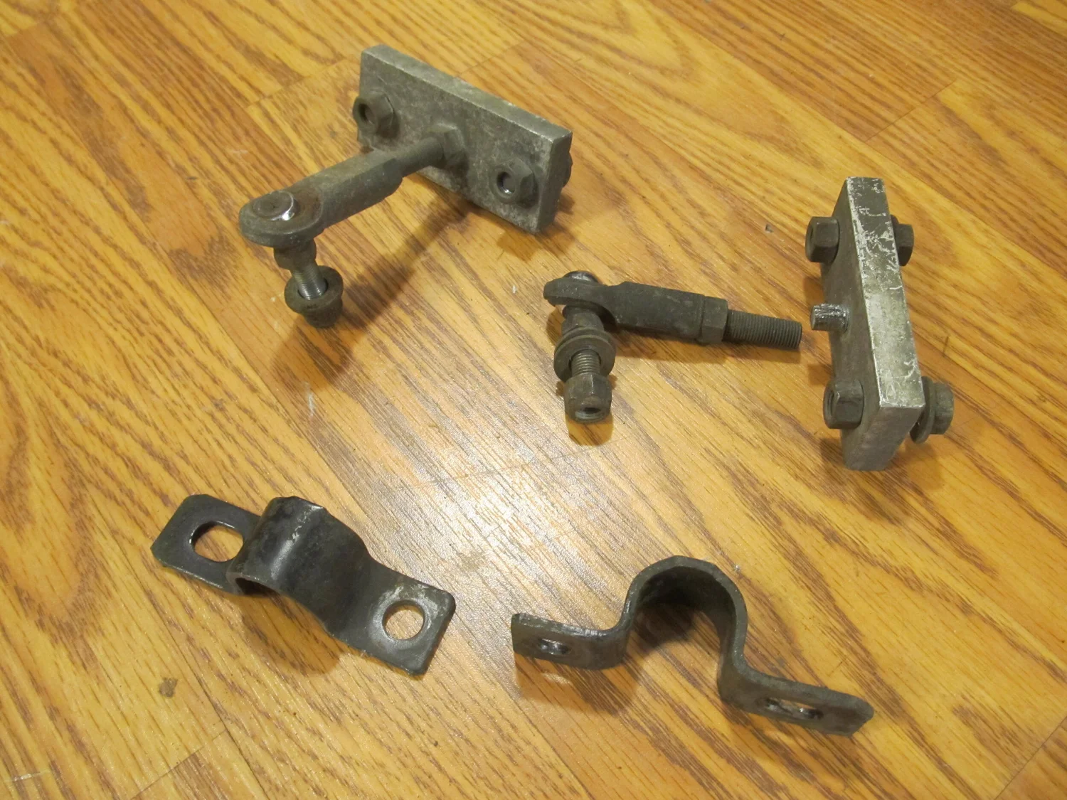

Rear sway bars end link kit, one broken bolts (not sure on specifics, aftermarket/custom parts)
