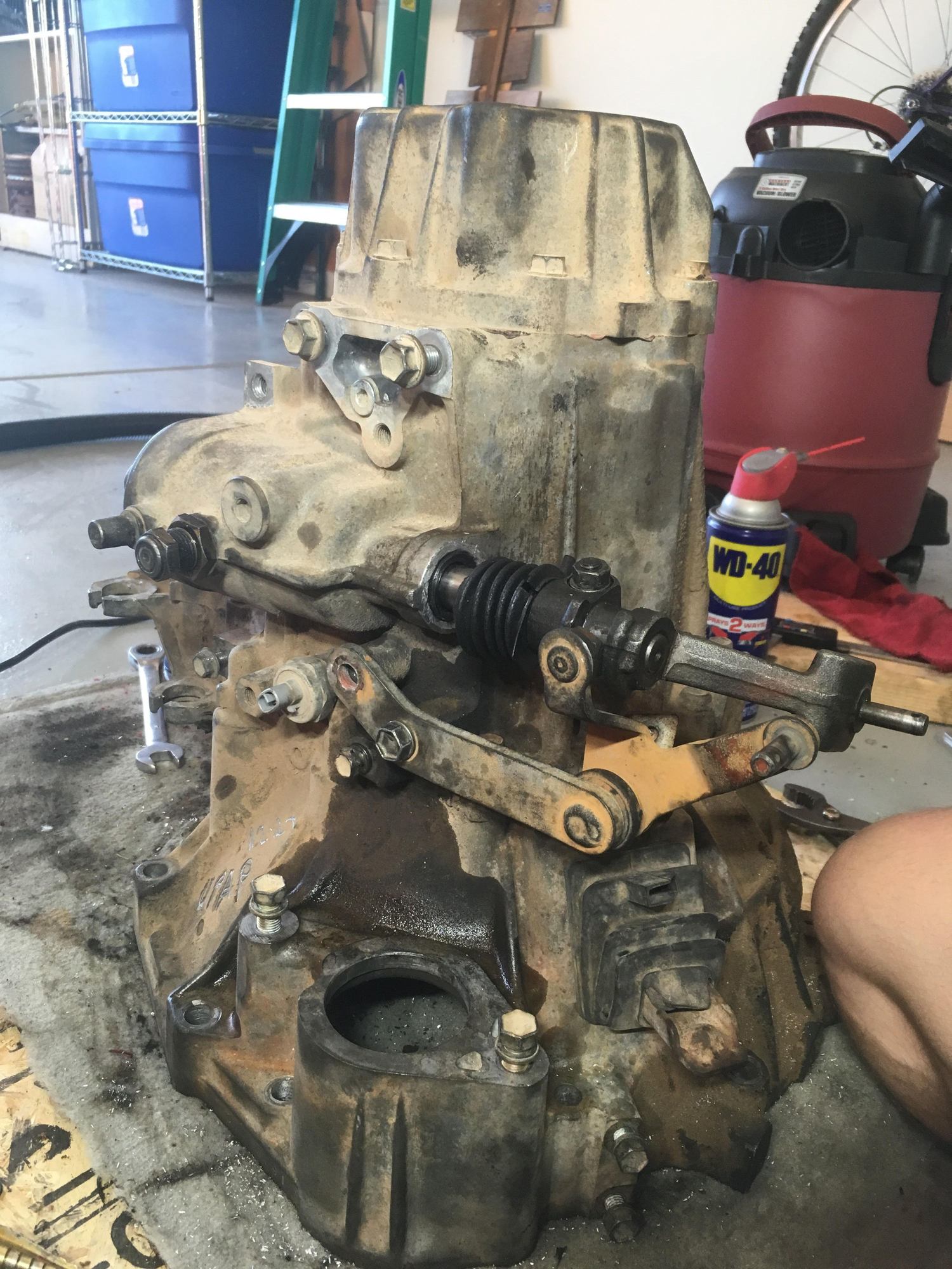

The car has 186k miles now, and I've only put on about 200 miles since May. At this point 2nd and 3rd gear would give a nice little thunk/grind when shifting at high RPM.
So I pulled out the stock S54 trans and replaced it with a 1994 Camry S51 trans. The '94 trans has similar 1-3rd gears (with upgraded synchros) and 4/5th are geared taller for camry fuel economy. I had to drill out the transmission case to swap over the S54 shift assembly in order to use the FWD trans in a mid engine layout.
Left: S54 Right: S51
3D Printed Jig to drill S51 case for S54 Shift linkage.
S51 with S54 Shift Linkage
