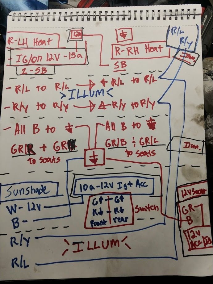

Welp while I wait on parts to arrive for mah FIF gen, motor swap, I stabbed the old FIF gen motor in another one of my cars to get on the ball on having that other car move under it's own power soon..... But we're here to talk about mah SIFF gen(s).
Started with stripping the elite interior out of mah 04.
Then well install is reverse of removal right? Well ran into a problem already, my 08 and 04 are bose but the rear speakers are COMPLETELY different, while both being 6x9s they are just... different. I had to make a slight modification to my rear deck speakers to get the sunshade to sit properly as pictured below.
-Just flattening one of the sides to allow more clearance for the sunshade, it's more obvious when you're doing it yourself, I just have not had anyone say anything about this, maybe because I'm going from 04 to 08, idk.
Anywho, I got the rear package tray all squared away and now before I put the rear console in I have to attack wiring
And because I love you guys here is my gibberish of a wiring diagram!!!!! If it doesn't make sense then well go look at a FSM
I have to run to the electronics store later today to finish wiring some things, going to run 2 different power wires from the front as listed above also I need more bolt anchor thingies to make grounds also the wire tap thingies to tap into the illumination circuit.

The wiring went like a breeze, I did not take a picture because I was not in the mood to make it pretty for the internet, however I have 100% confidence in my wiring job, unless the cabin gets filled up with water, but then I'd have other problems....
I like to use a fresh source for my 12v sources & grounds whenever I'm doing stuff like this. In this case I used those handle add-a-circuit thingies that go into your fusebox, real handy, real easy, I kept it OEM and reused the sunshade fuse for.... The sunshade.... And I used a blank spot for the Rear cig lighter and heated seats. I wired everything as I drawn out in the previous post and surprise surprise.... all switches work perfectly. There is a video on youtube of someone attempting wiring.... And well.... I am quite unsure what that guy is doing in the video.... Anywho after following my wiring gibberish chart and running a few wires from the front console (Illumination wires, and running the 12v around and downnn)...... We have working rear heated seats, sunshade and 12v plug!

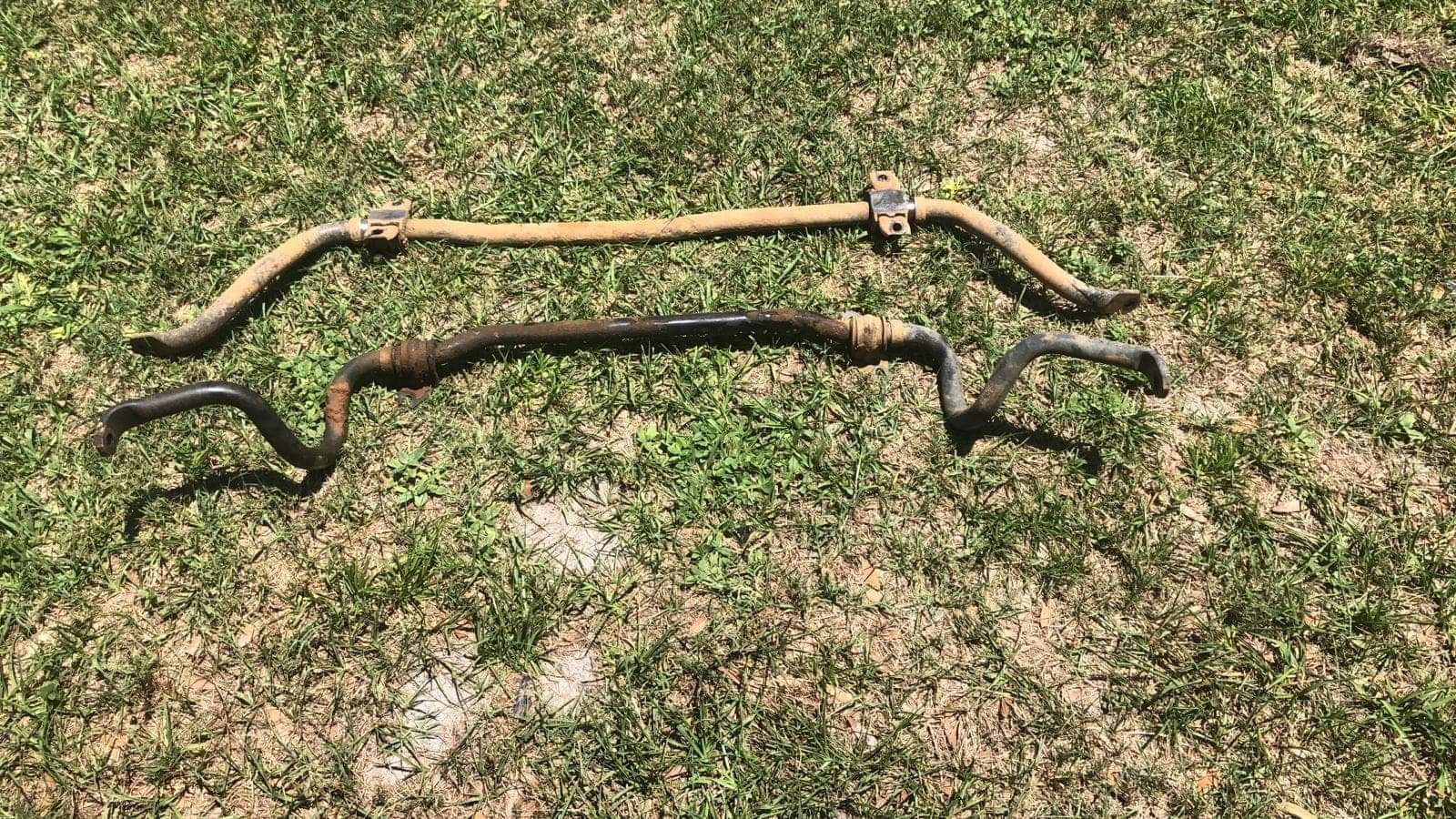

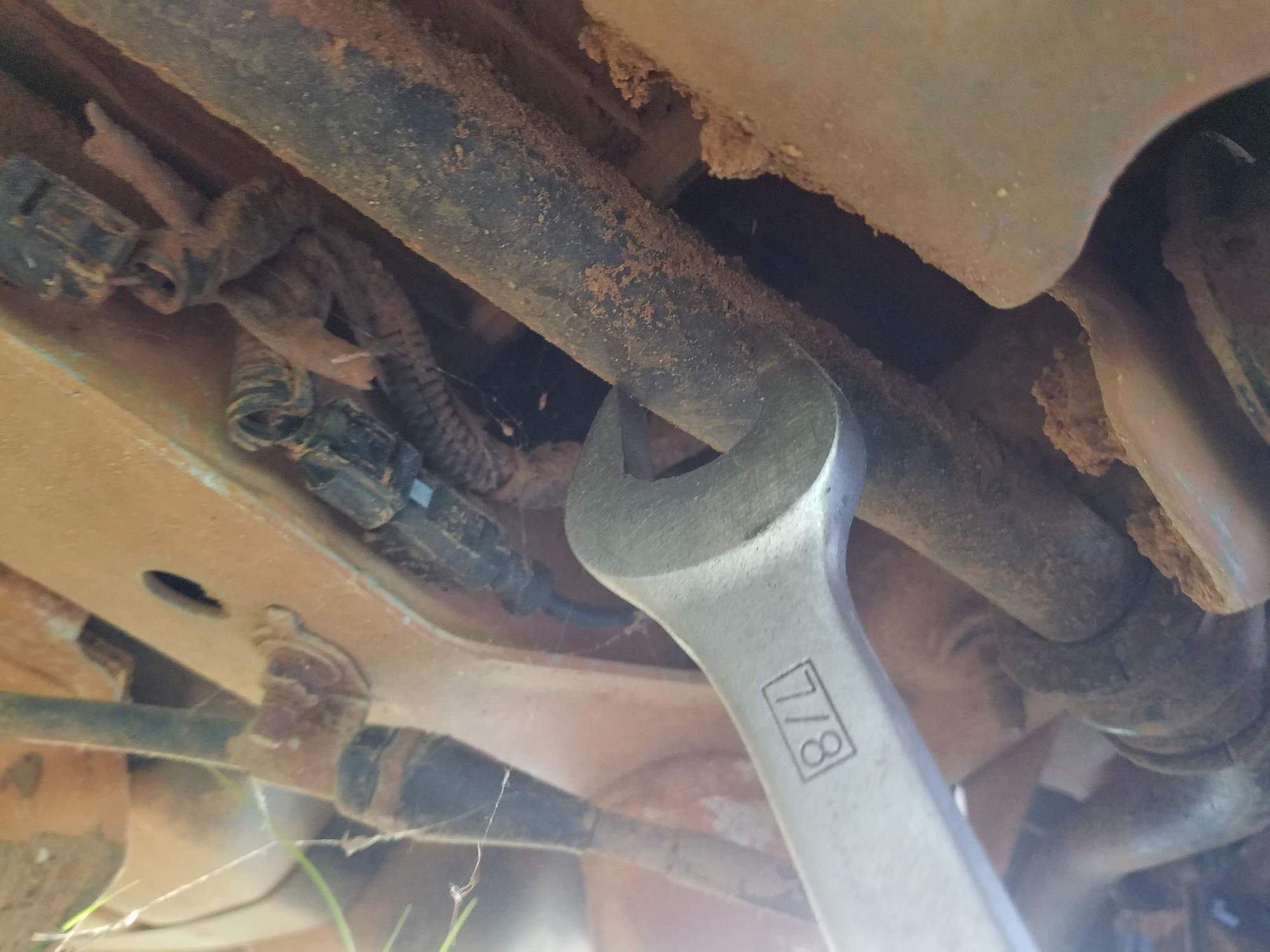

Ugh. Just found out i35s and Maximas have different ABS sensors.
Master Cyls you say? 23.81mm cylinder (most maximas) vs. 25.4mm cylinder (V35 / Z33 non brembo), not the full 27mm cylinder the brembo models are but the Akebono vehicles are 25.4mm cylinders with the same brake booster specs soooo it should work nice and stock, eh? eh?

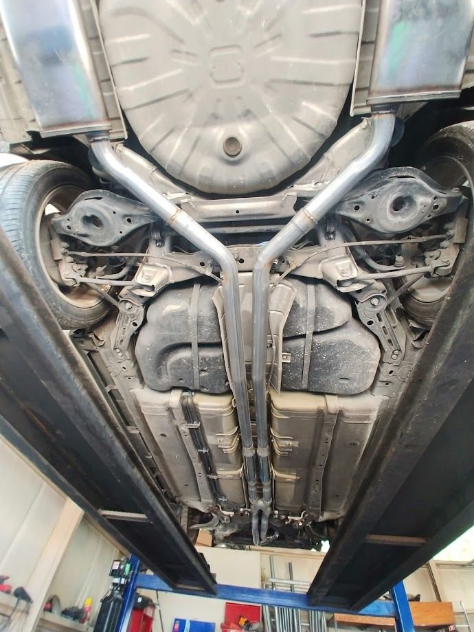

True Dual Exhaust Version 1
Yes, read the title, version 1, I have to actually swap in the 2nd gen motor before I start making changes but at least the basic idea has been laid.
Full Exhaust Specs:
-2.5" Crush Bend piping
-$97 Ebay altima headers (BTW I need to do a thread on these, these are NOT the bolt on cheap option for us, the DNA Motoring $150ish option is the bolt on option for 6mt/4at vehicles, and no there really isn't a difference on flange thickness or piping diameter, I have the more expensive SRS ones too and with a digital caliper tool you will NOT be able to spot the difference).
-Last minute decision to go with a stamped X-pipe, it was cheaper than fab time for an H pipe (This is definitely one of those things that will get shuffled out as time goes on)
-Yonaka 20" 2.5" in/out resonators - These are the smallest OD resonators I have found Measuring @ 3.5" OD Anything larger, imo, would require the heat shields to be removed and some hammer time on the chassis to get decent clearance to not have any issues w/ vibrations.
-Jones Max Flow 2.5 mufflers (offset inlet, center outlet) - MF1256 - 18" length body, you really can't stuff anything longer than 18", you can do 20" but the muffler body would have to become really good friends w/ the rear bumper cover.
-Black Horse Racing dual 3.5" exhaust tips, cheap af.
I think this exhaust cost me under $600 total. Can probably be under $650 total if I thought this was going to be my final setup, but this is just the first version.
The car has a misfire and in my opinion the sound will probably change once everything is running well... but I KNOW you're going to ask for it so here it is, misfire and all. First run on the street.
If the misfire is something basic like a coil pack I'll attend to it and retry making a video, if it requires anything else.... Then it's not gonna get fixed.
My opinion? It's not as quiet as I envisioned.... But I do like it.... A lot.... I like the random moments moving around my shop when it's not missing it's *** off, and 1st and 2nd was spinning w/ only 5 cylinders so the car is actually very happy with it.

SE-R front & rear sway bars!
This is not a new discovery at all, but I had recently learned about this mod Monday and I am glad I had managed to get them while I was super motivated to get my hands on them before I swap motors.
I can't believe I had sourced these after only one long night of messaging ppl and crawling fb groups till 6am!
24mm front and 27mm rear sway bars (vs 22mm front and rear) are on thier way towards me!
7/8ths (basically 22mm) wrench attempting to go over SE-R front and rear sway bars. To show a visual comparison.
And here they are, awaiting packaging and then I will wait patiently until I get the chance to install them next month or so when I put the 2nd gen motor in the car.
I may or may not be too excited for sway bars. I'd like to see any other gen have FRONT and rear upgrades 🧐

Full Exhaust Specs:
https://youtu.be/lp1txjx9KXg
It's pretty nice exhaust Aaron, but I noticed that there's no flex couplings nor cats in your exhaust system...I also would have used even longer 4" resonators and staggered them that's just me being CMAX. I love big Muffler and resonators I use 22" long mufflers on 3rd, 4th and 5th Gen so I know less tip means more muffler in your case. I'm a Magnaflow guy due to their seamless internal design and enhanced flow characteristics. I'm not into welding in too many locations cause it increases internal exhaust turbulence which in turn directly reduces torque and hp. Great shopping list Aaron those headers are gonna be the option most of us need to use when adding headers to a car. Very creative choice and design Aaron...
