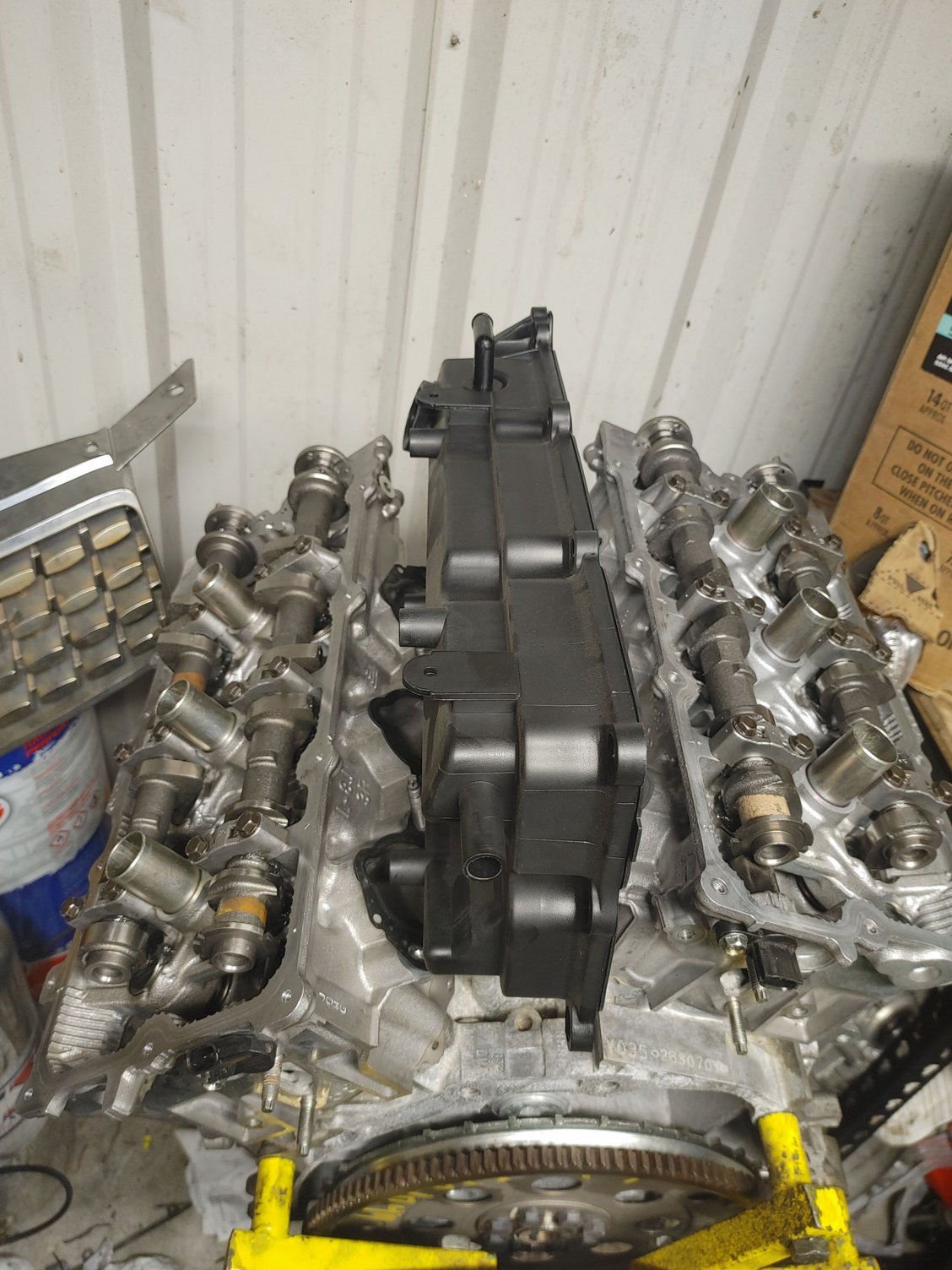

Forgot to drop some pictures here.
Torqued everything down up to the cams
Decided to do something else on the timing cover, Button Head bolts, I didn't wanna spend $200 on bolts but $36 will do and it looks different but not gaudy/attention grabbing.
More updates after I RTV things down tomorrow.

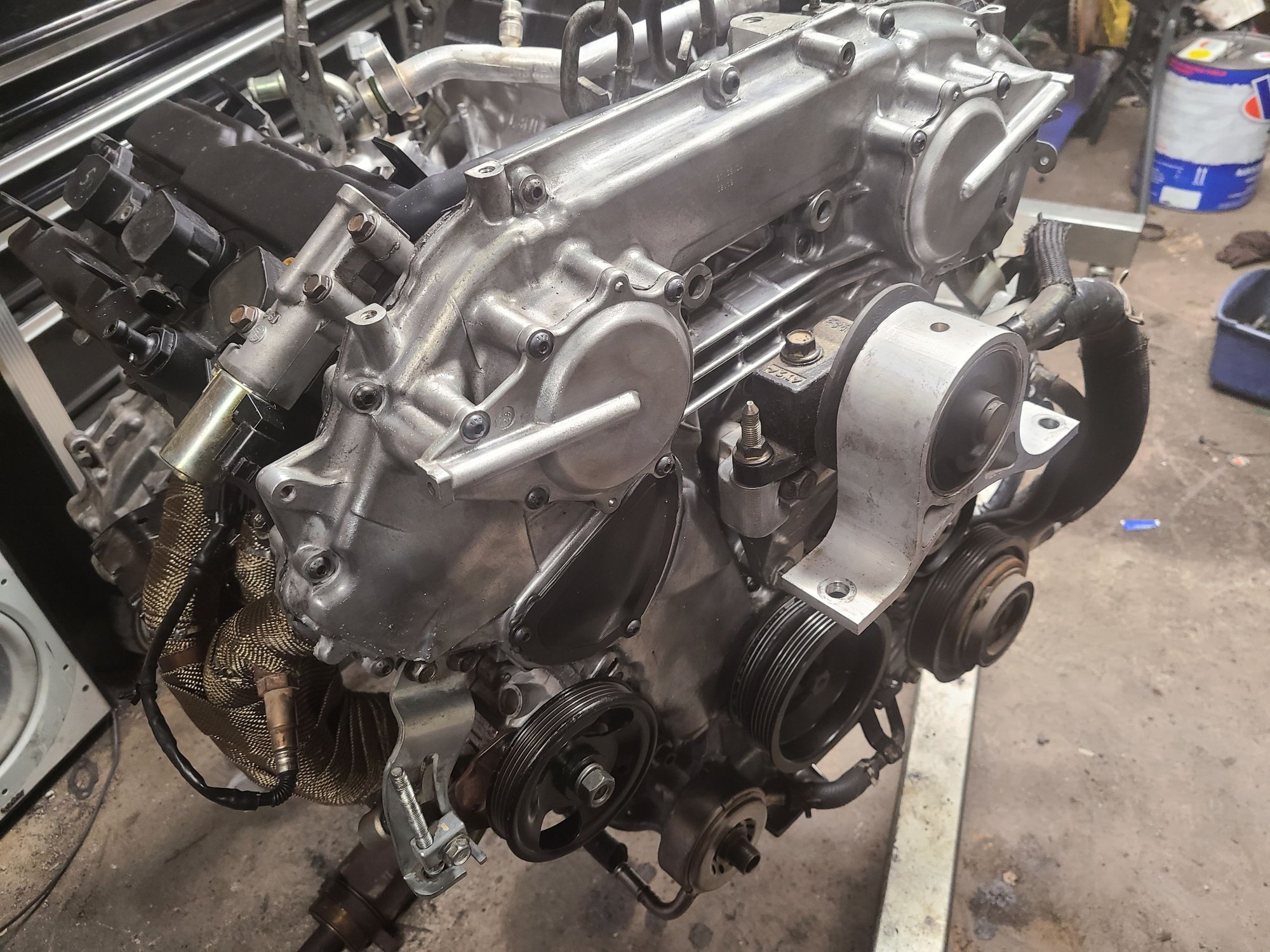

After some struggles with parts. I can finally say i am ready to drop in the new powertrain.

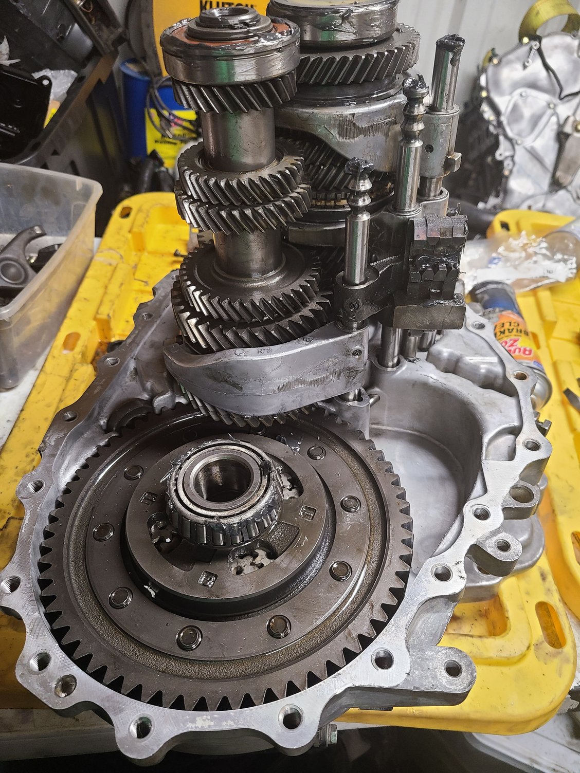

I have decided to go with the 02 spec-v transmission gearset as is.
The super short first gear will help the heavier chassis get moving and longer 3rd gear will have me trap in the 1/4 in 3rd instead of 4th.
Anywho enjoy a picture dump.
-Concept Z's stage 3 racing clutch mated to a z1 motosports mid-weight flywheel.
-02 Spec-V internals transferred into a v6 donor transmission.

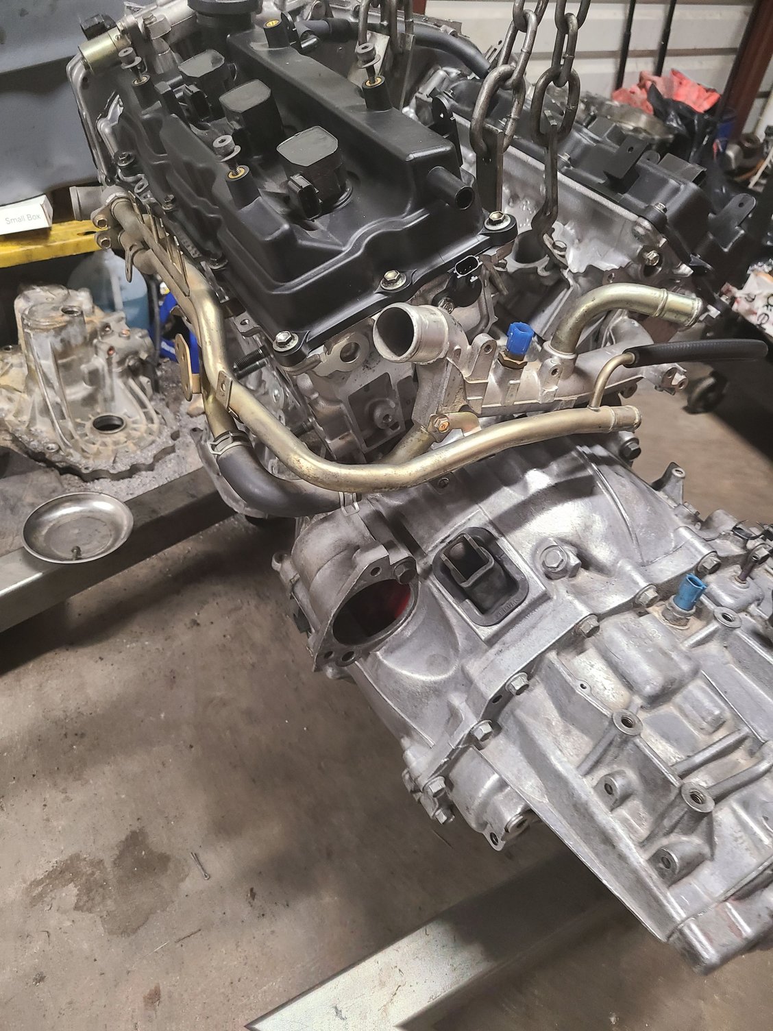

-the powertrain assembled, ready to be transplanted.

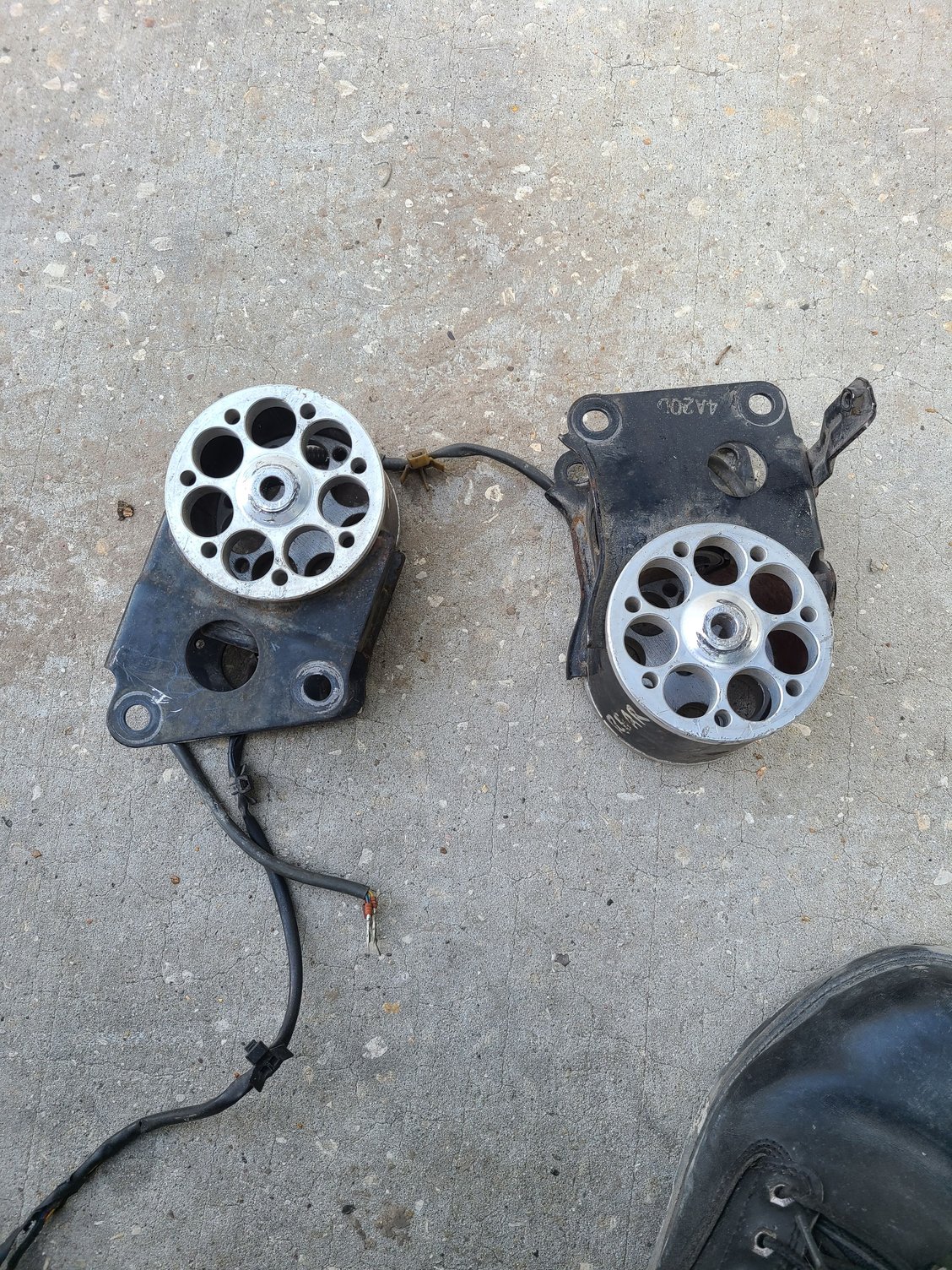

Oh i forgot to include a pic of my stock motor mounts.

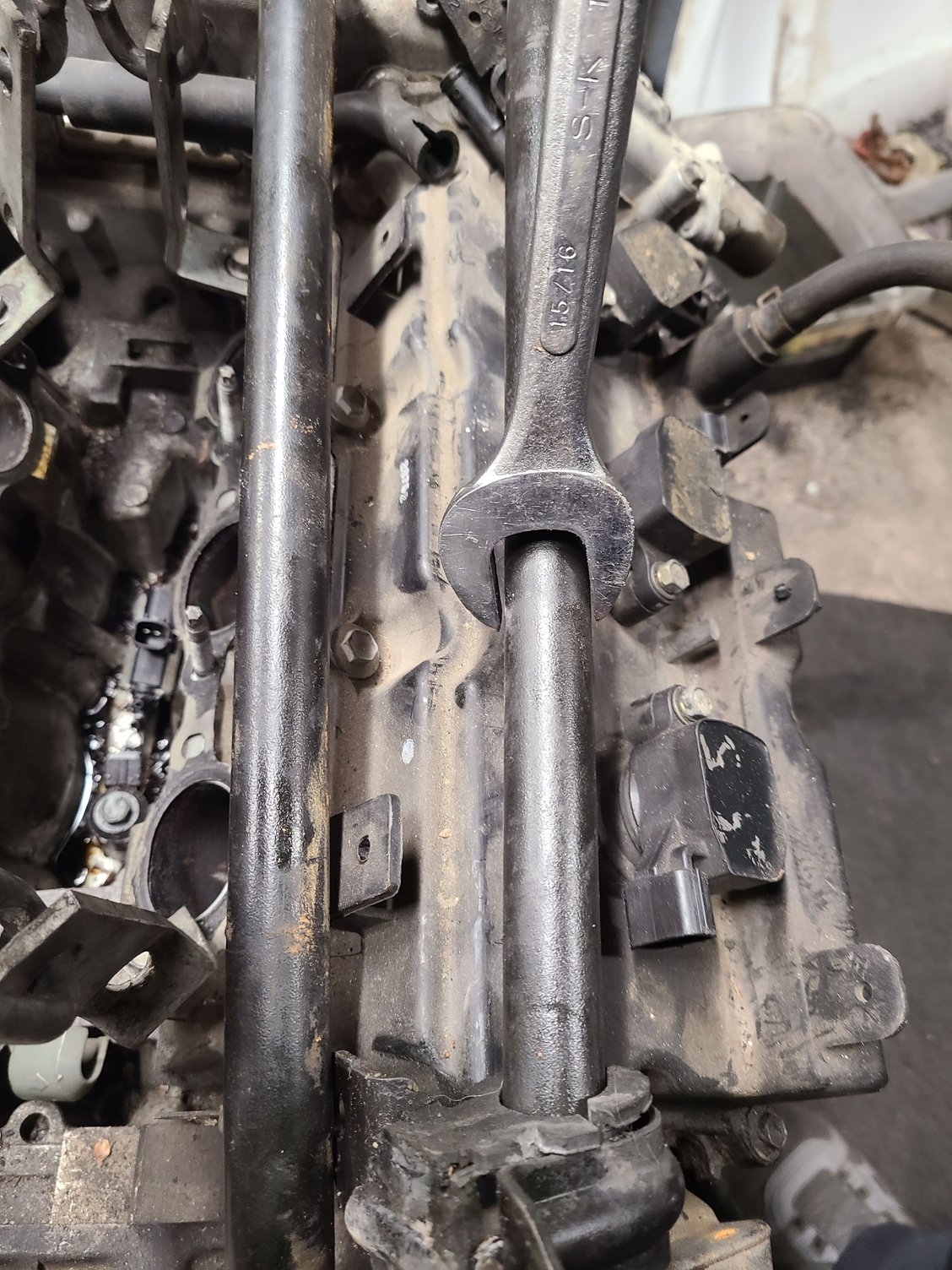

Update? Sure.
Photos of the mayhem.
Cleaned the engine bay up some....

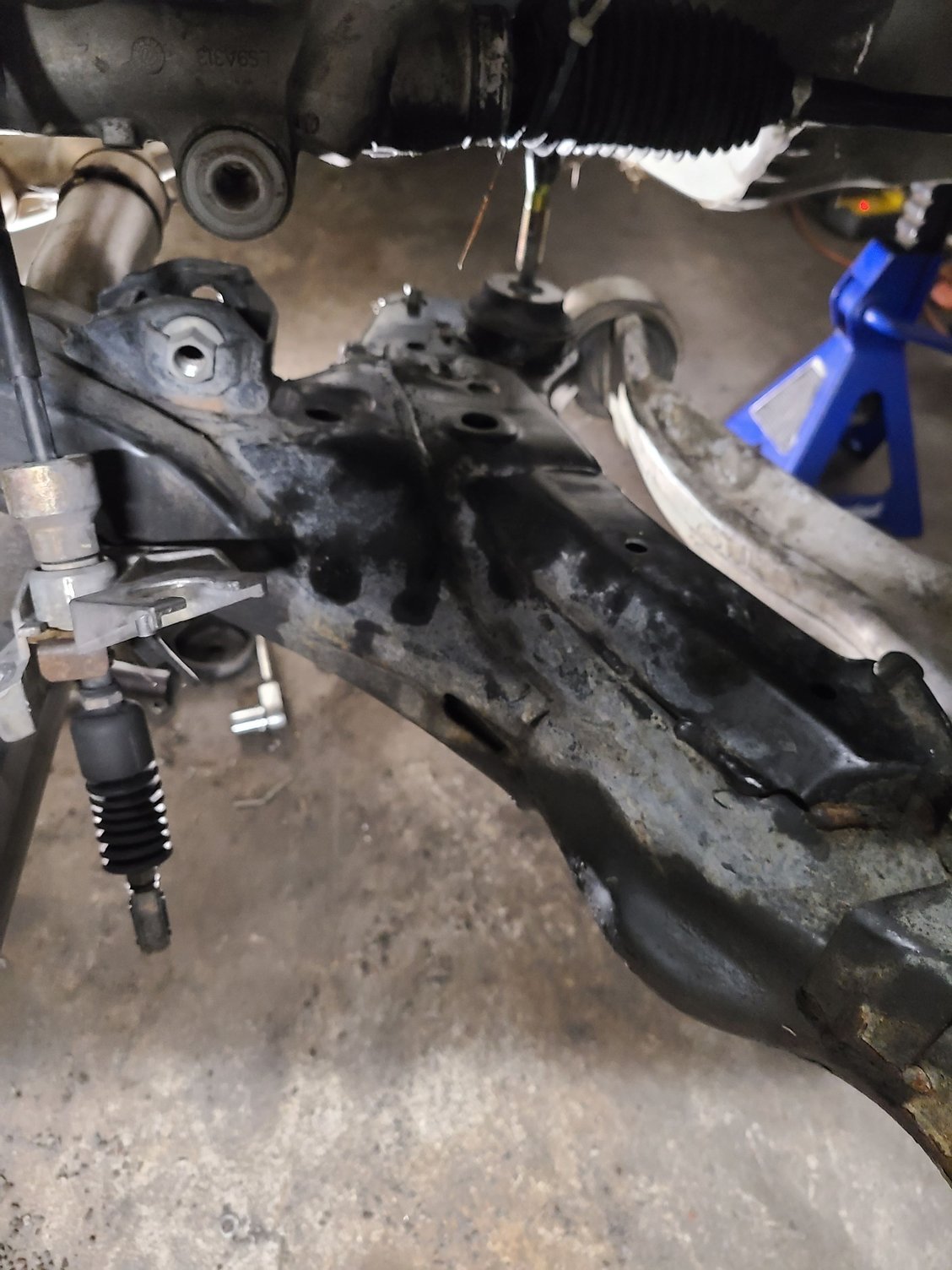

Then i had to partially drop the crossmember to get my Altima SE-R front sway bar in...
Comparison photos of the SE-R sway bar vs the factory 08 Maxima SE.
Not too many options when it comes to bushings here.... going to have to order some plane old autozone bushings.

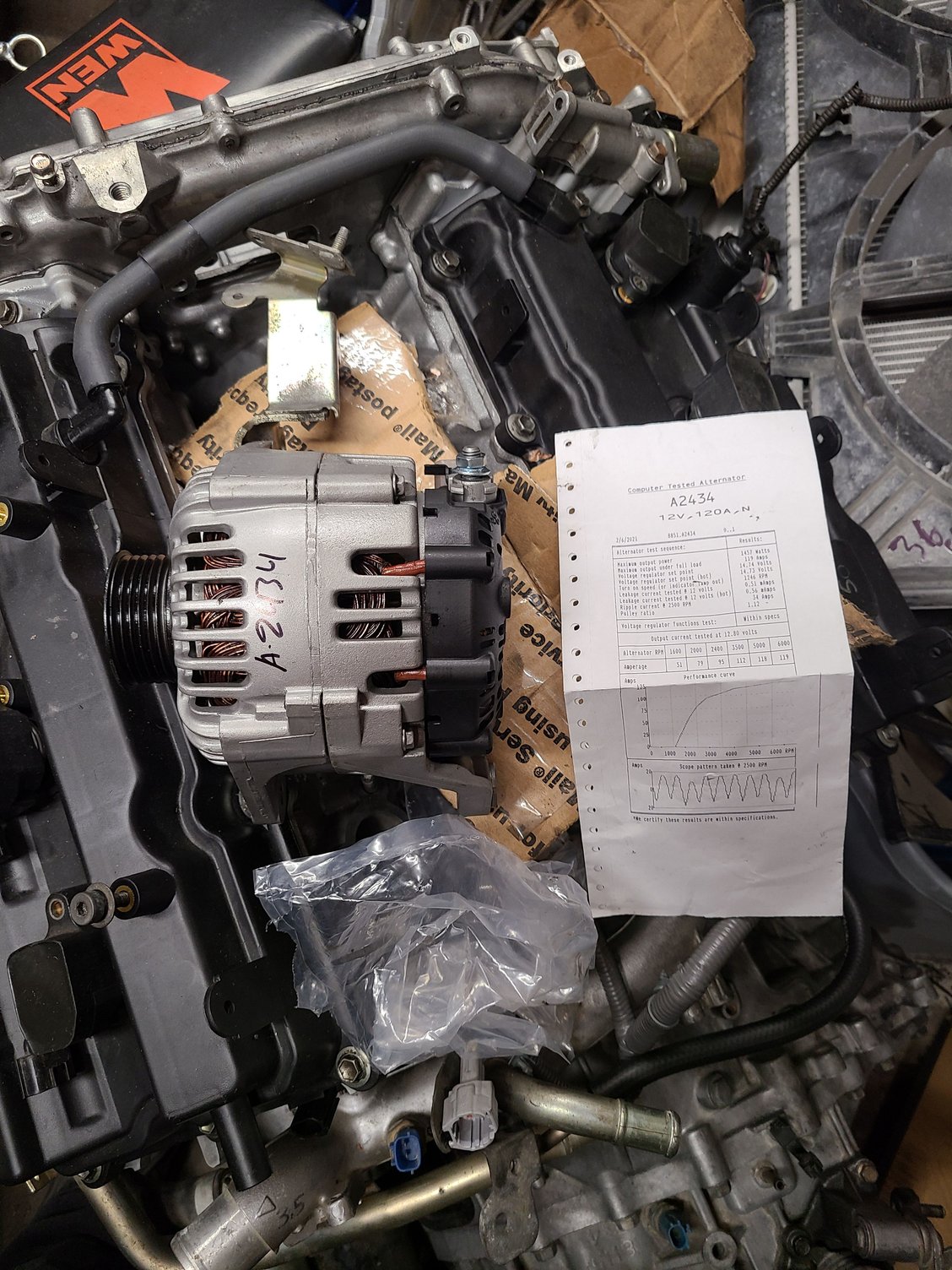

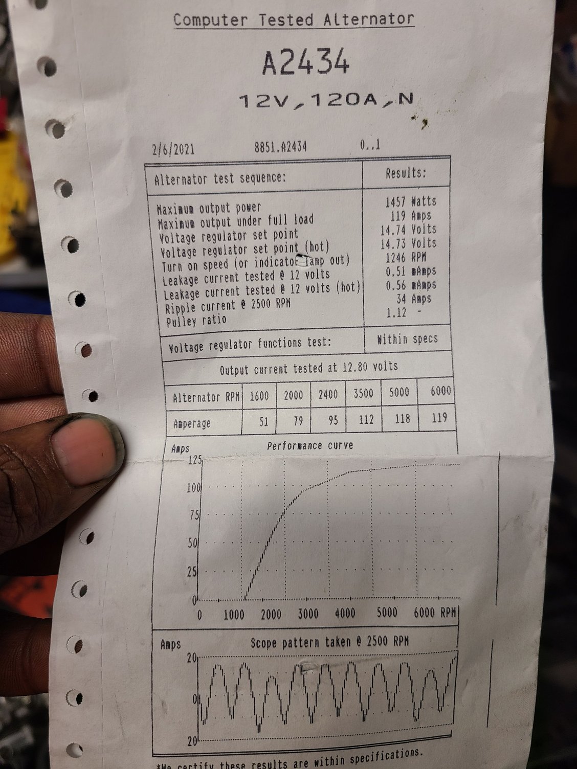

Got the original alternator rebuilt, came with this cool little sheet.
Coulda swore these things were 130a.... but meh....

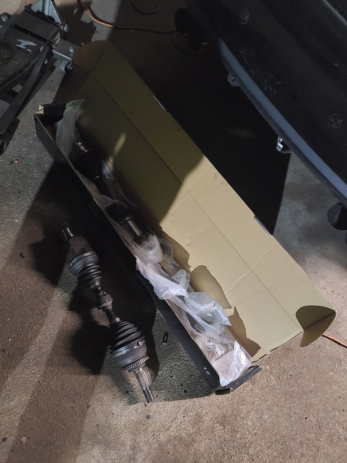

Flex fuel sensor kit ordered, aem fuel pump on the way, gtr injectors are already here..... getting a new passenger side axle (carrier bearing is shot, how bow dah), new boot on the driver side.... Uhhh i think thats it... I'm really trying to have this thing running this weekend.

Mini update, I am finally at a point now to make some real progress.... aka putting the powertrain in...
-Axles ready to go in

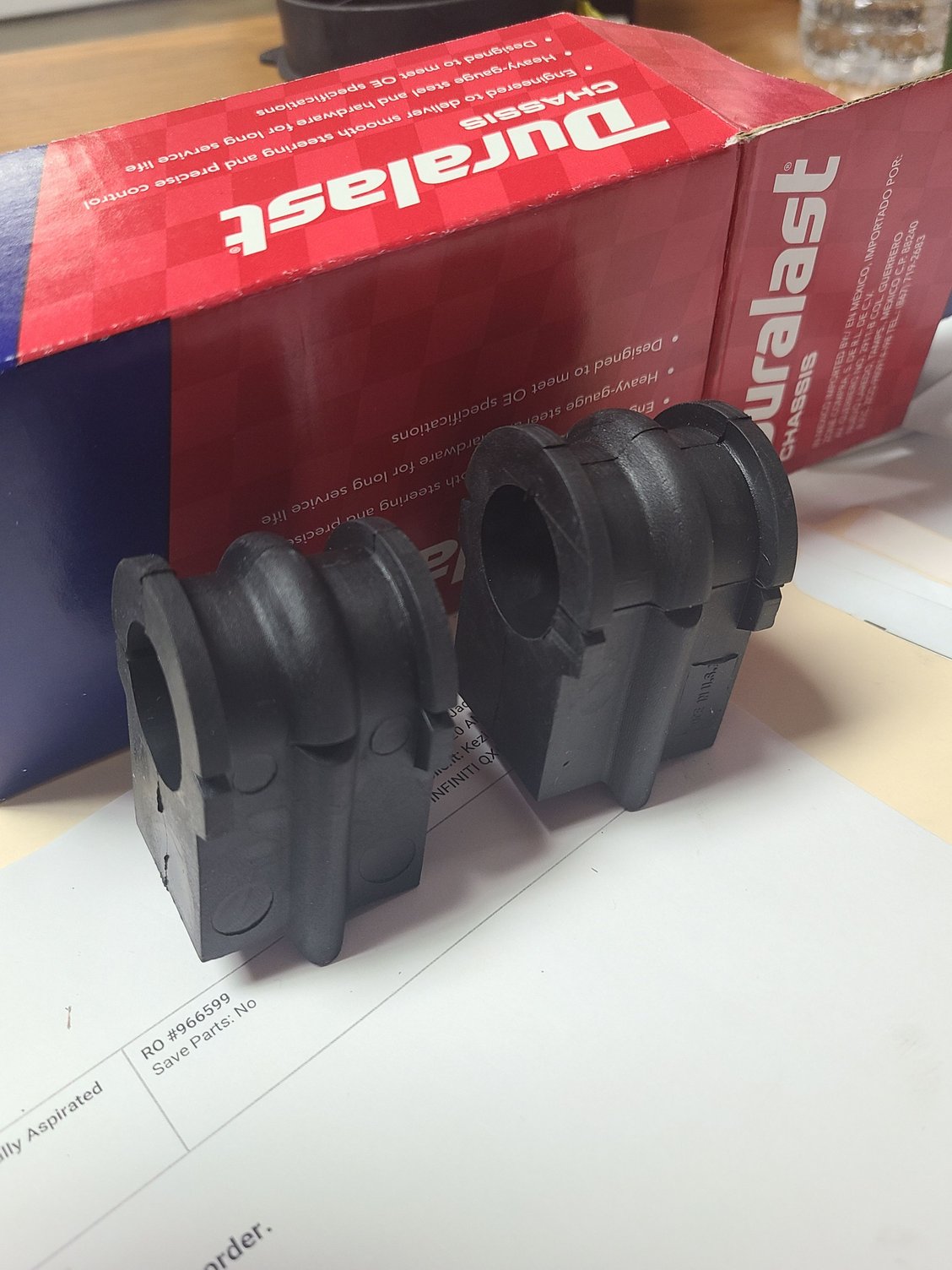

- Front sway bar bushings finally came in... fun fact moog has discontinued the se-r bushings, and your options are very slim..... no fear! These are Thermoplastic (very stiff non rubber) bushings, i have no idea how they will like heat but i guess we will find out... Nissan has superceded the part #s to all be the same for altimas now. So going to the dealer isnt an option either.

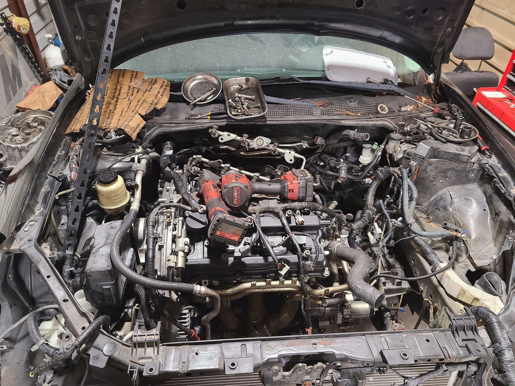

Soooo here we are at first start eve.
Just some random photos taken along the way.

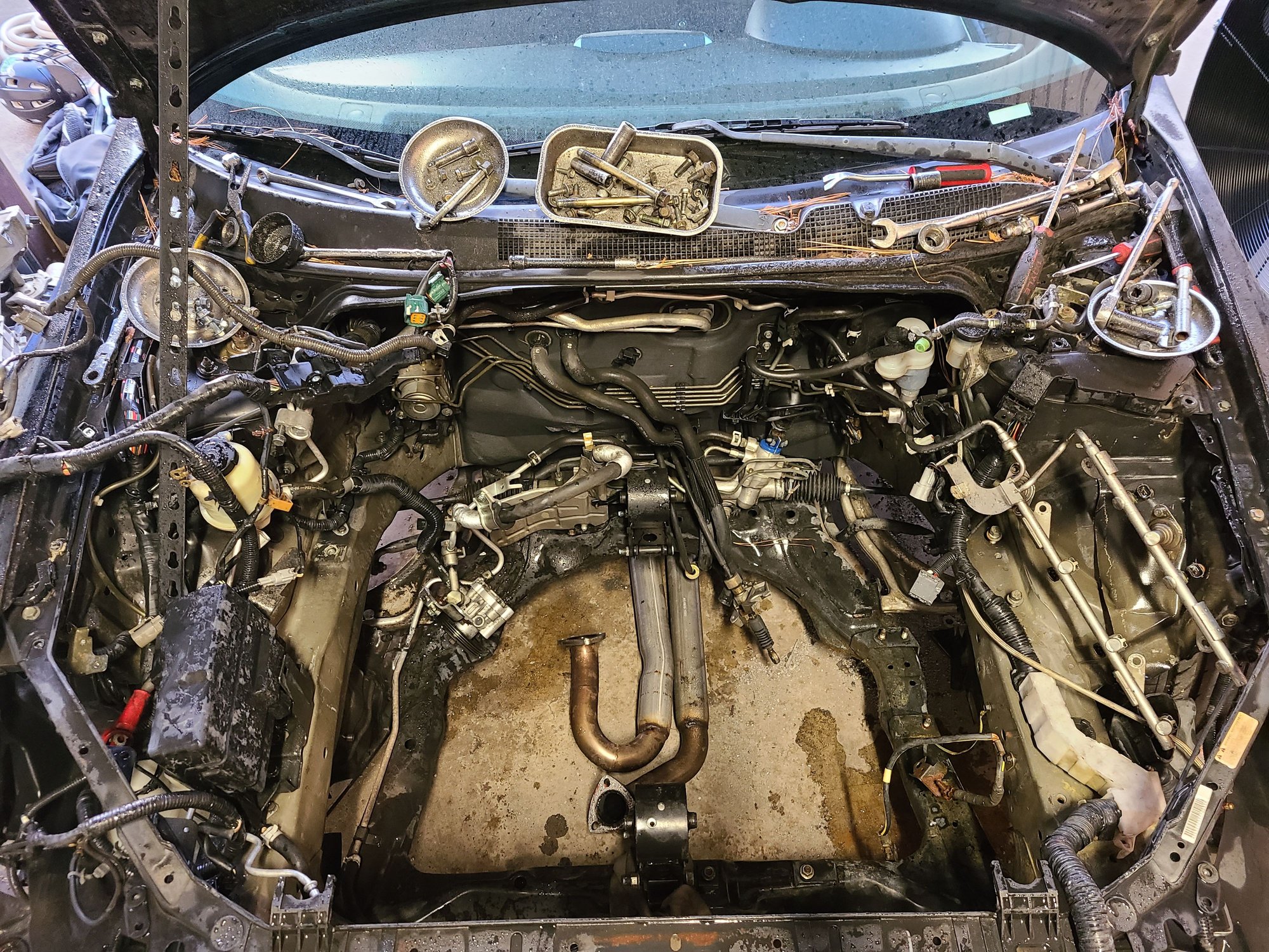

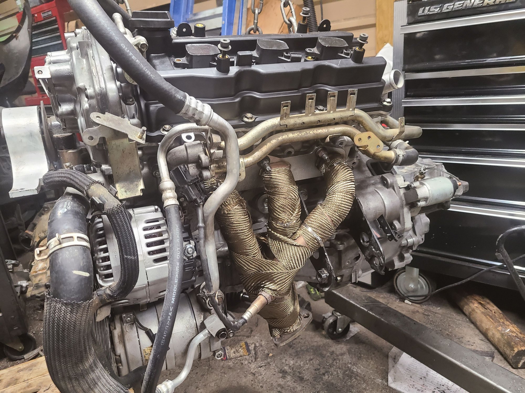

-here is my 2nd attempt at wrapping headers and YES it is trash. Nothing to be proud of, just uploading this photo so one day i can look at it and be like damn that was trash.
-last photo i have beforeeee.......
-Huzzah motor is in! I have a bunch of small things to take care of that i forgot but we are getting there!

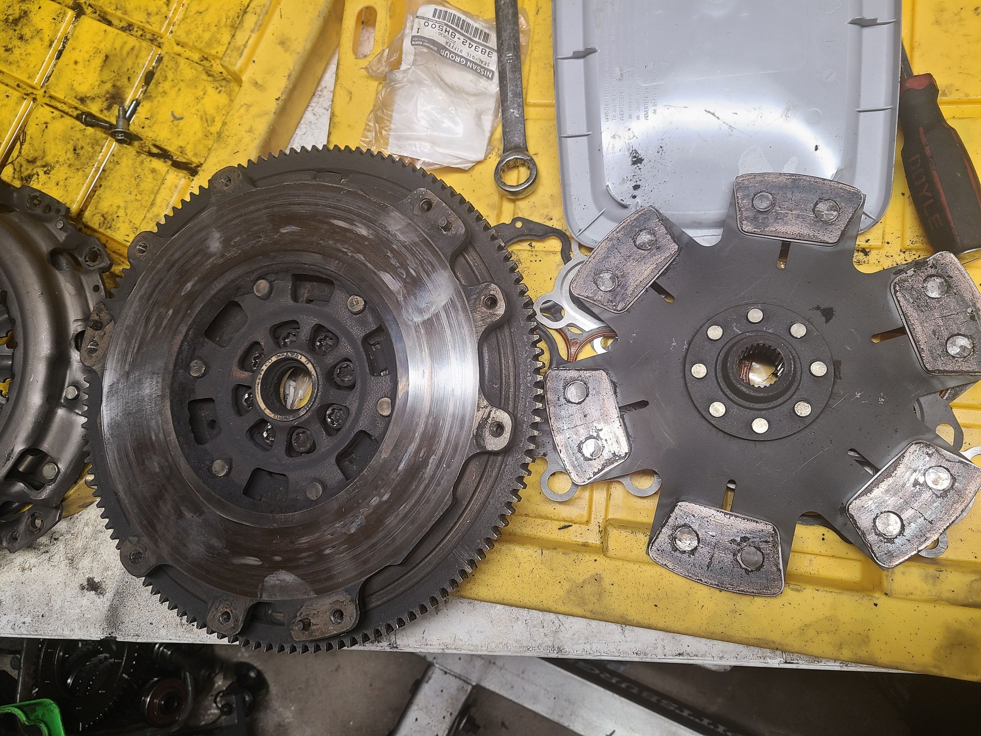

soooo this car made a howling/wookie/electric train braking noise when the clutch was being slipped.
The powers that be had this installed....
I really think the flywheel has waaaayyy too much play in it and its done for and when it was at its limit of slip engagement... it was making a howling noise because of the extra distance it was moving? Maybe? Idc, all i can say is don't ever do this on a stock dual mass flywheel.

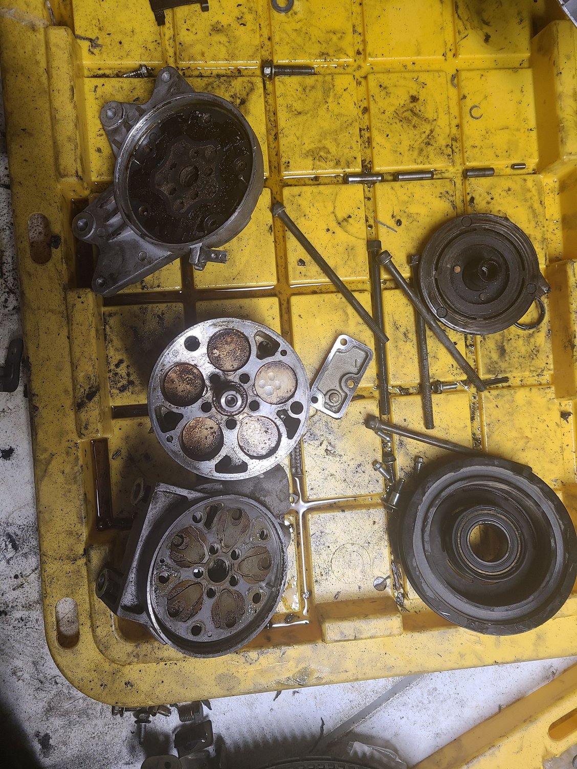

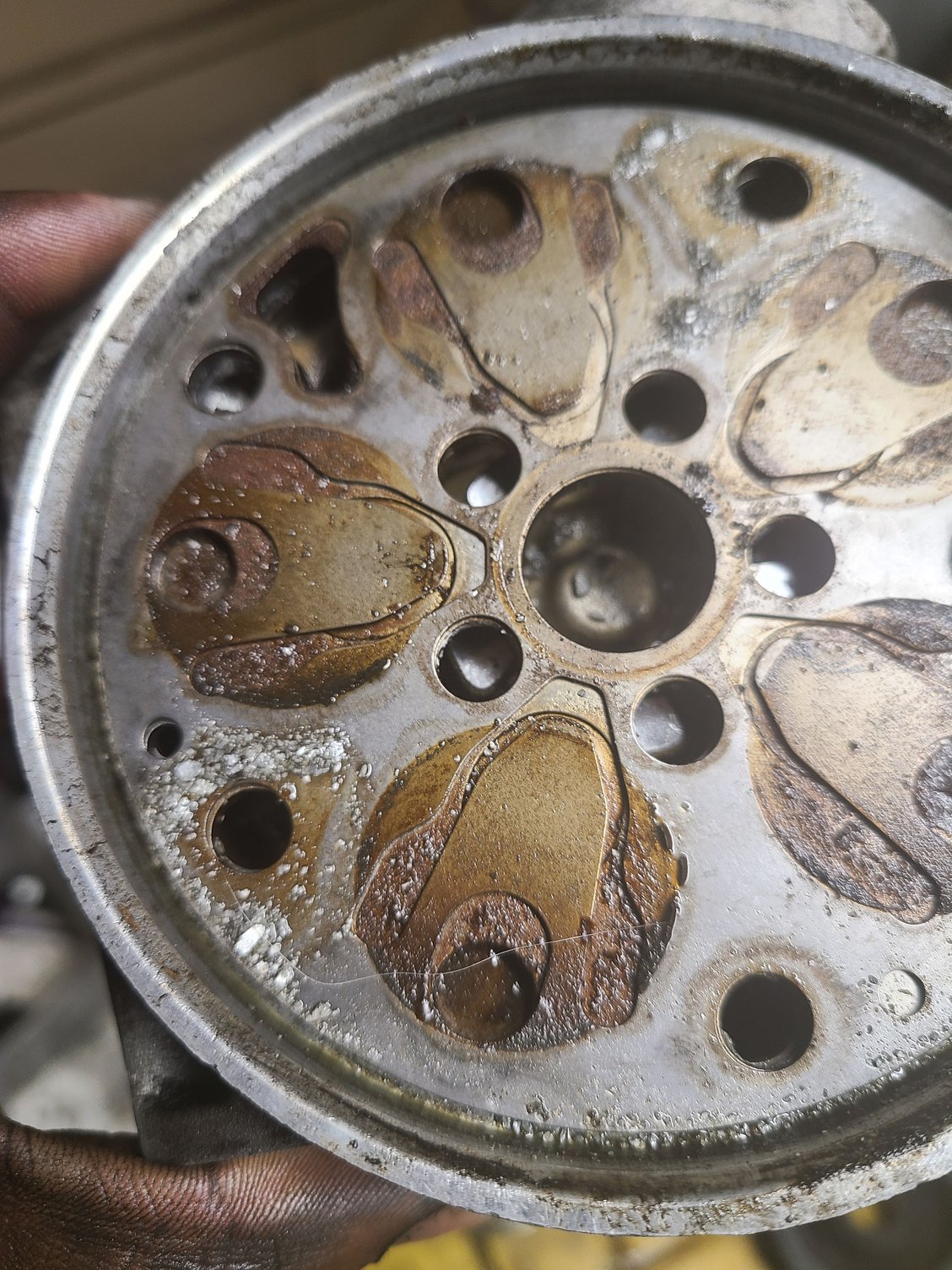

I almost installed a seized ac compressor on the car, here are some pics inside.
