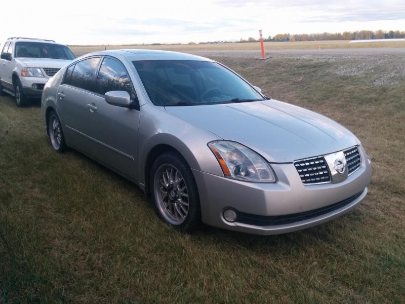

Sup everyone? Thought I'd introduce myself here. I'm From Calgary, Alberta, Canada, and i just bought a very used 2004 Maxima SL. It has 350,700km or 217,900 miles on it. Previous owner said almost all mileage was highway and maintenance/fluids done every 10k. Not many issues so far, it's still in great shape cosmetic wise, minus a few scrapes here and there. The car seems to run strong and the transmission is smooth. But, when you start the car after the initial time in the morning, it takes about 2-3 seconds to fire, and will sometimes bog around 500 rpm before kicking up to 750~. Also, while stopped at red lights, or in traffic, it will bog a bit and buck slightly, which bothers me. A friend said i should inspect the catalytic converter for clogging, but i also think if i can adjust my idle to 1000rpm, it may resolve the problem. Any thoughts?
