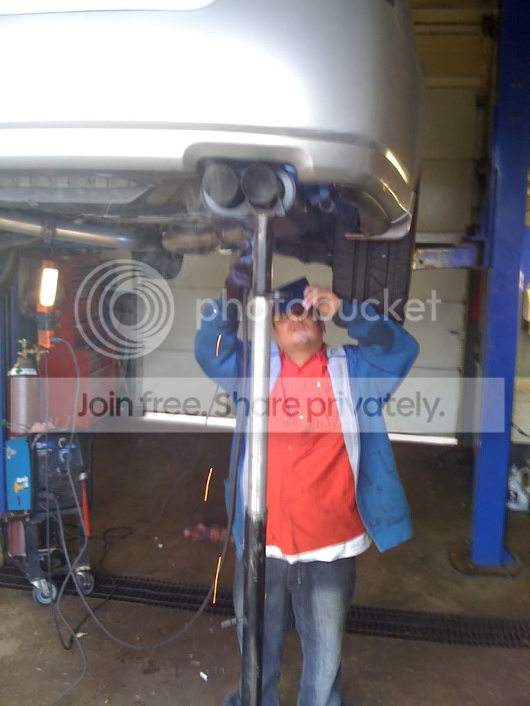

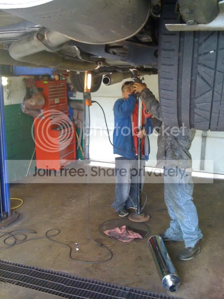

Anyway, some random pics
He had one up on the wall for display:
After Nismo removed took a couple of random pics

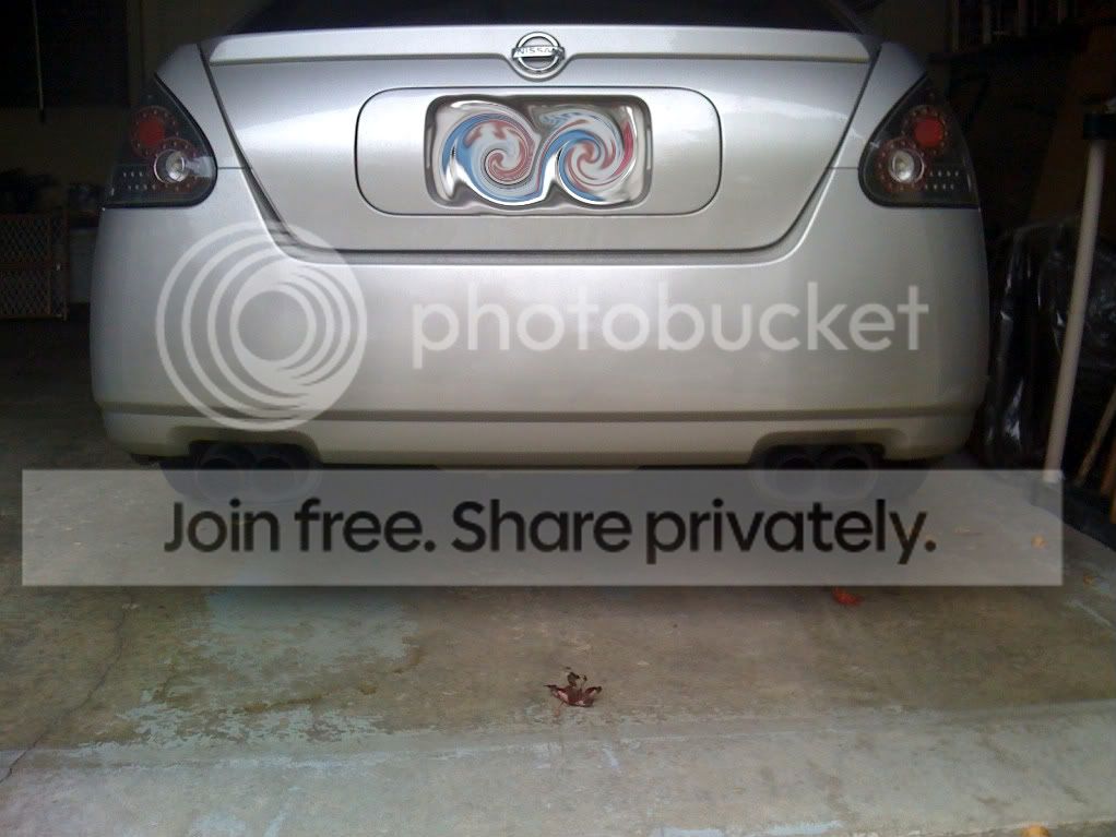

As posted at the "other" site... Rasp is totally gone now:

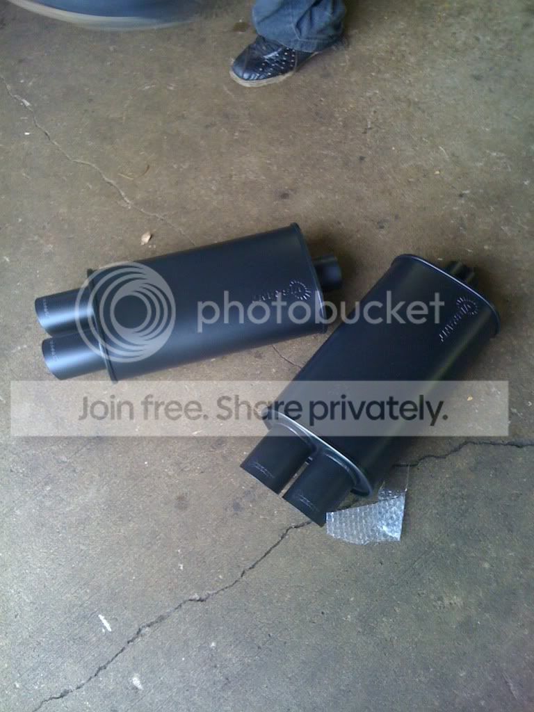

Ok, so Nick at THMotorsports.com (shameless plug) finally got all my stuff in today... they had the Vibrants since Friday but I wanted to pick up everything together.
On my way home I stopped by a local muffler shop and got everything installed. It's PERFECT now!
Forgot to take a pic of the Magnaflow resonator, but everyone has seen those. lol It's huge, but fits, and works great!
I'll get a video sometime soon.
Too lazy to resize, but you all have broadband, so
Vibrant 1148:

Muffler going on:
Here it is, at home in the garage:
I should have done this years ago. I absolutely love it. lol
Looks hot, and there's no more rasp! The Vibrants give a very deep rich tone coming out the back.
I'll get better pics of the car with an actual camera, and when it's not so overcast out.
