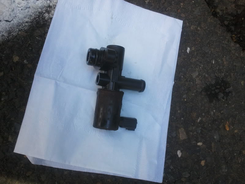

However im starting to think my EVAP canister vent control valve is busted as its rusted on the bottom. Pics will follow once i get this thing out...
So i finally got it out bouy was this thing rusted in. but with plenty of wd40 i got it out.
So what do you boys think would this valve cause a P1440 ? Its the only code im getting.
I can put a flathead screwdriver in it and it just barely goes does a centimeter, I dont know how far its supposed to open and close.
Is there a way to test it with a multimeter or something ?

The valve has been back in for a while,but it turns out my car doesn't like aftermarket gas caps (Stant) so after I fixed the rusty valve I still had the CEL.
Put the old oem cap back on and the CEL cleared itself out within a few days.
Aftermarket Gas caps dont seem to work guys !
