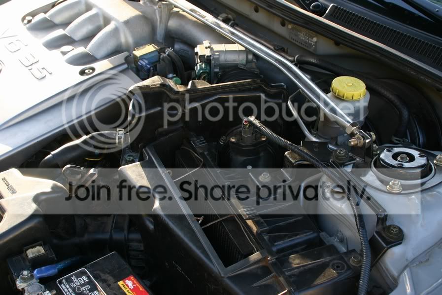

Pictures after the install. I regret not taking pictures of the install process. I forgot my camera at my apartment that day. So here they are, the result of the "invisible" install.

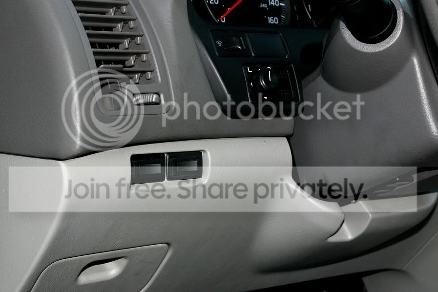

ZEX switch (left) and DR mod switch (right):

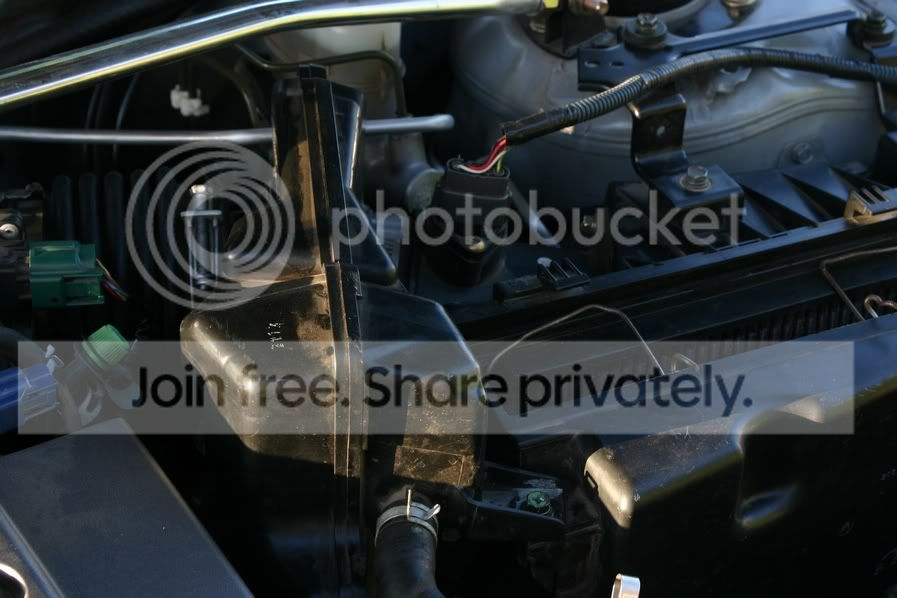

View of the intake box from the front:
Another view of the intake box (GAB):
The TPS wire is tapped via the ECU wiring btw. The "microswitch" is tapped into the "MODE" button on the steering wheel. Now pressing "MODE" doesn't just change the radio to CD source anymore! I use the switch because I don't want it to spray in between shifts.

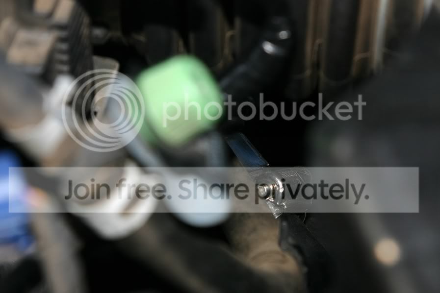

Close-up of the nozzle. Hard to see and focus on, even in direct sunlight:

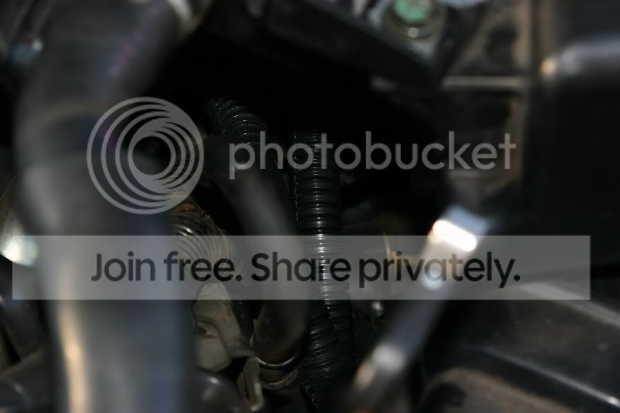

T-tap into the soft fuel line; leads to fpr. Hidden underneath the TB region/coupler:

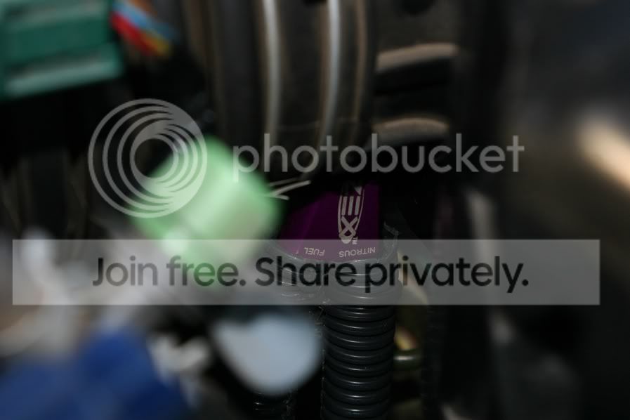

All the wiring and lines were hidden in wire loom. The 16' line from the bottle to ZEX box was run along the kick panel of the car. A picture of the fuel and nitrous feed line from the ZEX solenoid box (hidden underneath the intake box):
