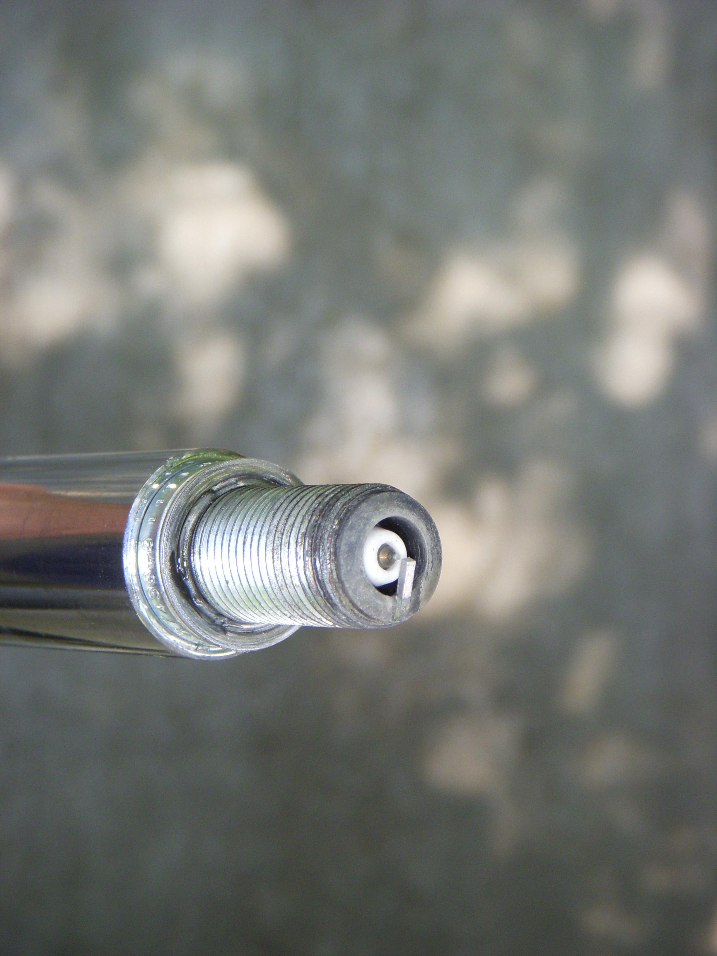

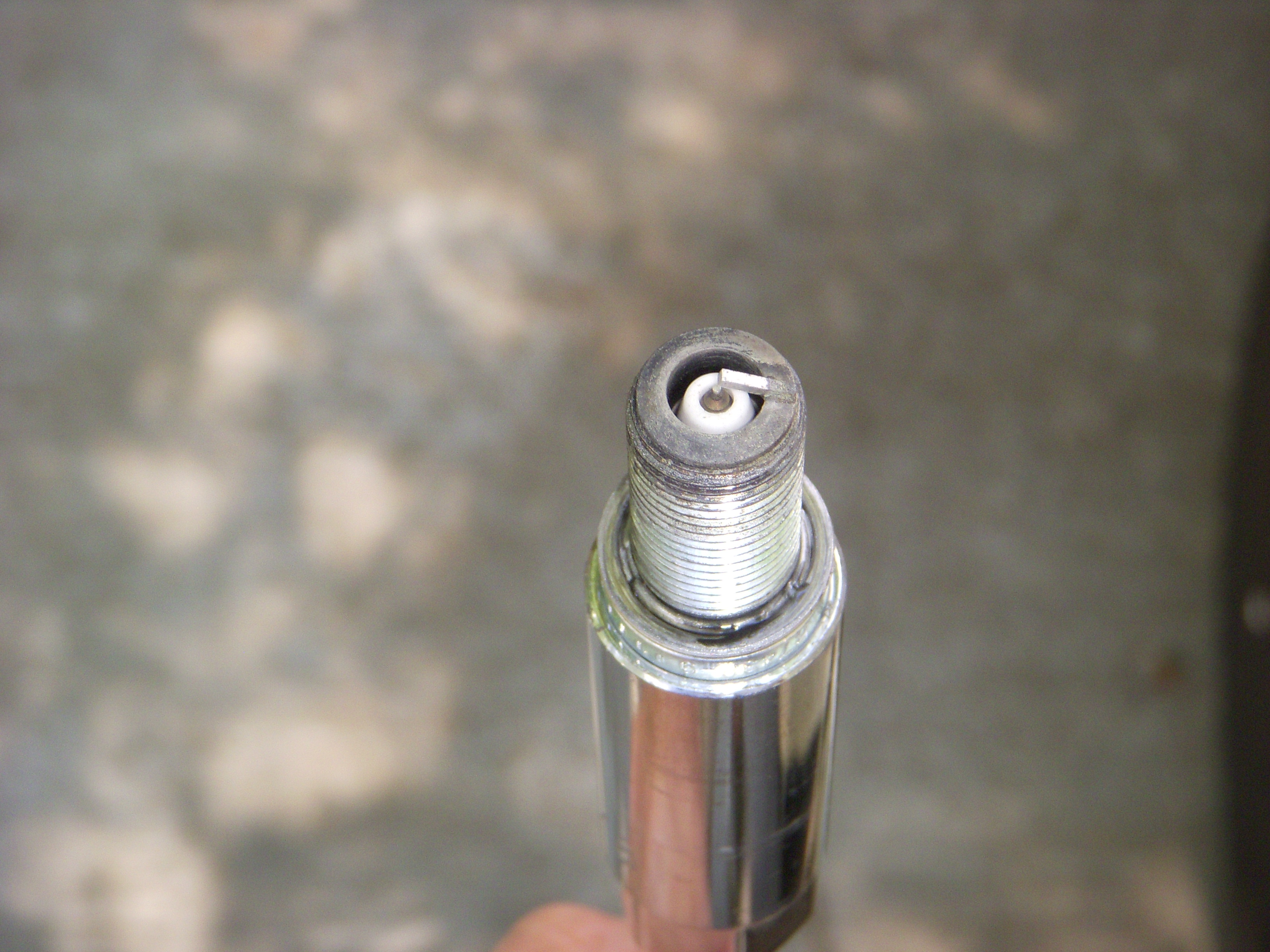

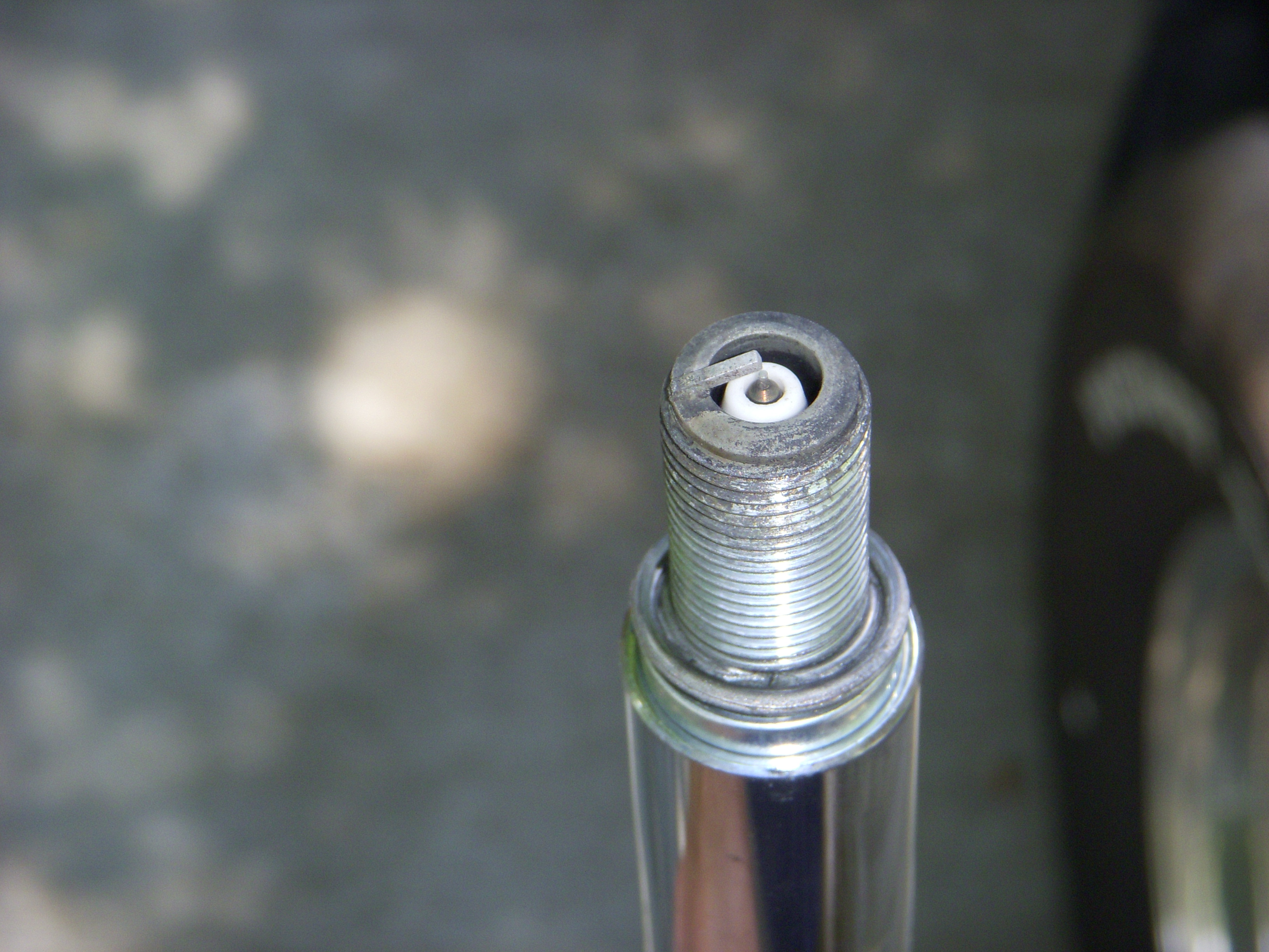

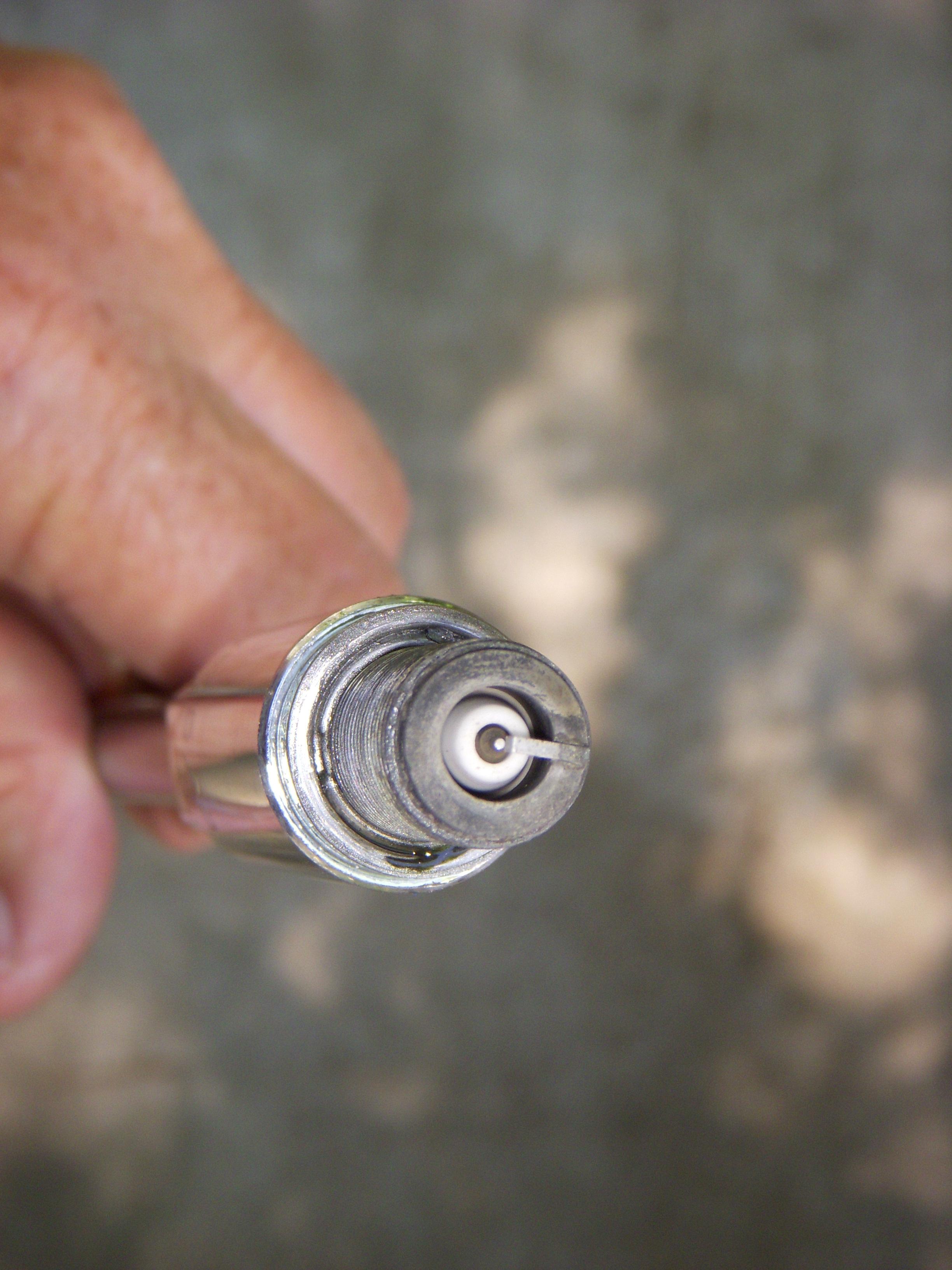

-9 NGK plugs
I pulled race plugs yesterday, and I'm pleased with how they look. The porcelain is white, of course because E85, but all ground electrodes have a clearly defined fire ring about 2/3 of the way back to the plug shell, and that is good. These plugs have been sprayed with both stages, a 75-shot and 150-shot, and seemed to have survived OK.
Next step, if rains don't happen today, is to put a little nitrous time on the car today.

Those plugs look great! Time to throw some more giggle juice at it haha

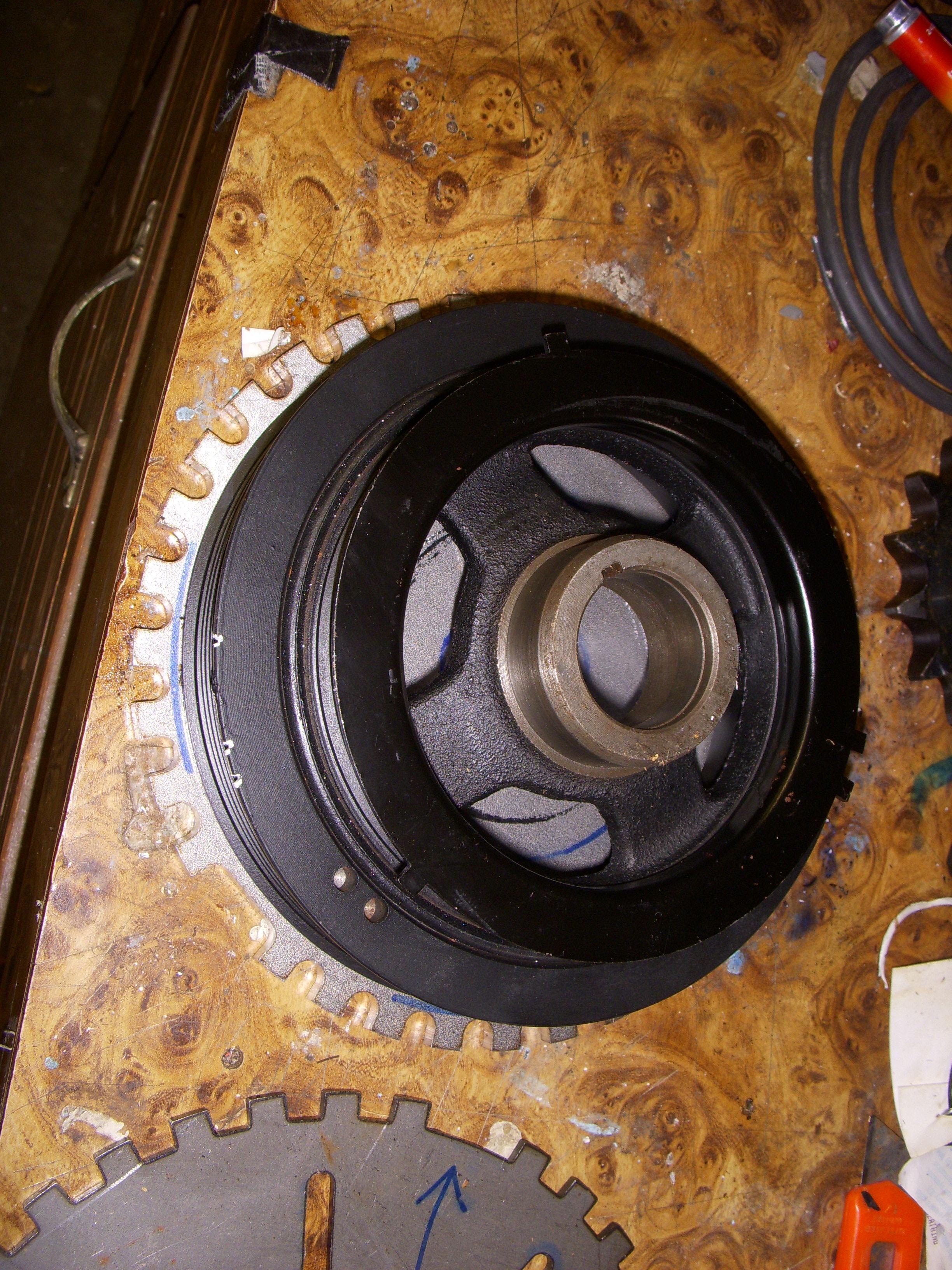

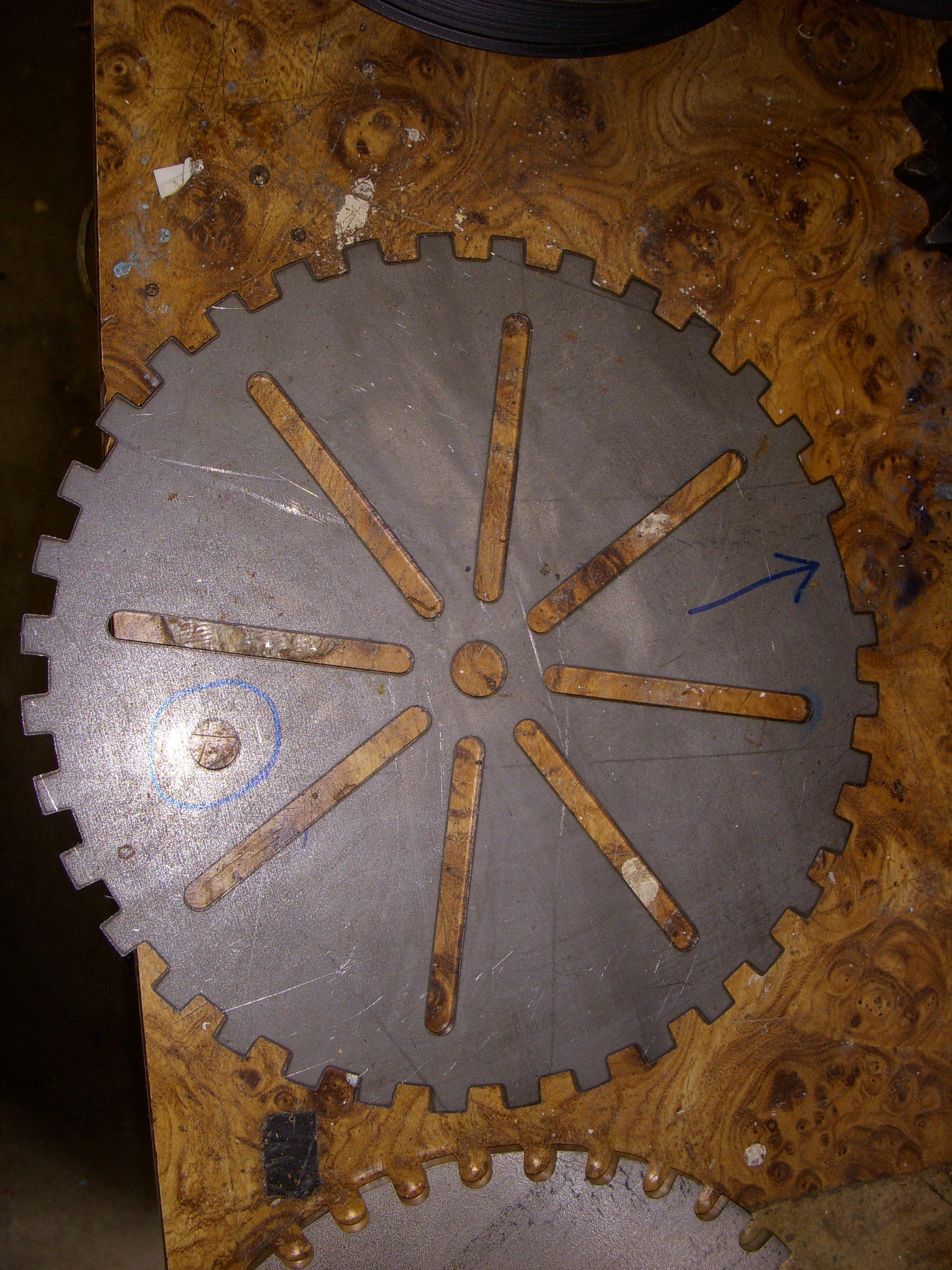

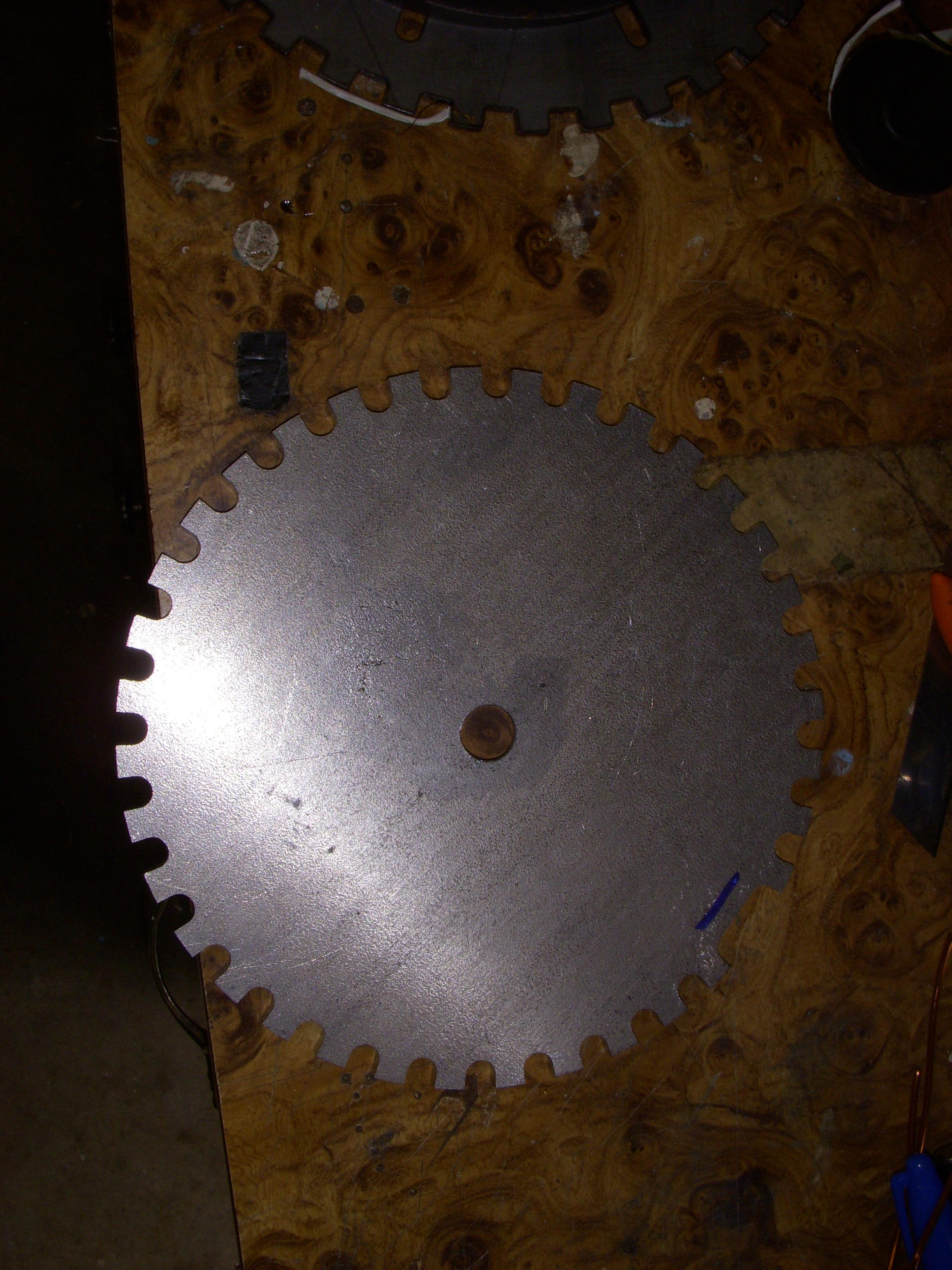

I just came in from eyeballing trigger wheels and crankshaft pulleys, and I noticed that the larger one (8 1/2") was too large - it would grind off the end of the oil filter! The 7 inch 36-1 wheel will clear the filter and the outside of the pulley just enough to leave the teeth exposed for the Hall switch. Back to the drawing board...

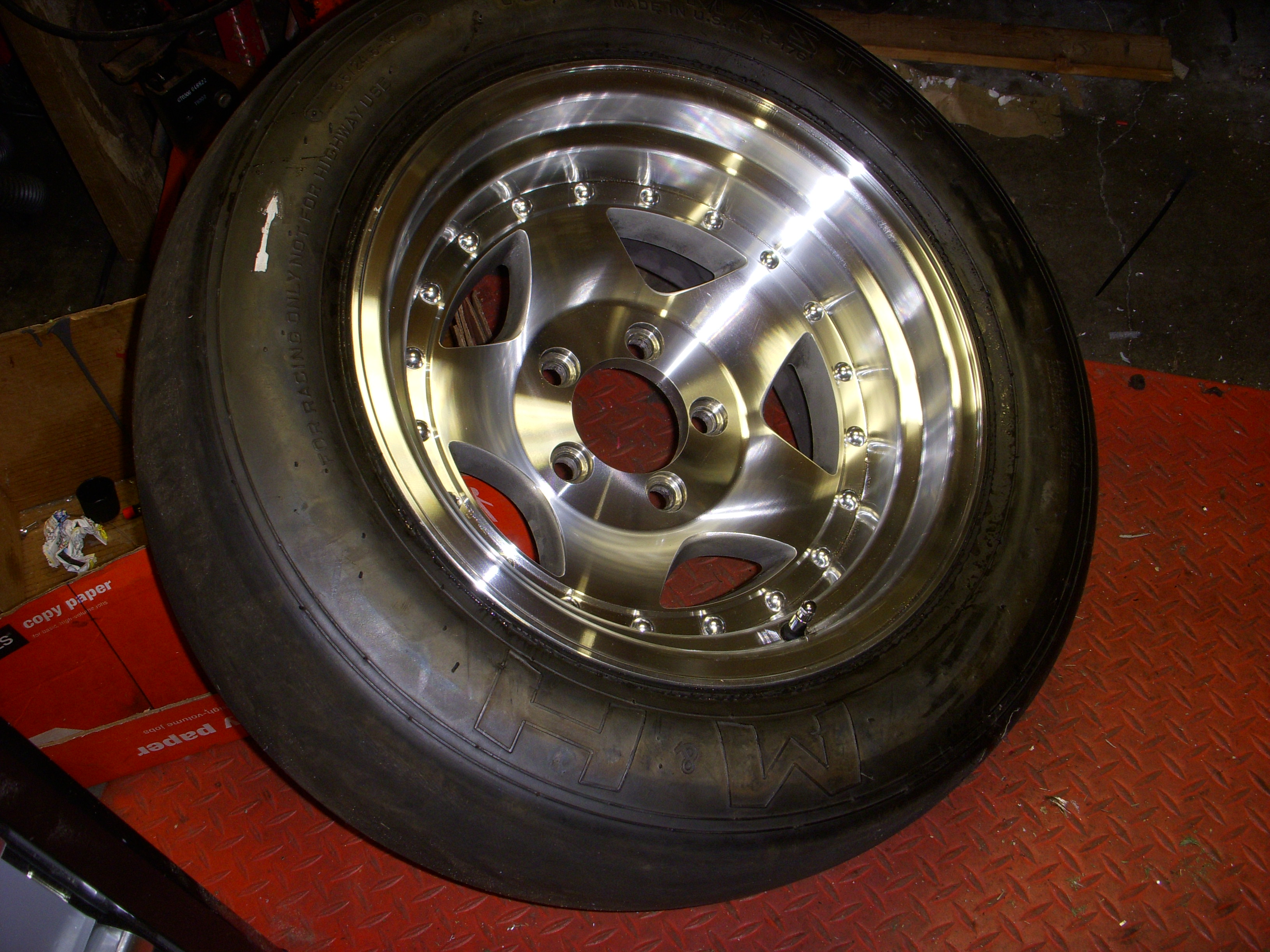

M&H 24.5x15x8.5" slick mounted on American Racing AR23 - 34 lbs each. Also have a pair of 23x15.8.5" M&Hs...

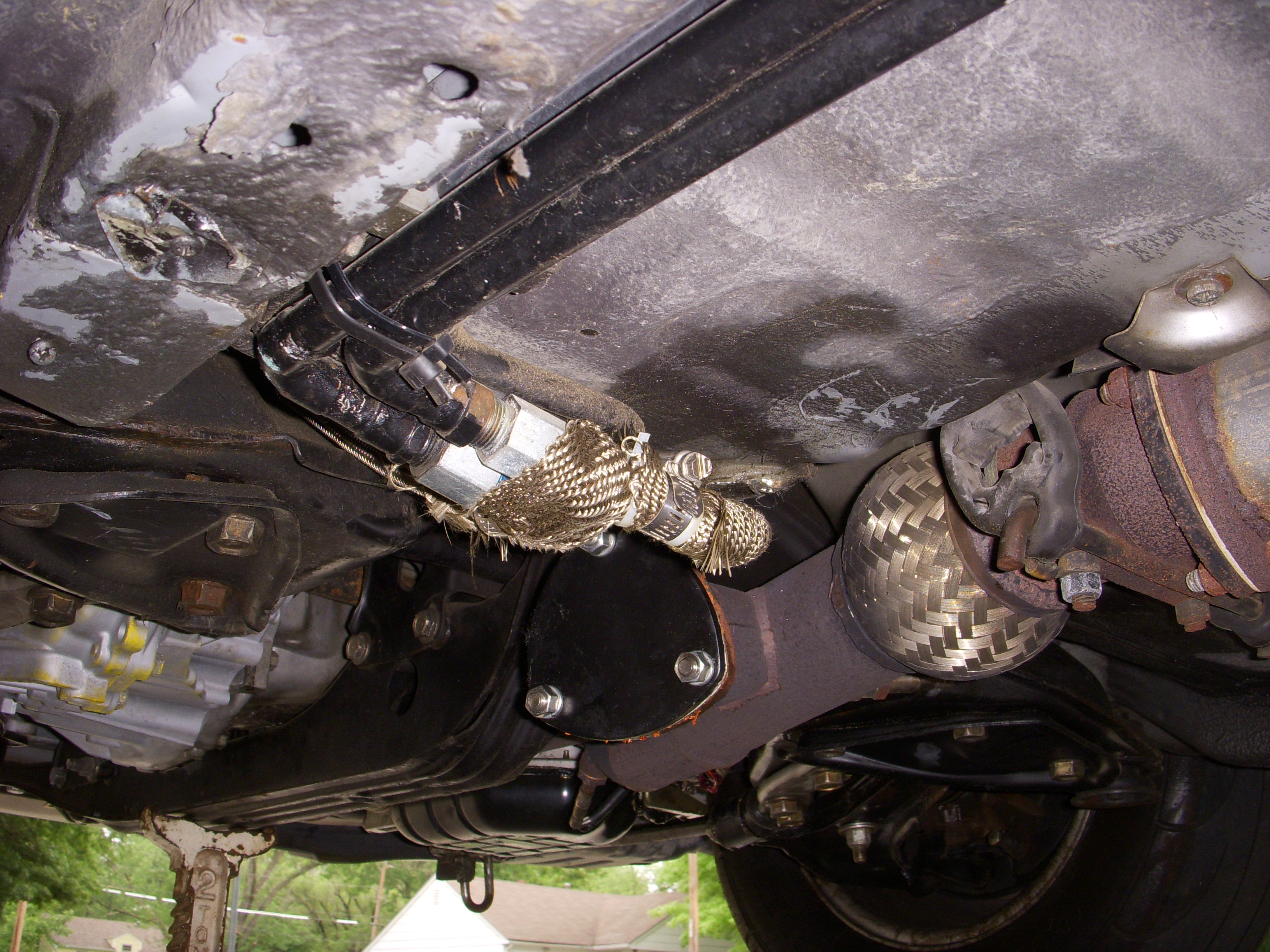

3" header cutout + insulated E85 lines. I still need to figure out a way to open the headers and NOT melt the E85 lines...

Trigger wheel - 6 1/2" dia, 36-1 teeth.

Same trigger wheel underneath stock pulley.

8" trigger wheel 36-1 , too big to clear oil filter.
[Name:  DSCN3484_zps9c600596.jpg

I think I'm going to need to make a visit to a competent machinist to deal with the trigger wheel thingie. I would like to have positioning tabs made on the inside face of the trigger wheel, so that I can drill holes in the wheel, place it against the face of the pulley so it centers, set the rotation so that the tooth gap is six teeth ahead of the 0* timing mark, then MIG-weld it into place. This way I don't need to take off the existing OEM pulley and still make this work. And, so can anyone else.
I've tried all sorts of combinations of custom spacer plates and drilling of holes, but I don't have the tools for all this. Holding up a premade trigger wheel with locating tabs installed and a 1 7/8" hole drilled in the middle to take out the crank bolt (just in case), then spot-welding it into place with a MIG ( or stick welder, if you're better than I am) would be much better. Mount a Cherry Hall-effect sensor just over the trigger wheel and you can connect it to a MS3-Pro engine computer - as soon as I figure out a cam sensor to work with the MS3-Pro....
Well, no one said this would be easy to figure out - but I want it to be easy to duplicate by another Maxima owner. This concept will work with any 3.0 or 3.5L V6. Just gotta figure out the MS3-required cam sensor - one pulse per cam rotation that occurs about 45* crank before the missing 36-1 tooth comes up.

sorry i havent been keeping up but why the trigger wheel?
get the pulley balanced with the welding and added mass
Because Megasquirt:
http://www.diyautotune.com/ms3-pro.html
http://www.diyautotune.com/catalog/t...407538202994c0
With just a GM-standard intake air and water temp sensor, this box can monitor MAF and trigger ignition and fuel injectors under MS3 control. And a whole lot more, as well....
